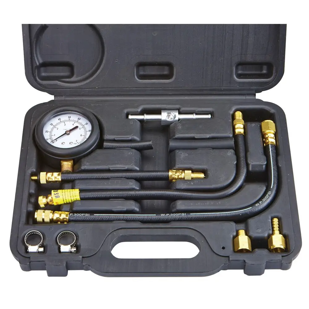

In my experiences the symptoms are always the same, weak performance, more than normal throttle input required, progressing to no power at all, popping on throttle but idling, then rough or barely idling. The best $20 I ever spent was on a Harbor Freight fuel pressure gauge kit that can quickly identify the fuel pump as the problem.
