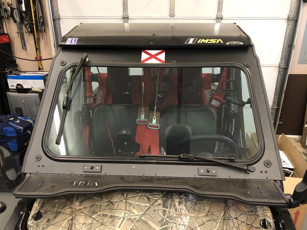

@AustinL911 I went with the sXs windshield here is a link to an article that prompted me to use them. Early photos of their windshield on my machine are on Page 3 Post #45:
P500 - Honda 500 Full Glass Windshield
I think Extreme Metal Products may now also offer a glass windshield, and since you are both located in Ohio, shipping might be less.
As far as sXs,- great people to work with and extremely high quality, and I would highly recommend them. I couldn't be happier especially since the previous linked post I added wipers and a windshield washer system see left photo (two rectangular blocks at bottom of windshield are the jet nozzle holders).

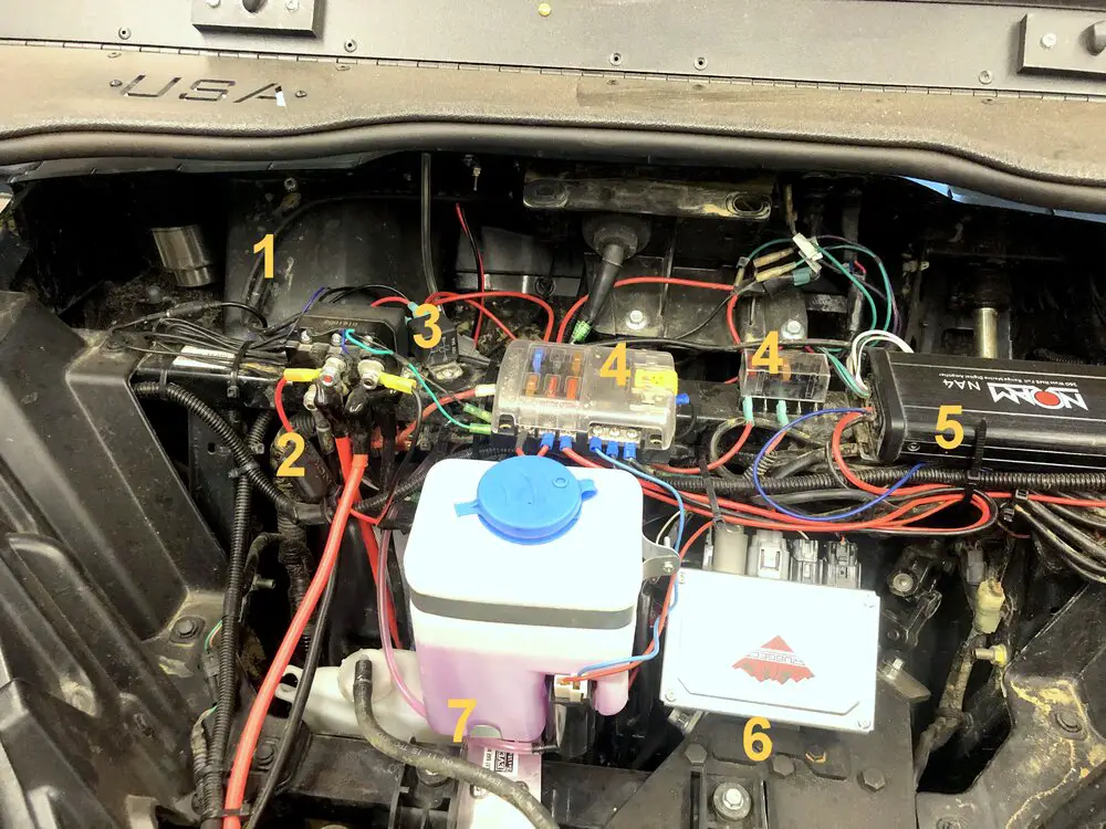

In the left photo, the lower vent is open which allows for air flow, plus in this position you can also remove the hood.
The right photo is an under hood look (before I tidied up the wiring and a list of some things you can fit under the little P5 hood:
1 – Back of Choog Box (glovebox)
2 – Winch Solenoid
3 – Relay for Light bar
4 – Fuse Boxes
5 – NOAM Stereo Amp
6 – Electric Power Steering
7 – Windshield Washer Reservoir and Pump (do not use unless you have a glass windshield)

Thanks for the post! Looks awesome. Now I've got another option to consider. No problems with rocks busting or chipping it?

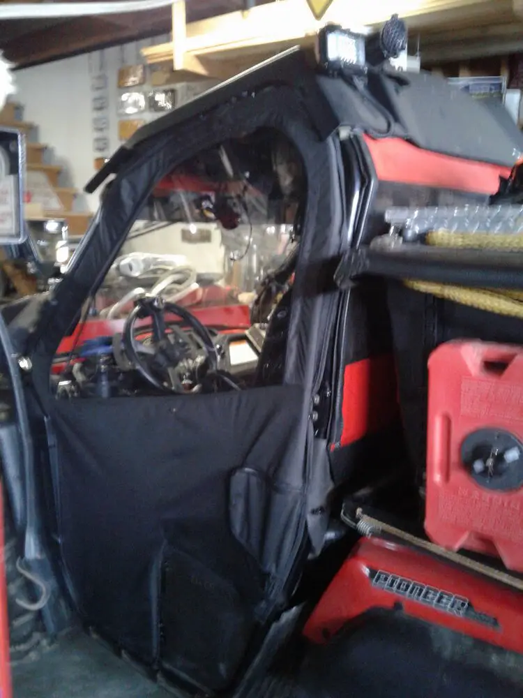

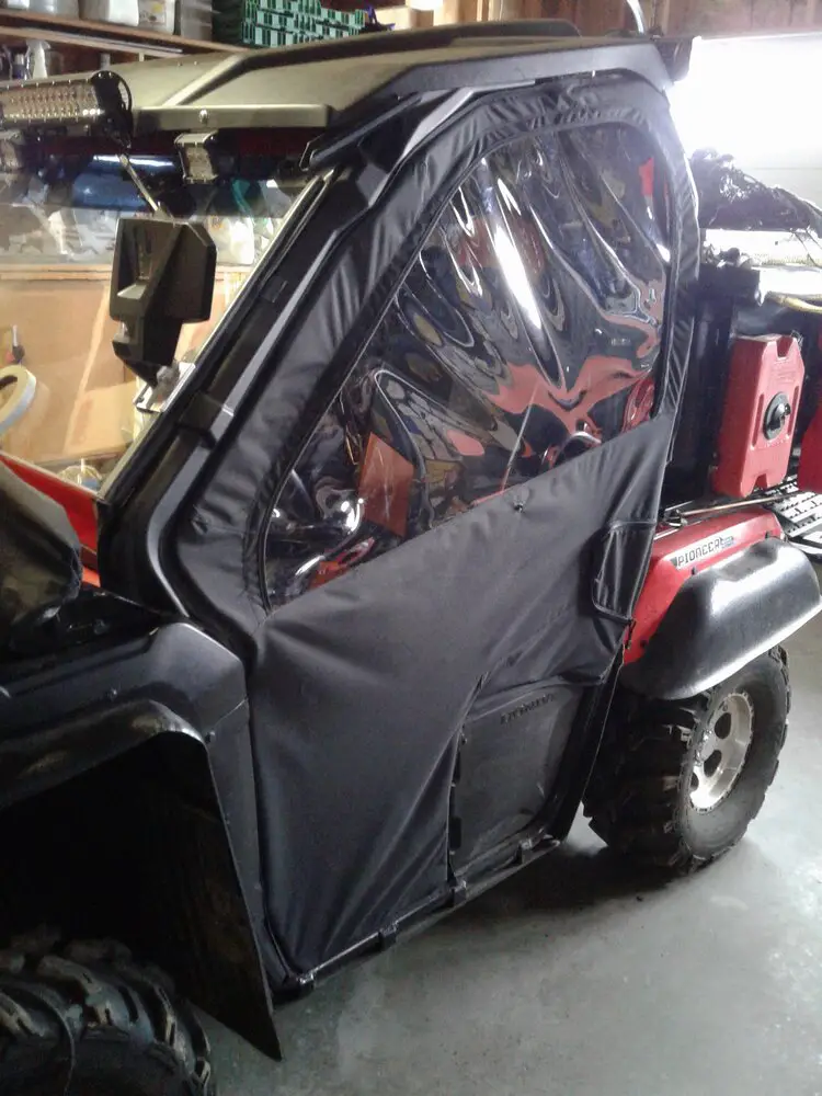

Using same Roof & Windshield & ( Hard Kolpin Rear Panel required more effort to seal & hold heat. )

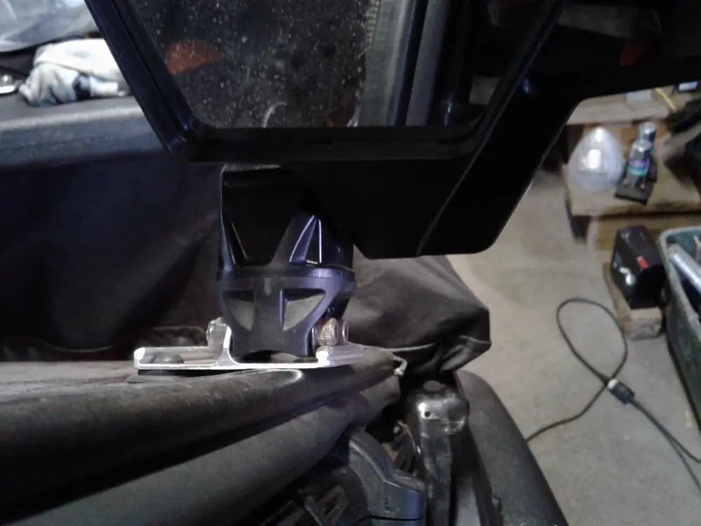

Kolpin Mirrors --- with Modified Mounting to the Windshield Tilt Bracket ( Mirrors Tilt With the Windshield ) see attached pictures.

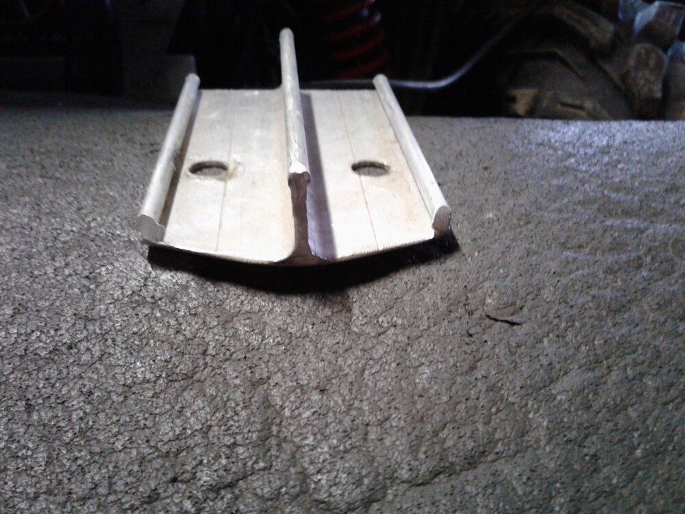

With P520 doors -- Mirrors NOT Easily attached to Roll Cage ( included picture aluminum used to make mirror mount ) could be duplicated with 2 pieces alum. angle.
This moved the Mirrors up & in. Now have a partial view through windshield. ( poor vision trough Wavy Door Plastic Windows )
I installed a Recording Camera with Ft. & Rear Vewing.
View attachment 255146 View attachment 255147 View attachment 255148 View attachment 255149 View attachment 255151
So far no chips, I transport in an enclosed trailer, if you transport in an open trailer I think sXs offers a windshield cover for transport.
Since the windshield is flat DOT glass, if a bad crack happens you should be able to have your local glass company provide a new replacement glass.
