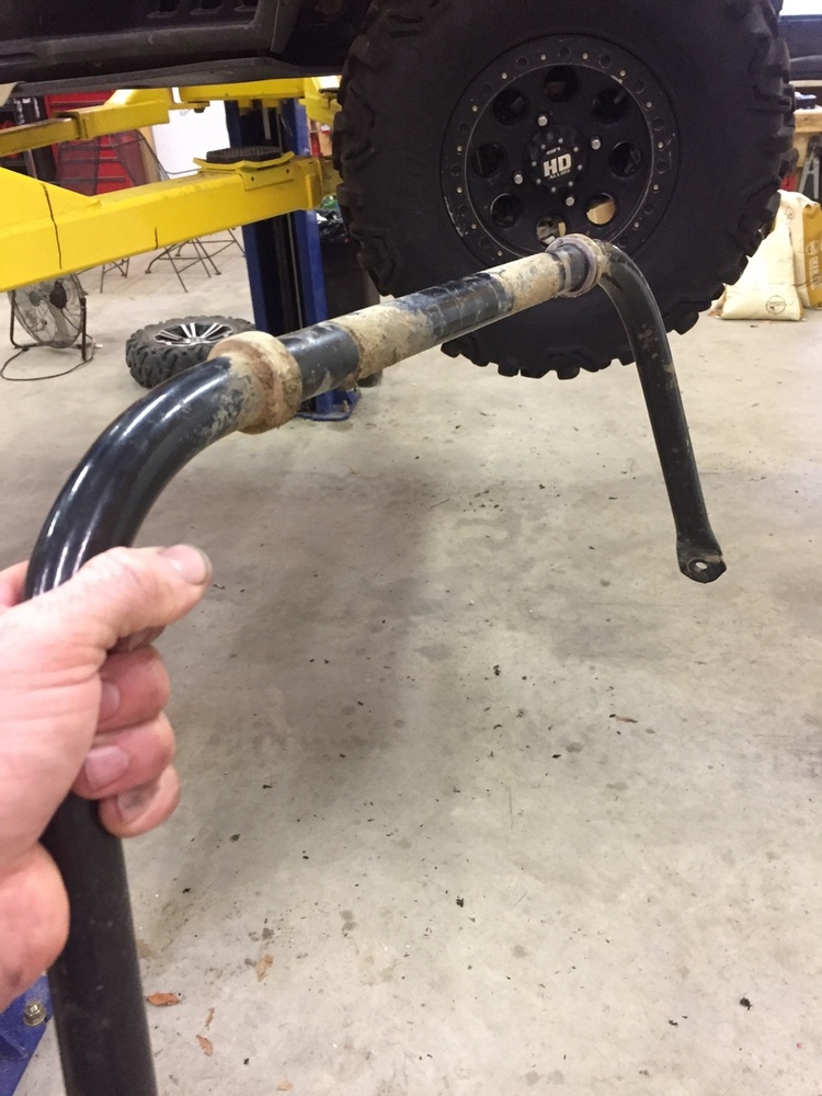

I took the sway bar off of my pioneer 700 and loved it. I've been a little bit afraid to on this pioneer 1000 because it feels like it sways a little more in the turns. However, I put a lot of faith in my BIH (Brothers in Honda).
It was recommended that I just disconnect it and tie the bar out-of-the-way, but I don't want to do anything half a$$. It actually wasn't hard to remove and who knows, I may want to put it back on. I only need to remove two tires and one shock to get it out.
I'm about to go take a little booze cruise and see how I like it. If y'all don't hear from me by tomorrow sometime, send a search team looking for a pioneer turned over on its side.
Well the little 500 has body roll like a mutha and I'm still upright! May the Honda wings be with you and the odds forever in your favor!
39,130
There's no way I could give a good in-depth review making such a short little run. But, I did make the same run that I did when I took the video of the Walker Evans shocks. So, from that short run, I took away several notes:
1: the rear end doesn't get so agitated over the rough stuff and stays planted better. Still not as good as the front with the W/E shocks though.
2: it does sway more but it's very similar to the P700. I can feel the body roll but the tires stay planted pretty good. It should be great for my type of trail riding.
3: if carrying passengers or a heavy load in the back, it may be a good idea to leave it on if it behaves like the P700 with the sway bar removed. I'm sure an extra 300-400 pounds in the back will decrease stability more so with it removed.
4: I tried some G-outs in the field (in turf mode) and it will spin the inside tire a lot easier than before so that tells me that the sway bar was helping keep the inside wheels planted better.
5: no booze was spilled during the making of this review.

One other thing, I actually stopped and checked my drivers side rear tire, I could have sworn it was flat.....nope, that just how it feels when you turn sharp at high speed. If feels like a tire is rolling under the wheel.
I will leave it off for the Bull Run ride this weekend and compare how it does on the treacherous "loop". Also at that time, I'll have a cooler, my tool and recovery kit, chainsaw, roto-packs, spare tire, etc. so it may feel a lot different.

If I had the walker Evans shocks in the rear, I could probably tune some of the body roll out by adjusting preload and dampening. Hmm...something to think about there.
If you think about it, the sway bar is actually tying the two rear shocks together so with it removed, your actually reducing the spring rate in the rear. So it makes sense to have adjustable rear shocks. Now to convince the wife....
