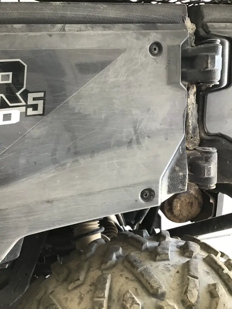

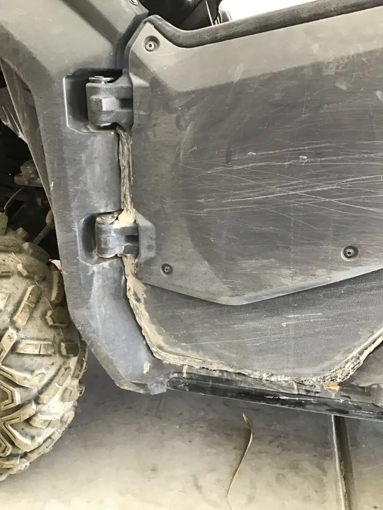

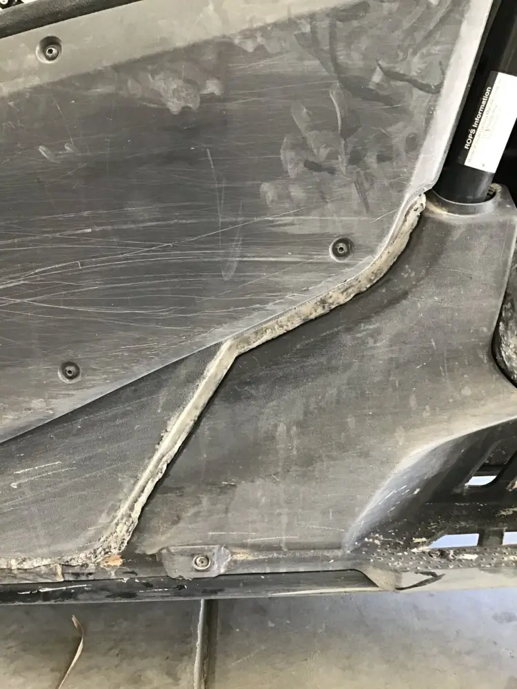

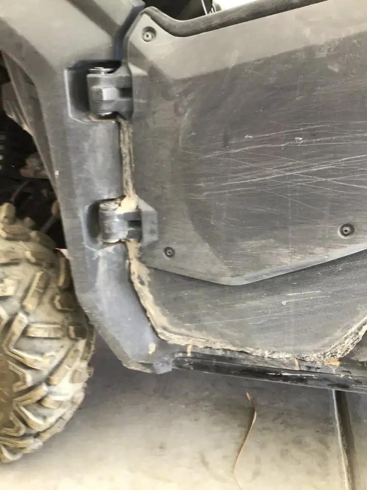

This will get rid of 90% of the dust,very red neck and more durable than I thought 2 years in.
That's exactly what I was gonna do. Coat the pioneer in pam, spray foam, and let sit. Cut the foam down some and put flex seal on it to protect foam. Then add thin weather strip for a seal.

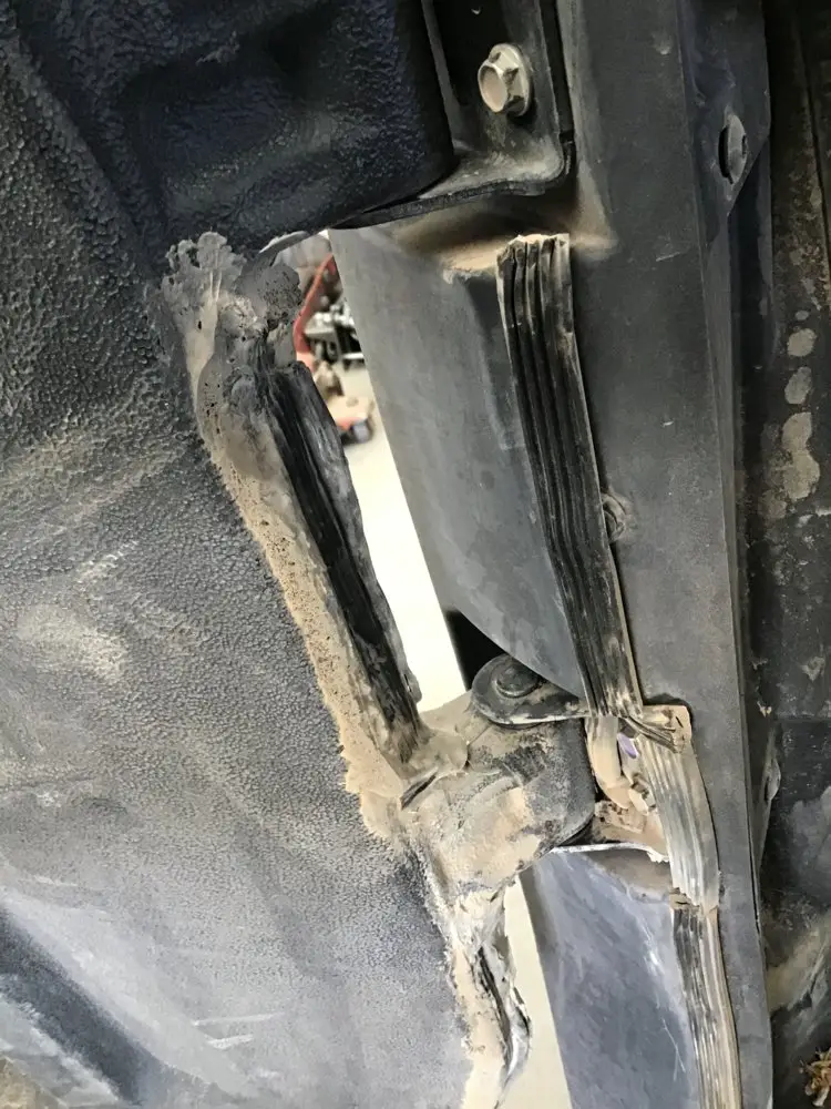

Clean the doors w acetone and scuff w sandpaper,put one layer of tape on body and spray w Pam.take the seat off ,in case u need to reach in and remove excessive foam.Be patient and let foam set up.Do the ft doors first,as u can see there is a Hugh void in rear,open bed so u can remove too much excess foam.u will need to trim a slot in order for bed to close.I just trimmed excess w a flat razor,then sealed foam w black acrylic caulking.I installed door bushings after that helped a lot from doors bouncing up and down beating up the foam.Take ur time and good luck this made a Hugh difference in my machine.

I remembered I also painted them w flat black paint.Let dry,then coated them w baby powder so they didn’t stick to the jams.

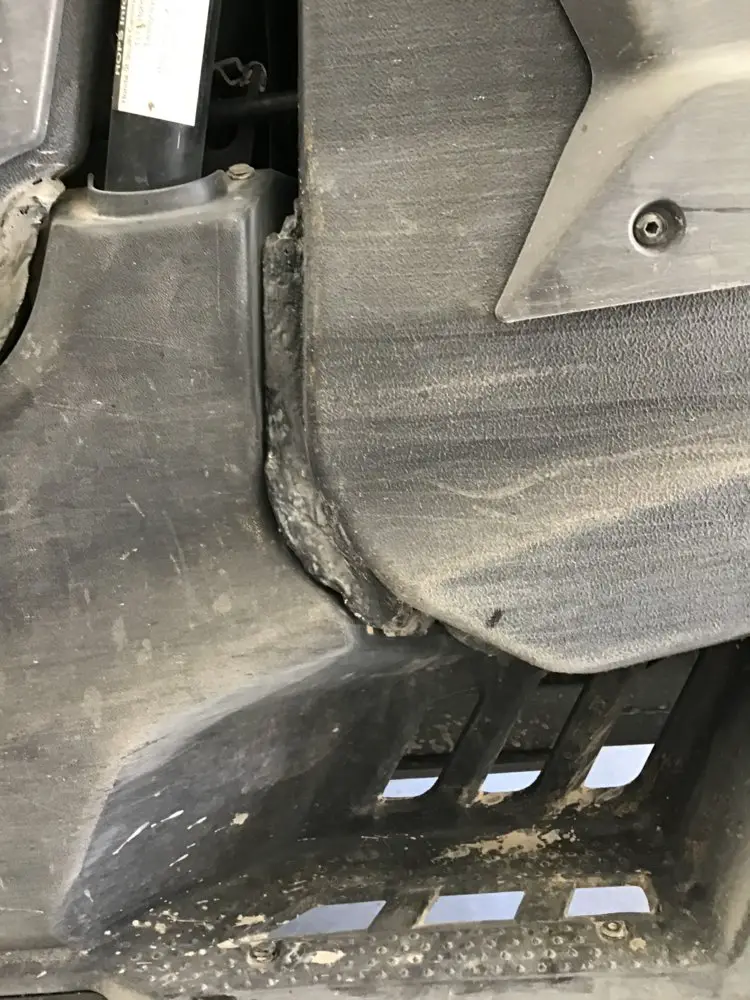

BTW, the 4th pic shows the only gap that is still open, down in the driver side corner. I'm going to see how well it works with 99% of the gap filled and if that corner causes issues I'll get creative with it as well. The initial thought would be to use a larger bulb on the weatherstripping but the 5/8" bulb fits super tight in a few spots and I know that my passengers will never get the door fully latched without me telling them to "SLAM THE SONUVA&ITCH!"

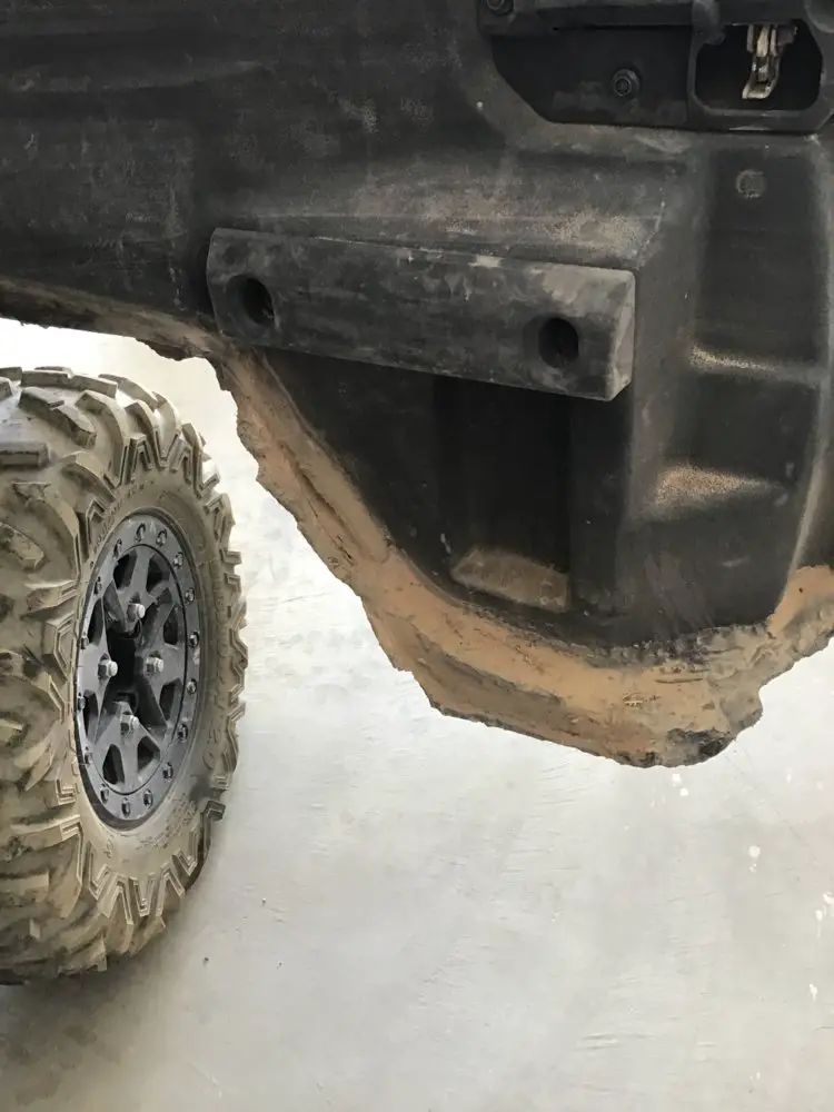

When u do the rear doors this is how much fill there is between the door and body of the machine,I don’t have any weather stripping on the rear doors.close to two inches.the foam needs to be adhered to the doors.as far as the weather stripping I used the tape ,and it fell off,so I went and got a tube of 3M weather stripping adhesive that stuff really sticks .
