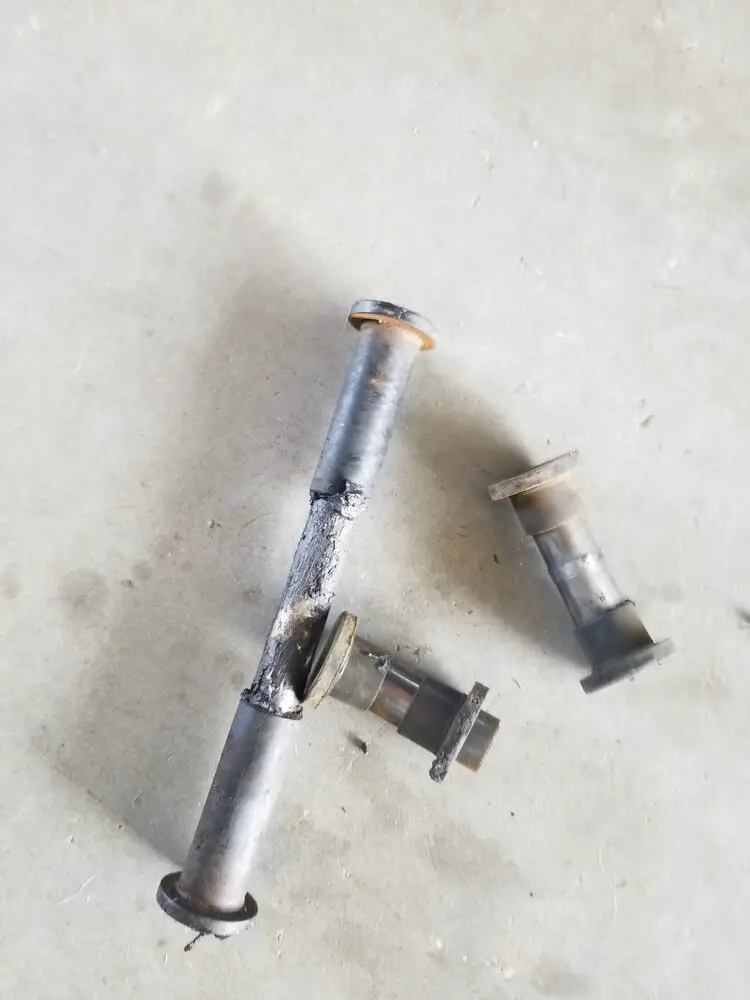

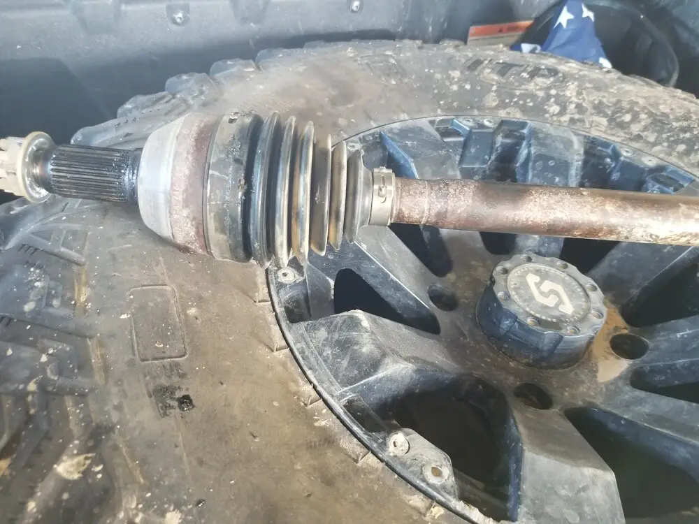

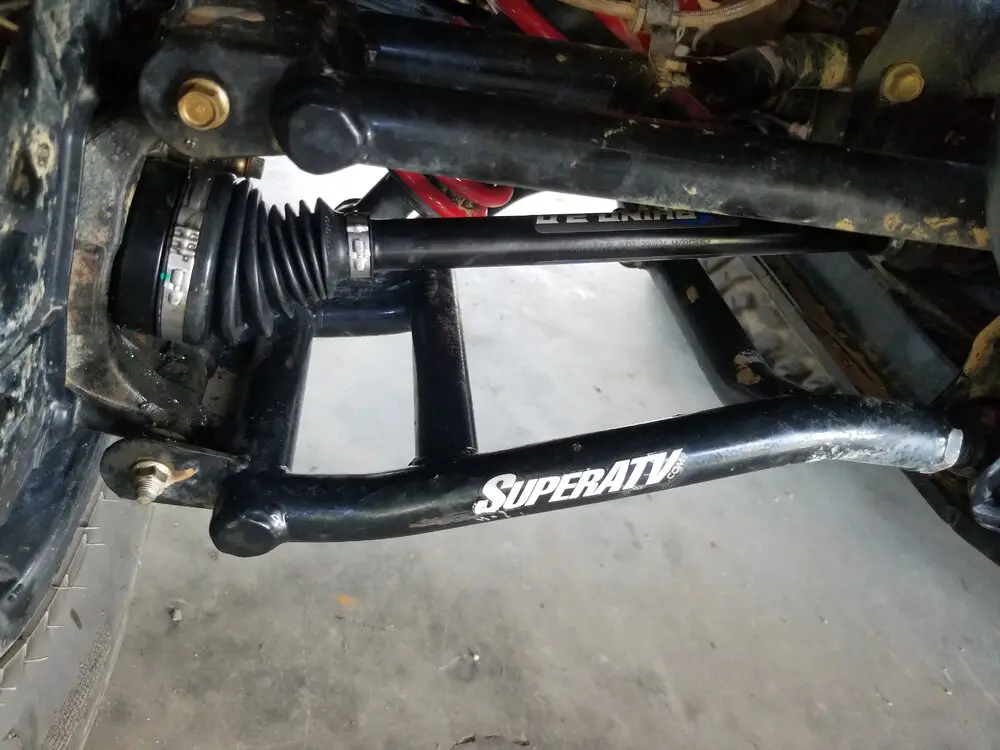

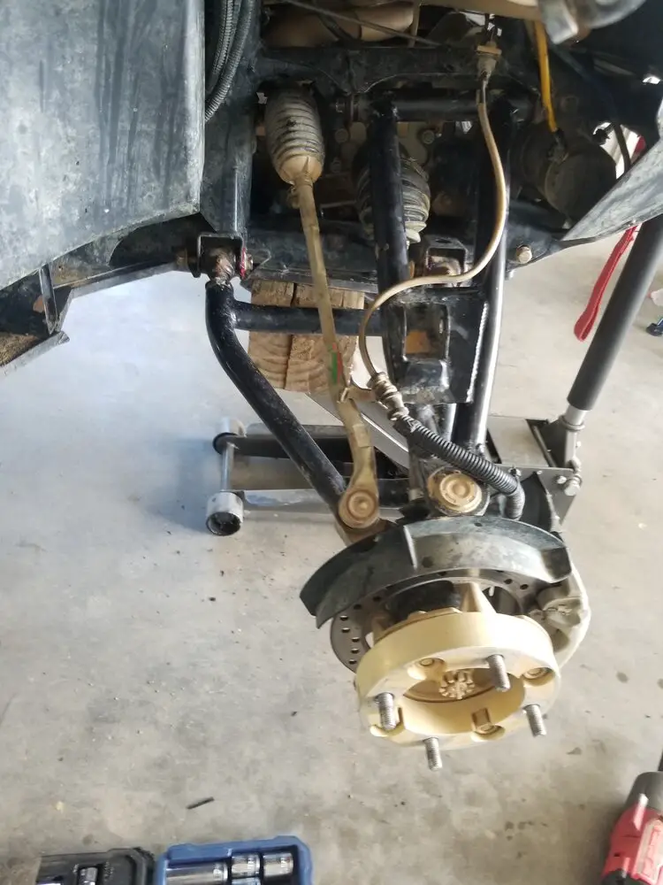

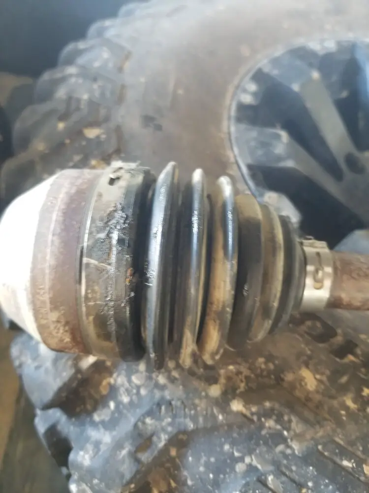

Haven't posted any updates in a long while, really no major updates done, but time for some much needed maintenance. I had a rear axle boot torn, so I replaced the axle with Rhino 2.0. The plan is to change the boot and have a spare rear axle. Also the front end has became very loose at highway speeds and very squeaky just working the steering wheel. After jacking up the front end it was very obvious the A Arm bushings are toast. I installed @RB3offroad bushings when I installed the @SuperATV A arms in November 2019. After about 1500 miles they are shot. So for now I put my original super atv bushings in. Just contacted Garage Products for a set of their bushings to replace all 4 corners with. I've heard nothing but rave reviews on the Garage Products bushings.
View attachment 281345 View attachment 281346 View attachment 281347 View attachment 281348 View attachment 281349 View attachment 281350
What a piece of junk! How does a man tear an axle boot? Come on Honda!

if you have any problems with ours we will replace them.... the trick is to grease them
I know for a fact he’s greased them, we’ve ridden together on several trips. I almost ordered your bushings but held off for now until the SATV bushings fail.

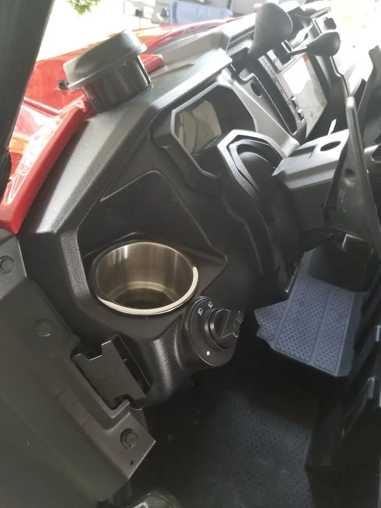

First two mods were the most essential. The extended vent line kit from @Bayouownbeer , followed by real cupholders.
where'd ya get those cup holders?
Been greased several times, seemed to only take grease marginally better than the Super ATV bushings in the rear. Front and rears were both lubed well at initial install with wheel bearing grease also. I can send these in for inspection if needed? I did wipe away some of the grease while replacing, but some areas just seemed to never receive any grease after initial install.
