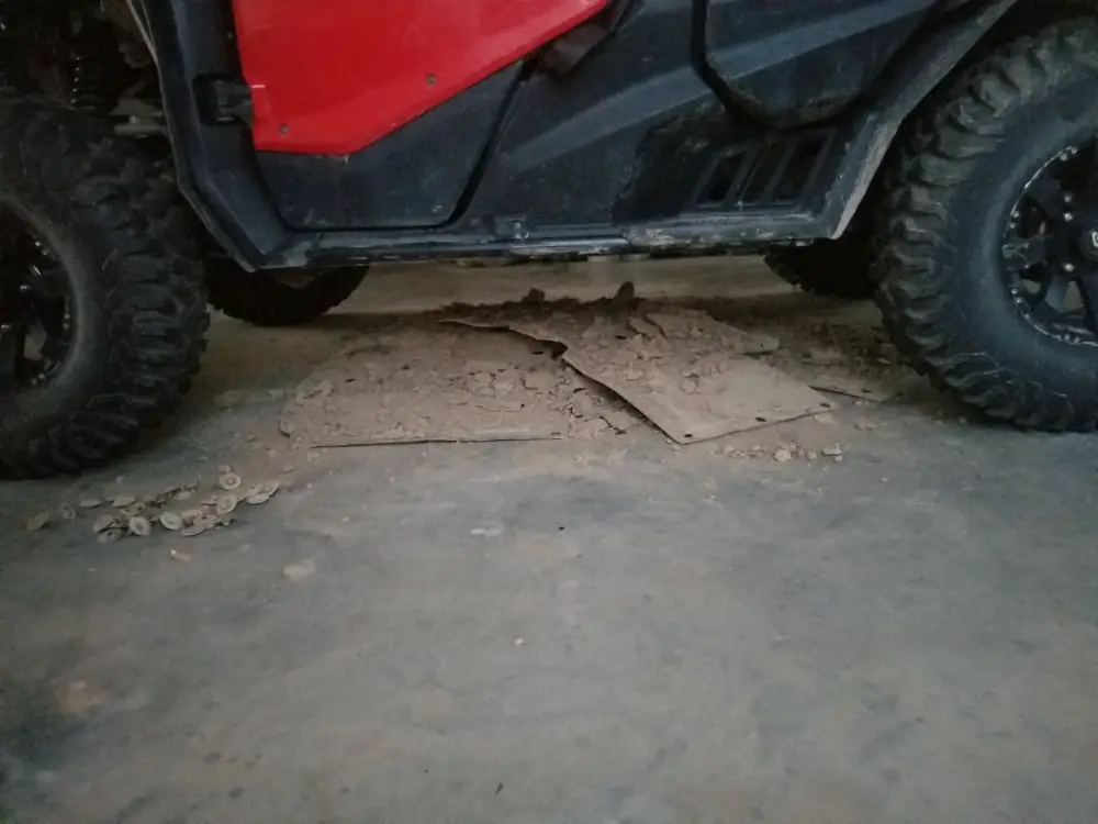

Aluminum skid off, gotta take a screwdriver to the frame tommorow when I have some light to clean the mud out of all the nooks and crannies. Already a couple hundred pounds lighter I bet.

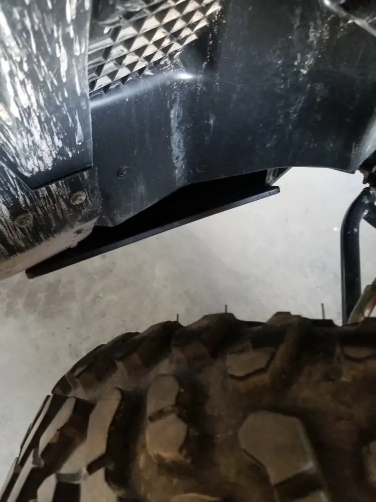

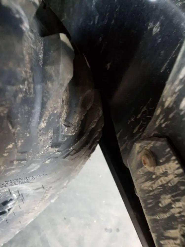

Trail Armor skids are on, but definitely gonna have to trim up the area in the front wheel well.
View attachment 198078View attachment 198079
20200419 130144

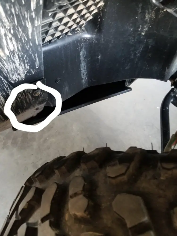

I'm running 28 inch evos with no arms and I was rubbing at full cock on my skids. I heated with propane torch and bent them up and fixed it. Now I'm rubbing the spot in the white circle at full compression. I wish I would have kept those superatv arms now. Lol
I like the torch idea! I'll definitely try that route before cutting. I really like the arms, I knew you'd want 'em back, lol.

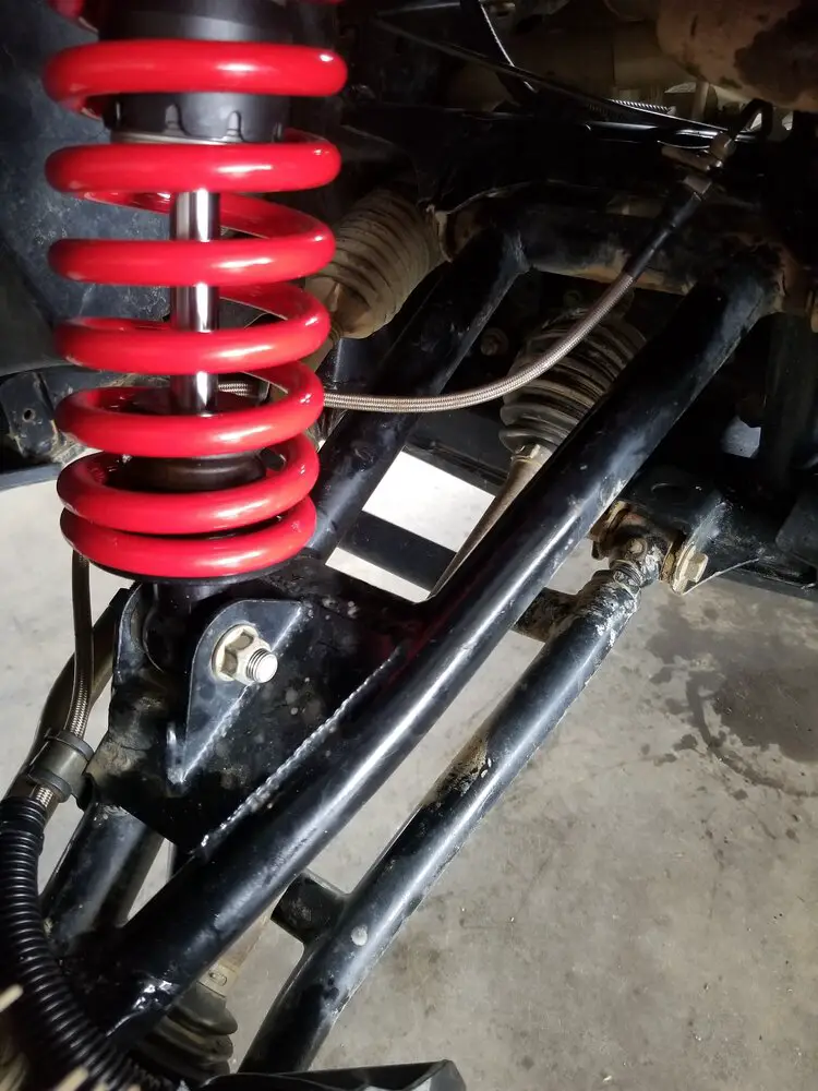

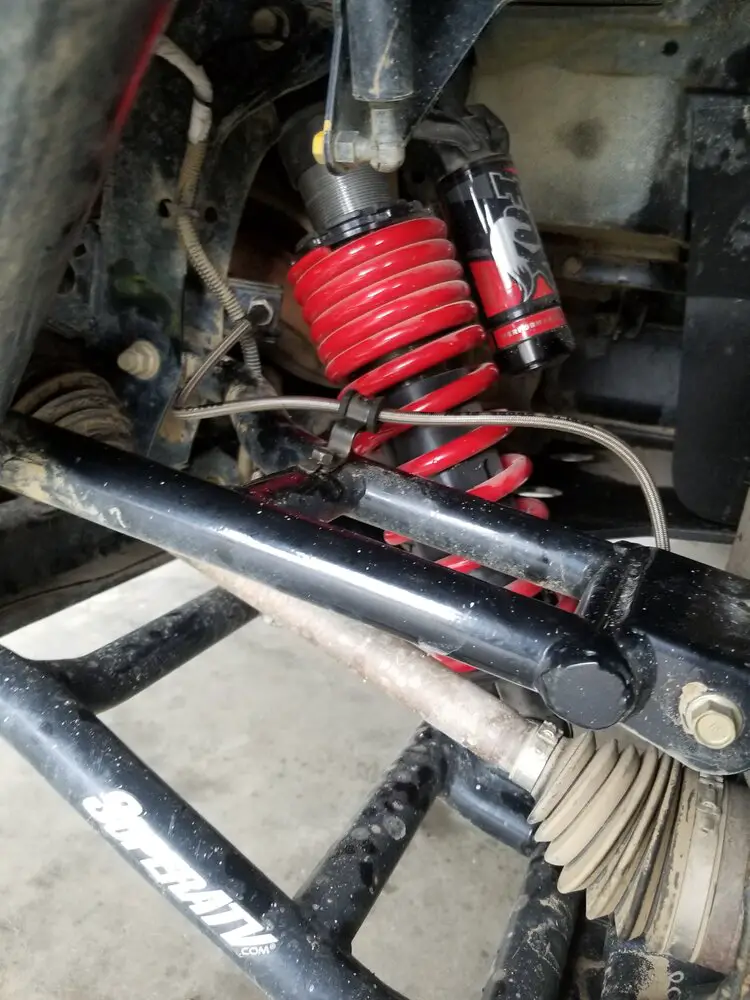

Havent updated anything in a while ,but I recently added Fox shocks all the way around and today I finally put on @jak9922 's stainless brake lines. They seemed to help the pedal feel a little and they seem to stop better if you have to get on the brakes hard. But most importantly they wont be as easily pinched/cut as the factory soft lines.
View attachment 229207View attachment 229208
Sweet!!!
Are they the same that come on the LE's?

Just a word of advice.. I would put dielectric grease on all the connectors and connections as there’s so much moisture, crud and corrosion over time. It’ll save you aggravation down the road and it’s easy to do now while everthing is clean and fresh.
In the last few years I have switched to using Kopr-Shield from Thomas & Betts on all my electrical connections for my marine, automotive and RV wiring jobs. It improves the electrical conductivity and eliminates the corrosion from moisture. It is messy, so I "acquired" eyelash brushes from my wife's supplies to use to apply it. It only takes a little bit to be effective. Don't just plaster it on and get it all over because it is conductive. I got tired of all the silicone contamination on everything from the Dielectric compound.
