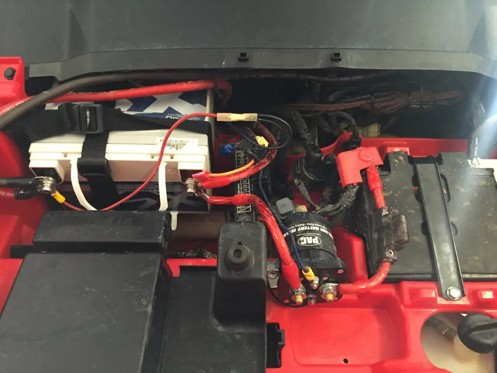

Here is a pic of where I put mine. Different than most because I am pushing an insane amount of stereo for a side by side. Put over 300 miles and haven't had a lick of trouble out of the charging system. I also installed a battery maintainer so the drop is not as bad when the circuit is open.
What guage wire did you use for the second battery hook up as well as what size inline fuse are you running?

I used 6 gauge for all of my
power wires. That's what was
supplied with my winch harness
& the PDM cable, so I used the
excess that I cut off of the winch
cables for everything else I needed.

I used 4 gauge because that's what my stereo amplifier calls far.

same here.
