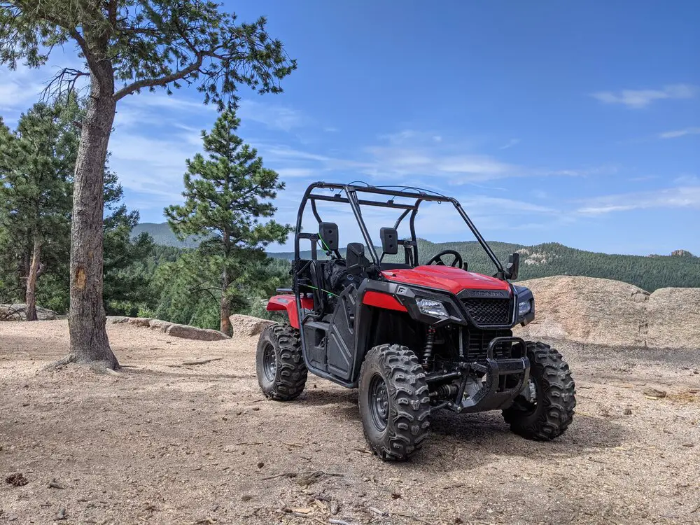

26 inch Bear Claws, 2 inch spacers and stage I Elka shocks have transformed my 2017 P500 from a rock crusher to a rock cruiser. Mostly do rocky (think baby heads) trails above 10000 feet in Colorado - the stock setup was awful. The new setup is so much fun and the ride is no longer painful. $2K later it's become the machine I thought I was buying! Better late than never - right? - Dave

Yes - stock rims; 26x9R12 and 26x11R12 Bear Claw HTR's. I run 6PSI. The sway bar is removed (of course!). By far, the Elka shocks made the biggest difference.
Changes this spring also include going from Rotella oil to Mobile 1. The machine is shifting better than ever (finally!).
Its not uncommon for a trail here in CO to start at 10k feet with a long pull to 13k or even 14k. We dont carry much gear and its just me and my wife. The machine pulls these trails with no problem, albeit slowly. We are in our 60s and don't need to go anywhere fast.
These are my first posts after three years of reading the forum - the forum has been so helpful - the information found here has been spot on! We wanted a 50-inch(ish) machine for the trails nearby, and we wanted reliability. We were a little disappointed with the ride and these changes have turned that around completely.

Yep - I understand. We have quite a few 50 inch trails here and many of the gates will pass 52. I have several different width spacers and sometime will only run with spacers on the rear. My machine with the 2" ones runs 54.5" in the back and just fits on my 54 inch wide trailer.
It's all about roll over stability for me. When I first put the 26 inch tires on, I gained ground clearance. That allowed me to lower the ride height with shock adjustment. The stock shocks dont have much adjustment so when the Elka's went on, I was able to lower it a little more. I'd rather bottom out than roll over! And we are slow crawlers out on the trails - so I get to pick and choose a line.
Pics to follow....

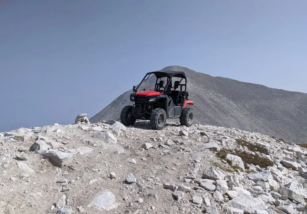

The payoff. 13,600 feet with a short hike to Mt Antero, in the background, at 14,000 feet. Is the P500 underpowered at elevation? Yes - but you don't notice because you're being very careful and slow!!!
