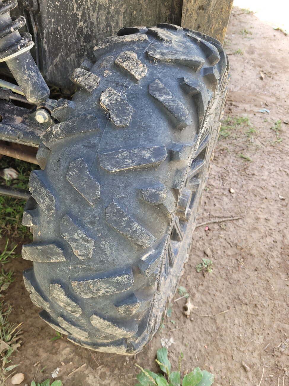

I got 4900 miles on mine. Mostly gravel road/light trail riding. Just got my new tusk terrabites today. 28x10x14
