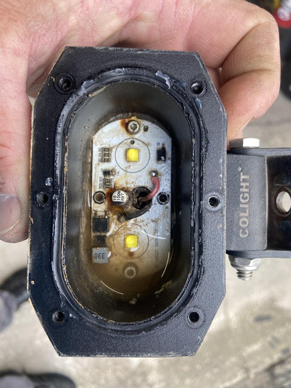

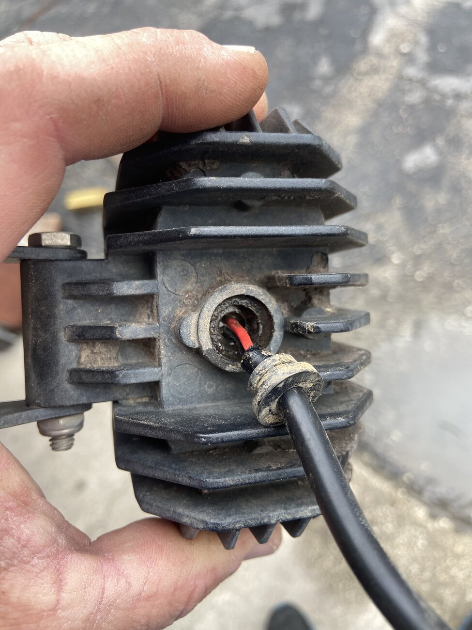

I found the light that was causing the problem. Turns out it had water in it.
Which I can only imagine that it was back feeding or sucking up more power. But I’m no electrician.

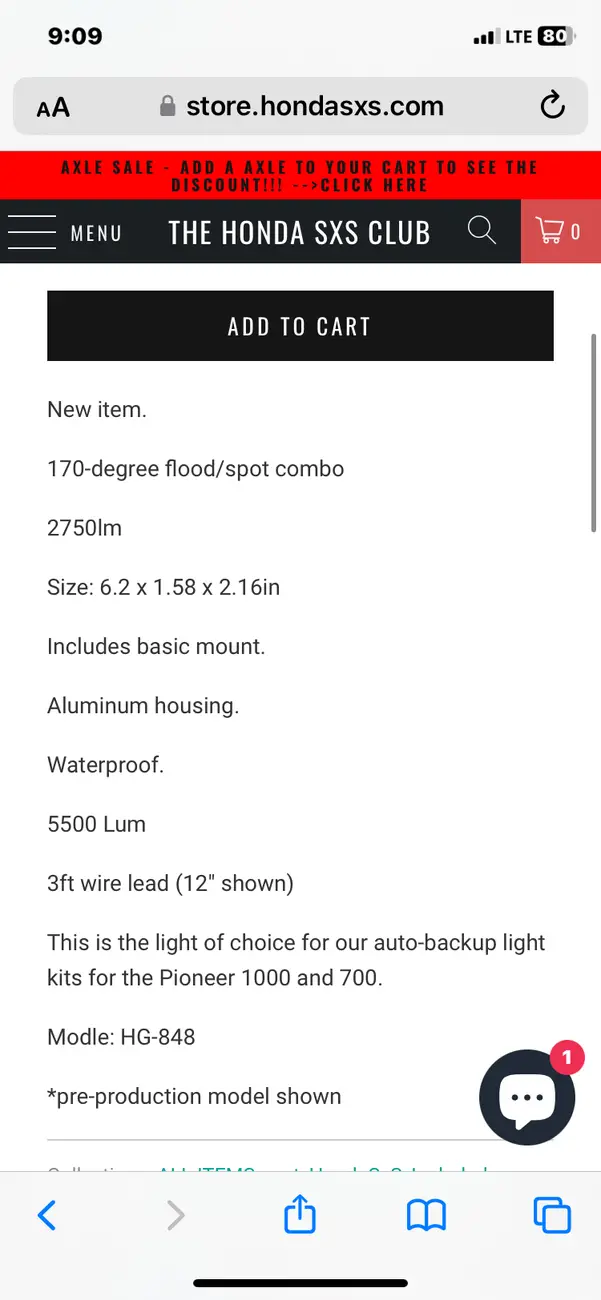

ChiCom made?
Yep, I wound up getting a set from the HondaSxS store. They appear to be of the same origin, but they were a helluvalot cheaper.
6 inch LED. 170 degree wide view spot/flood combo.
I’ll try em out and see how they do. The others lasted about 2 years.

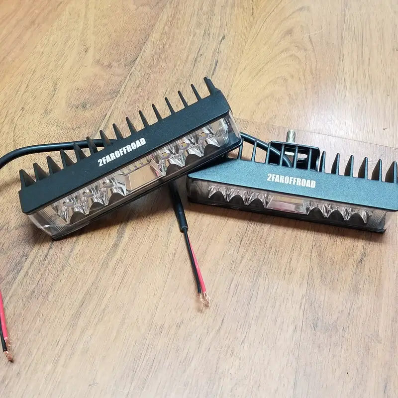

I got the new lights installed this afternoon, and they are Bright! They seem to be better quality than the others I had.
Installed with heat shrink connectors, to ensure that they are waterproof. Tried with just the key on to make sure I had the plug and wires correct. And ran the motor for the final test and shifted into Reverse, the lights came on; and no stall occurred.
Awesome. Can’t wait to get back out on the trails.
