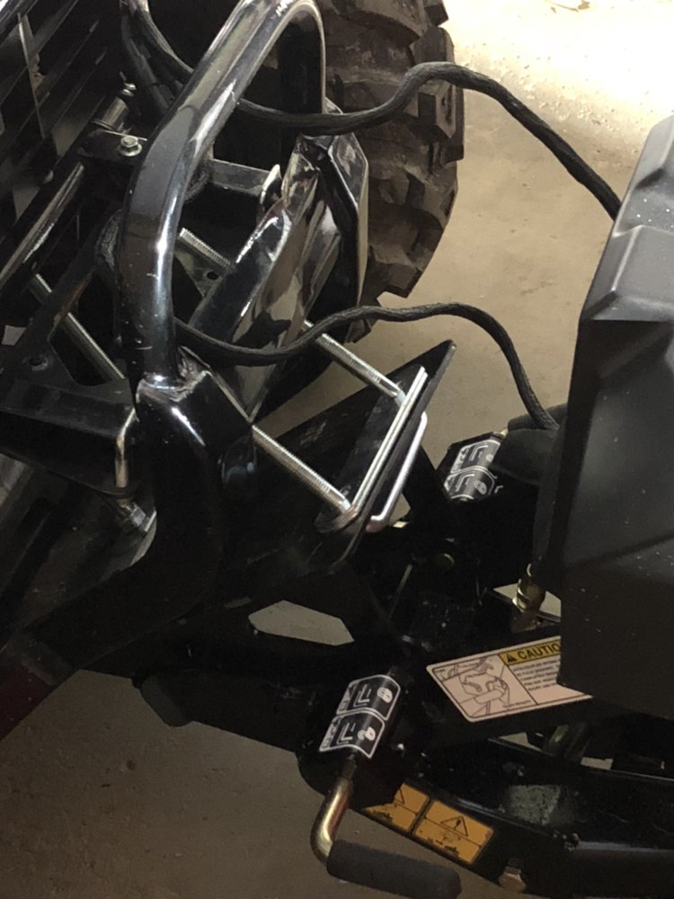

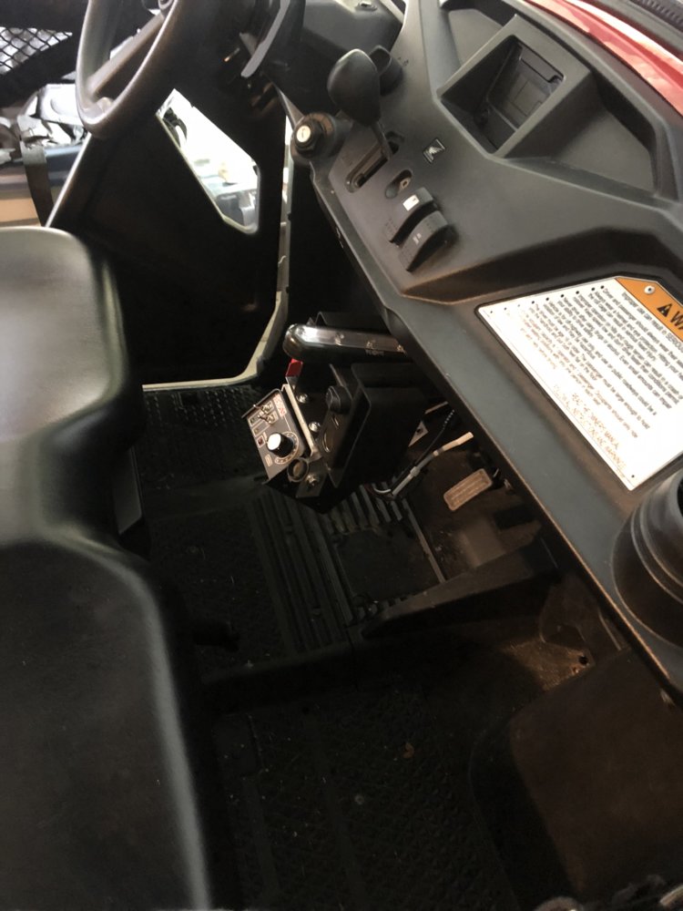

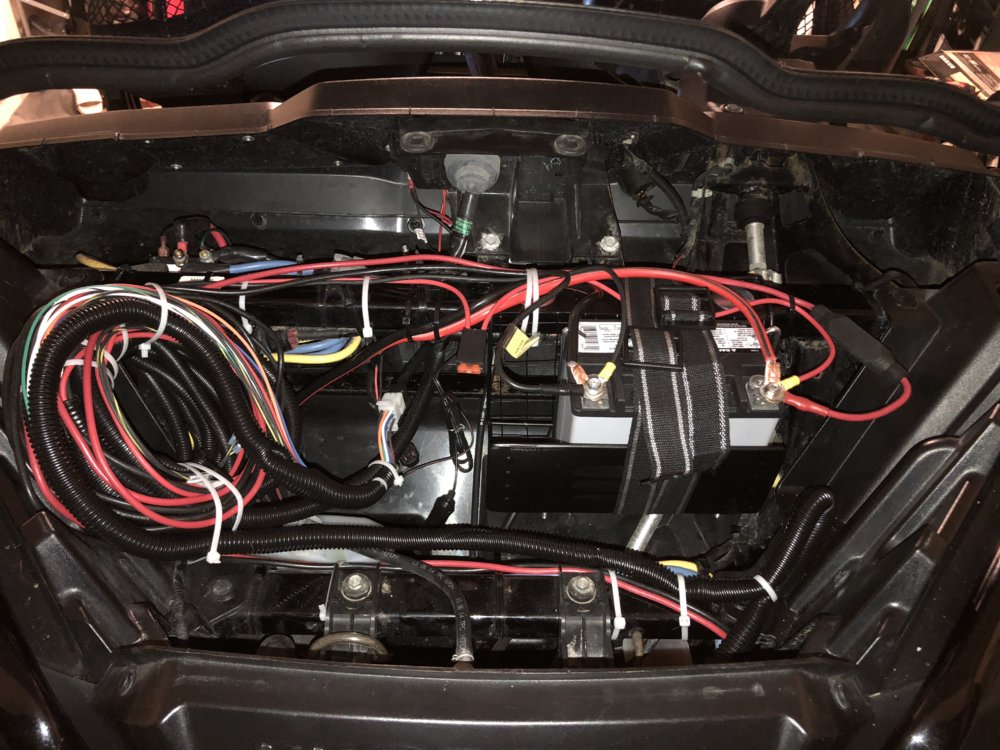

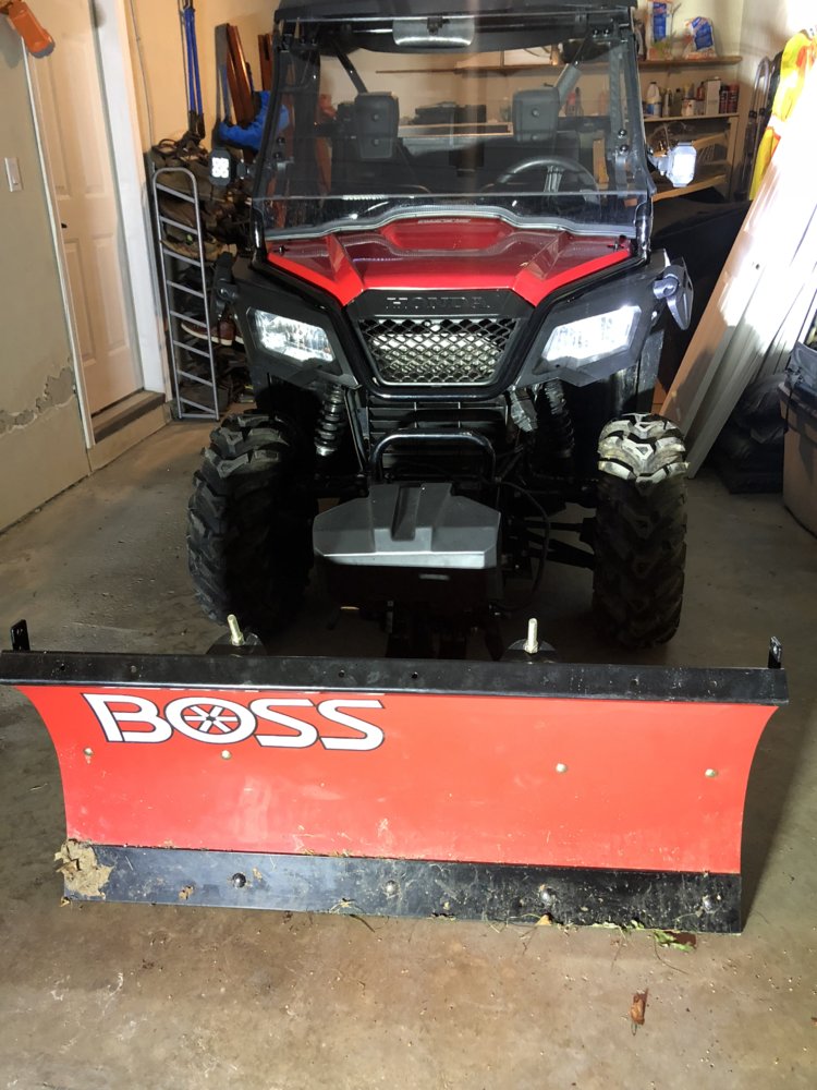

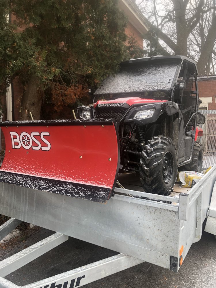

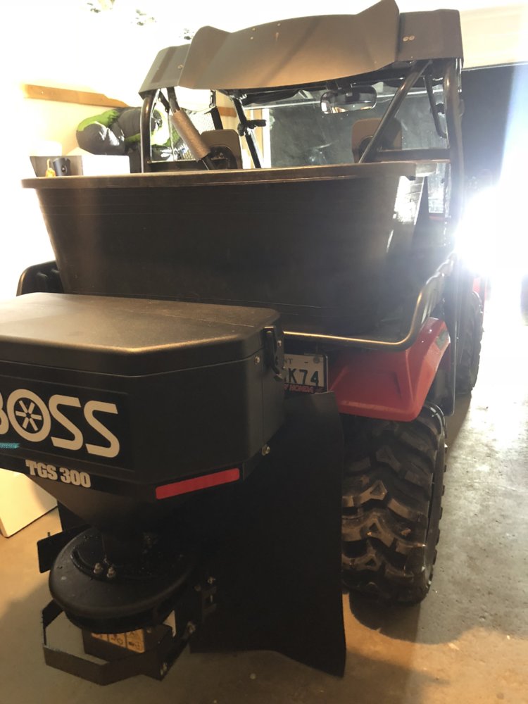

Just a few pictures to let you all know this is possible and it works amazing I added a secondary battery this works absolutely amazing it’s for an ATV I just picked a Honda Foreman mounting bracket they do not make a mounting bracket for the pioneer 500
I had a click and go before and it was time consuming at best.
having the hydraulics really does help reduce so much time. deleting the Reverse safety feature is an absolute must. The 500 clears sidewalks absolutely perfect with a 4 foot blade

View attachment 174165 462C7146 541E 4C0D 989E 86FF4E22BFAE 9218FC1D 9D5E 416A B2F6 4F089A73ABF0 25B7F2C3 4CA4 49DE AC95 FD11A8DA7927 EB1347F0 695B 45BA 95D6 8F4727E2A5C3 BD3D5CFF 1F45 42E7 B718 259EE2E028EB 4B55EEC8 7E8A 42AD 85B6 C24423CB3667 E37BCFCB 25D8 45AA 90A5 0ED931B4E0CA View attachment 174181 099CD3FC 5D7C 454F A79B 6766E038FD0E

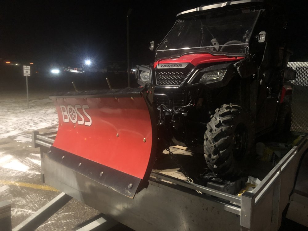

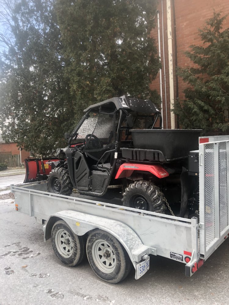

Nice set up for your purpose, that little blade would work great for clearing sidewalks. Looks like you're up on blocks in the trailer, is that a mid mount plow bracket?

No actually the bracket front mount right onto the bumper two bolts below it’s up on a skid so I can get the 12 foot set up on a 10 foot trailer Lol
I just grabbed a used bumper for 25 bucks and drilled it out for the foreman plate I’ve had absolutely no issues and use it commercially

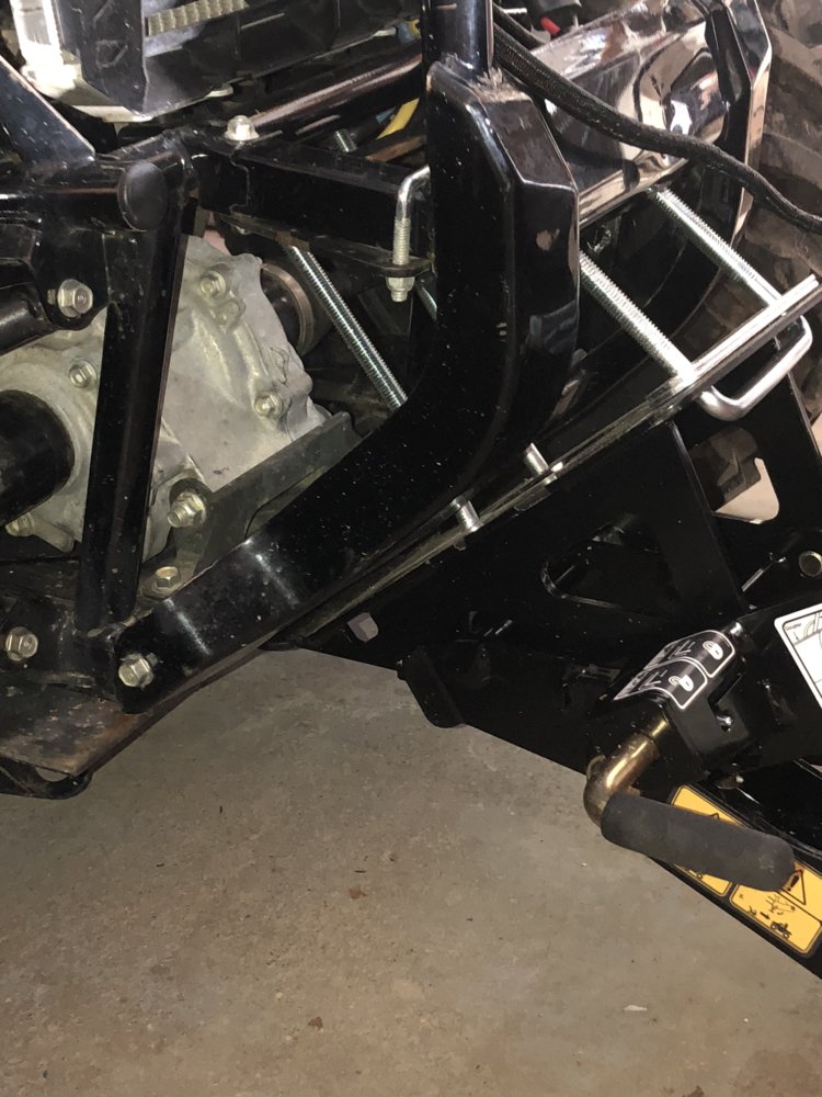

Two heavy duty carriage bolts A piece of heavy tube behind the OEM bumper with U bolts mount a small strip of heavy gauge steel across the front tube frame So you have something to drill the bottom of the forman bracket into.
Basically make yourself a front square skid plate out of heavy gauge steel and then drill into it for the bottom At the top just used to carriage bolts through the plate through the bumper into a square tube cut to fit behind the bumper to give it strength pics below
