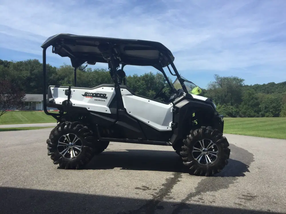

I know there are a few threads about clutches burnt up, how many have had this issue? Big tires? Running in High range? Any HD clutch packs out there?
I'm running 30 inch tires now, I hope this wont be a reacurring issue, any imput would be great!!
ThanksView attachment 28557
I just got mine back from warranty, they replaced one of the clutches. The service manager told me they have done more than 100, don't know if he is over stating but I asked him and he repeated the claim. He says to ride it in low gear. So, I went and rode Ocala National Forest the next day in low gear and my temperature light came on after about an hour of riding 25-30mph. I let the machine cool down for 15 min. and rode it in high the rest of the day, no problem except for the heat coming from the dash and seat made in pretty uncomfortable, this was my first ride in warm conditions. I think Honda has a problem with this machine. Love it at home on the ranch, not loving it on the trails.
I wouldn't be riding it at 25+ in low. There's really no perfect recommendation for speed but normal riding high is fine unless lower speed sustained say under maybe 10-15 or so or terrain requires, hills or things the rig will struggle in. It is best to keep r's up but 30 in low sustained is probably way to high.
100 machines from one dealer does seem a bit of a stretch given the percentages but some dealers will have higher/lower percentages given terrain and riders. There is definitely something here more then just driver error in many cases so hopefully this gets solved soon.
The machine does get warm and will obviously get warmer with higher r's but heat shield and/or blower helps many in need of solutions.
Hopefully you have no more problems or at least this quickly and thankfully Honda took care of this.
