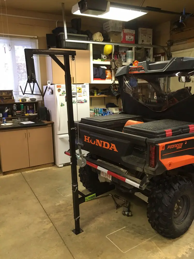

What I was thinking. These are made for lifting deer, rated for 400 pounds? only a little over $100 on Amazon. Takes apart to pack up, but it does weigh about 30+ pounds. I used it to pull this mailbox post, first try out.

I’m not needing the loading capability. I was more looking to see if I could carry the load in the hitch hauler vs. the bed.

I have a hitch hauler, hitch mounted cargo rack, but with 100 pounds or more it really sags down on the back end. My 500 is much lower weight capacity vs the 1000-5. It just seemed that weight sitting 2 or 3 feet out past the hitch made me concerned it would drag on any uneven ground. A 100 pound load would be similar to the tongue weight of a 1000 pound trailer load as to how much the rear suspension would squat down. Some people on hondasxs.com have done creative custom mods to raise up a hitch hauler to be effectively a bed extension.
