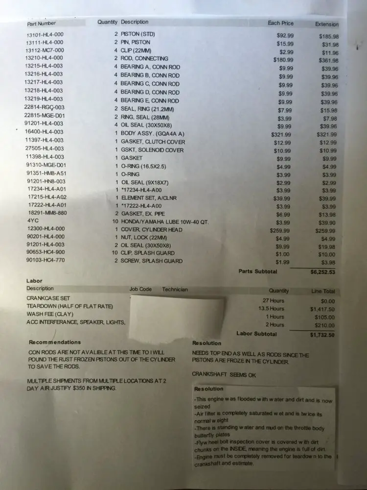

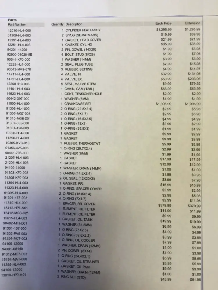

View attachment 16603 View attachment 16604 Here is the complete break down. If wish I make that to wash something.
Did you ask what a crate engine would cost? I think it would be a hell of a lot cheaper than buying 1 part at a time. You could sell off the old cases etc. to recoup some of the costs, I seen on FB where a guy bashed in his engine casing on a rock with the OEM skid plates.
Also you can get those parts on average 22% off at pro caliber.com FREE shipping. That's nearly $1000 less right there. Your already F#@%d no need to get raped too.

No there are several main components that just aren't available. Not really a big deal on your average v8 but this is such a close tolerance motor with high revs it's unnerving. I think if it gets covered like we're thinking I'll push a bit but beggars can't be choosers. I sure loved hearing from several mechanics just how much better Honda actually is. It's been asked how I can be a fan of Honda after all of this well that's why! The stuff that came from Japan is flawless it's the testing that was lacking and a few lazy people that left things loose. I think they probably changed air intake mid ship from 700 design and didn't test much is my guess.

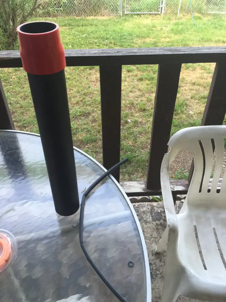

I want to take a second to give a shout out the the Traveler himself @joeymt33. He was gracious enough to not only let me copy his patented snorkel design but to send me parts for it as well.
Arrived today (probably didn't need to two day ship it buddy:)) just need a machine to attach it to. As soon as it comes off the trailer there will be a hole in the hood (which he gave me the secret for hole placement,ingenious really) and this goes in. Even powder coated it in my choice of color. Thanks to you Joe you're a stud. Just another example of the incredible people here I'm not thinking to many other sites have this many people willing to go out of there way for someone they've not yet met! You guys are cool as hell really great people! Thanks to everyone here! Honda owners are an incredible group of people

Well now i am dying to know the ingenious secret for hole placement.:)

I forgot to mention that I sent what pipe I had left over and you can cut it to your desired length. Also, the powder coat got a imperfection in it as I accidentally let it fall over before it dried so if you cut some off, cut off the bad side. :(
Also, two day shipping was the standard with a flat rate box. I was surprised at how cheap it was to send it that far in just two days.

Simple really but it took some thought. You'll have to bug joe.
39,130
Haha, I used duct tape and centered (best I could) a laser pointer in the intake tube. It pointed straight up and with the hood installed there was a red dot for the drill point. :) scary what a redneck with duct tape can do.

That is a great idea! Much better than mine! I used masking tape on fender with Snorkle tube installed, marked center and measurement from point on tape to outer edge. Removed tube, installed hood, Measured over width of pipe and then marked center. Notice the placement of tube on underside grid while illuminated. For those who may not have a laser pointer ;)
