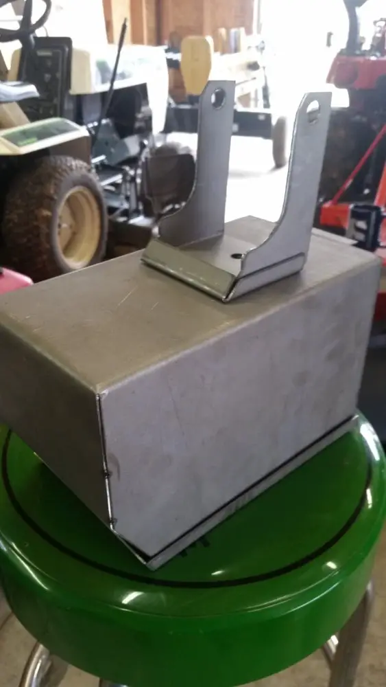

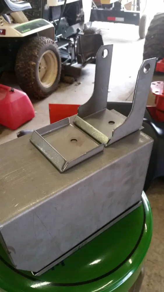

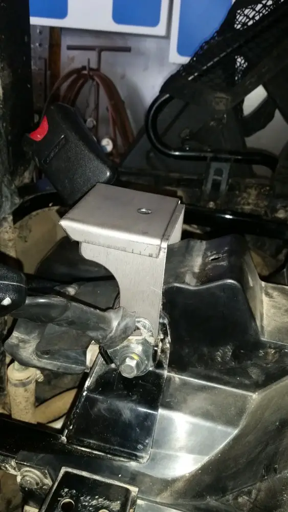

Final bracket is complete and works great.
The part that slides , will be welded to the bottom of the box and the other piece bolts to the frame. There will be a 3/8-16 threaded knob that tightens down the box fom the inside of the box , to secure the box to the bracket.

Brackets and slide would be a good product by itself, could add box or padded arm rest of preference separately. Good job @Chooglin .

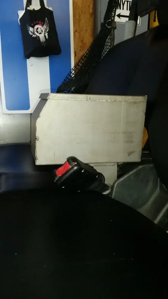

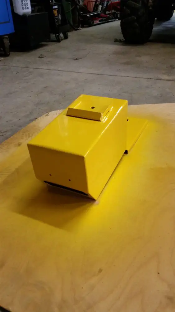

Geting closer , I will be painting the box tomorrow. After the paint dries I can assemble everything and give it a try.
I have to give a shout out to my good friend Wayne , I know that none of you guys know who he is , but I need to give him credit for most of the work on this project. I designed the box but he did all the bending and welding on this. I just don't have the equipment to bend this heavier gauge steel. He is one of the best fabricator's I know , this guy can build anything.
I will continue to do the glove boxes but these consoles will all be on Wayne (aside from assembly)..........anyway props to Wayne for a fine job on this!
