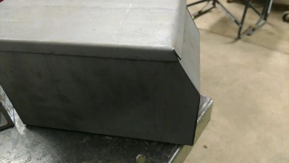

I have decided to ditch the idea of trying to find a box/console that will work for this , so I am just going to make an all metal box!
This is what I came up with and we have already got started on it.

I will post some later tonight. I am going to install the new box tonight to make sure everything fits as it should. If everything looks good , I will take it to the welder guy so he can finish up the welding.
I have all the electronics for it , so I will install those after its all welded up.

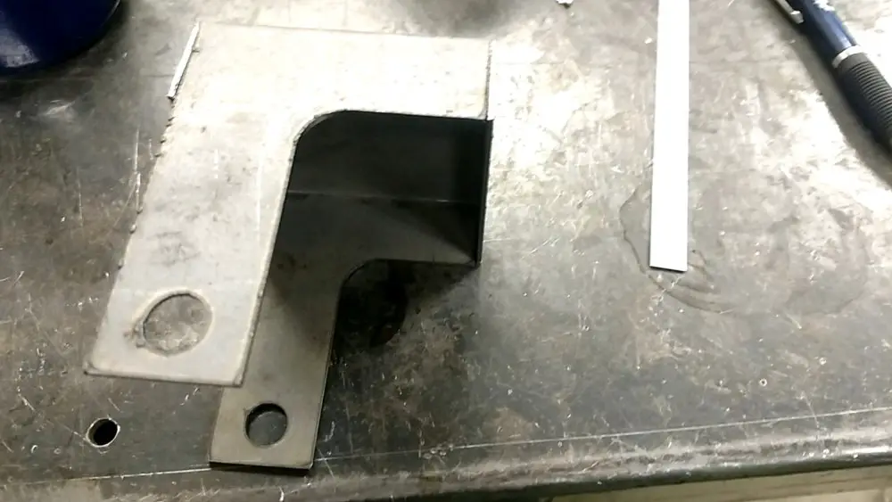

We did a dry fit on the box and mounting bracket tonight. We discovered a few clearance issues with the mounting bracket , so we will make a new mounting bracket with all the corrections and it should be a go from hear on out.
I should have the new bracket in a few days to try it out , if it looks good , off to the powder coater for the bracket. While that's going on , we will work on getting the electronics all mounted and fit before the box gets coated.
We had to use a BFH on the mounting bracket to gain some clearance , so just ignore those bent corners :)......lol
