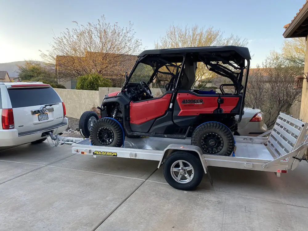

I do something similar but use a 300# capacity bathroom scale and a “T” shaped piece of 2x2 to stick up in the coupler. I’m probably a little heavy on tongue weight at 270lbs, but it tows great.

PJon... Nice trailer. I wanted an Aluma and had to settle on a 14 foot enclosed dual axle trailer due to supply constraints. The good news is that the 14 foot trailer doubles as a garage.

I would move it back about 8 inches, you are tongue heavy and try it. I like everything level or close. Now if you start loading Ice chests on the rear of the trailer that suggestion goes out the window.

If I move it back 8” it doesn’t have enough tongue weight. Where it’s loaded now, I can fold the bi-fold ramp down flat to cut a little more wind resistance. I’m towing it with a 2008 Escalade long wheelbase so I don’t have to load anything extra on the trailer. Also, the trailer is level when I’m on level ground. The photo is in my driveway which is sloped.
