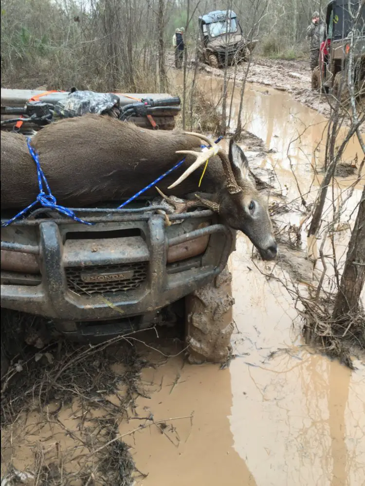

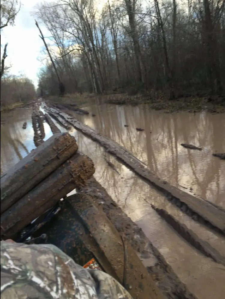

I currently have a 02 Honda rubicon that I have ran 27" mudzillas on. I did break and cv joint but it wasn't in the mud. I was pulling something in reverse and it poped. It was completely my fault. The only other thing I had to change on it was a sensor that reverted it from shifting. Other than that no problems. I love the low gear on it. I had no problem turning these tires and never tried anything larger but the low gear in my opinion was a good low. Down here we have no rocks, mountains and depending on the location not even hills. We have mud and at times it gets deep. I did forget to mention in my first post, 1 of of the members does have a Honda 700 that he bought last year. He has a lift and 28" tires and that's about all it can handle in the terrain we are in. The last weekend of the season he poped his winch cable twice. It was time for the season to be over. Going hunting we do not look for the deepest hole to see if we can make it or not. We go around as much as we can. A four wheeler can pass much easier but a 6 mile ride from the camp and about 4 of which is in mud gets cold and are limited with room. The commanders around here have electrical problems and rangers have problems all the way around. I will keep reading and hope that Honda does come up with a fix before I buy. I put a pic to show the ruts in the club. You can see the tops of the ruts have been scraped by skid plates on the bikes that can still pass. And this was 3 weeks before end of season.
View attachment 10823 View attachment 10824
Looks like my camp !
