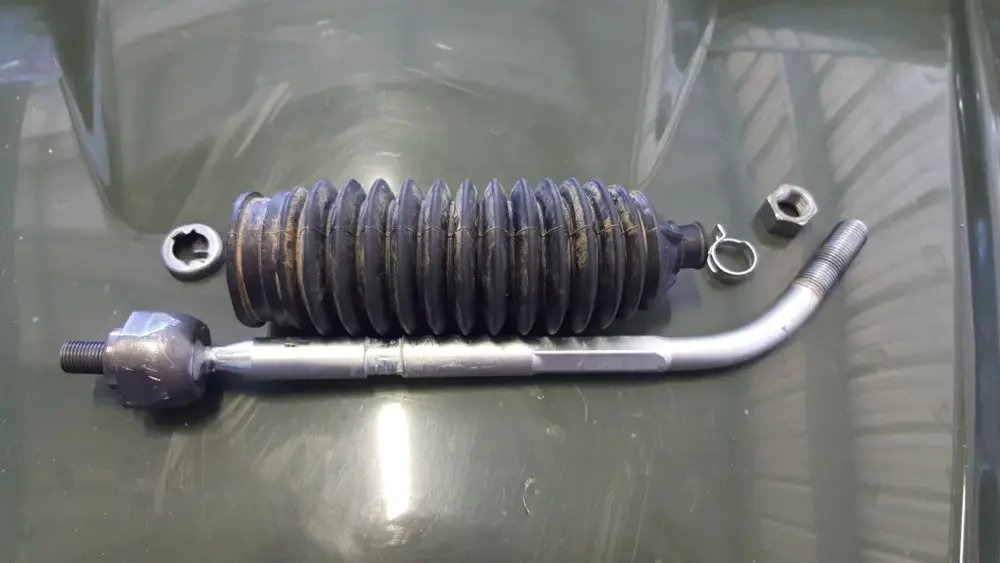

Well in my particular case I had bent my tie rod a little then when trying to nurse it back to camp finished bending it into a 45 degree angle on a 40% incline, I had just started down the 1000' hill and within the first 30 feet hit a rut & rock in an unavoidable spot. The machine was pointing downhill with pressure on the parking pawl and in the process of two other P1K's trying to get me back up that 30 ft. I had no choice but to shift from L to R and something must have gotten tweaked due to the pressure on the shifting fork. Mind you this was a very peculiar situation and no one would normally stop on that type of incline but there was no way of getting down those switchbacks with one wheel pointing off full lock in one direction or the other while one was straight. This too was in snow and ice at the end of Jan which did not help matters at all. It was just one of those things that happens when riding in the mountains.
I gotcha one of them out of the ordinary deals.
