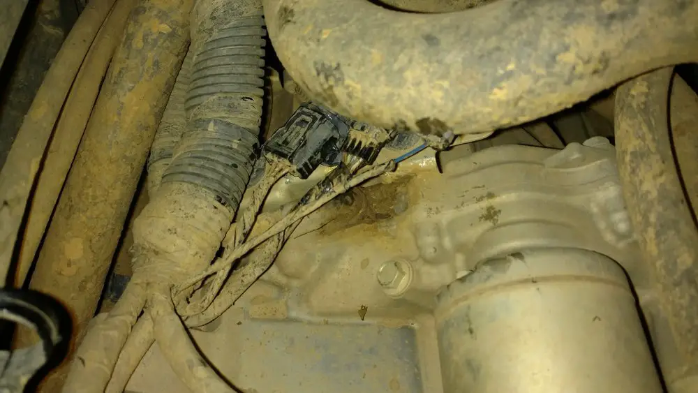

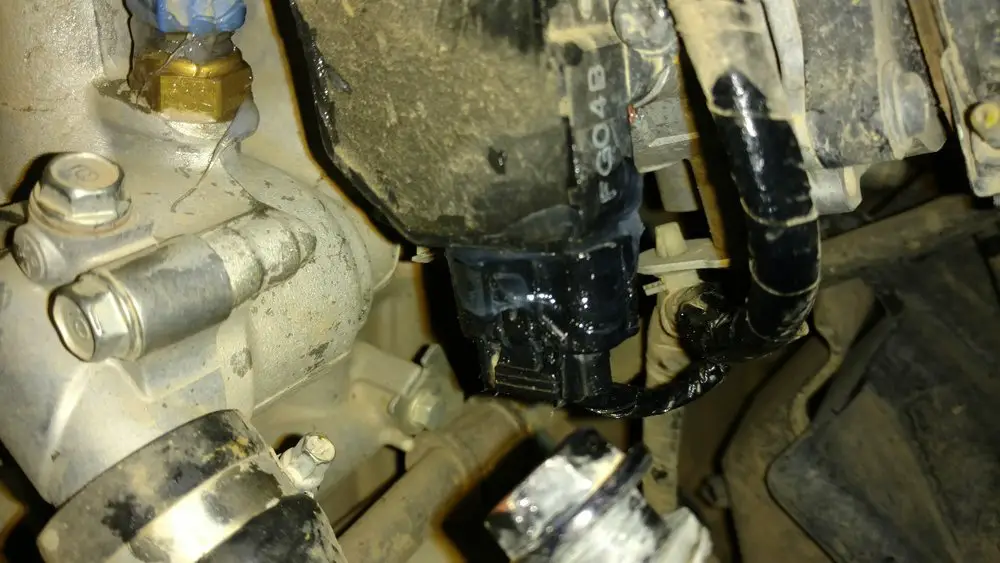

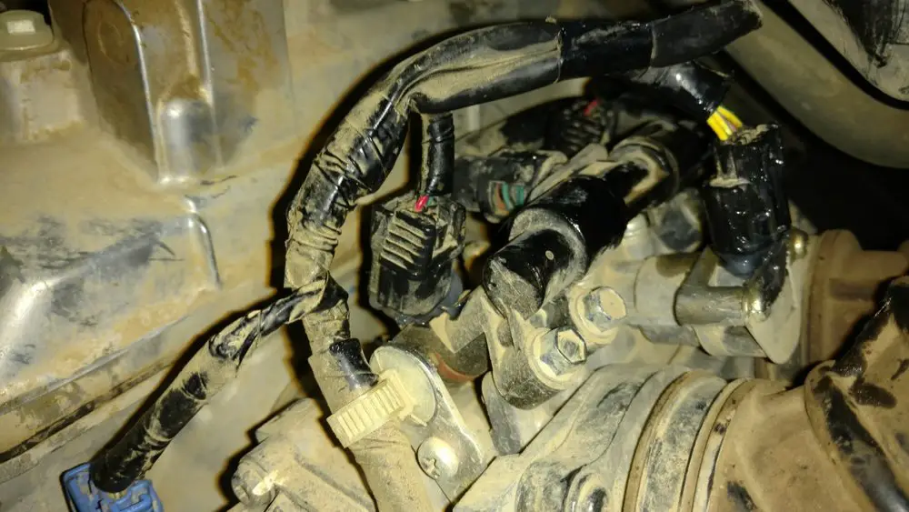

Ive been having trouble with moisture and connectors last few months. Finally got around to addressing it. After deeper water crossings, washing, or heavy rain, it'd go into limp and show 8-1 code (poor connection with tps). So I broke out the dielectric grease and took care of it. I'm almost done but had a chore to run. All I lack is connectors under seat, coils, and sparkplugs.

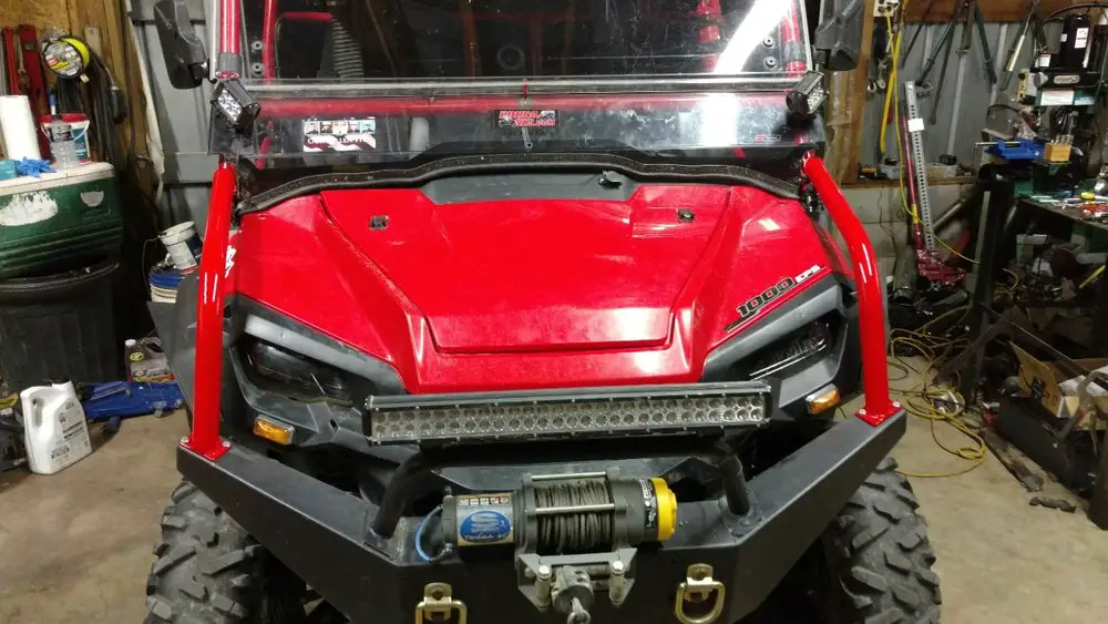

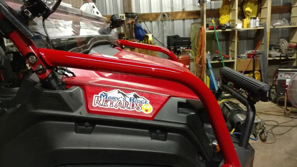

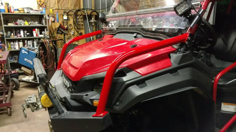

Made a little extra protection for the front today. Also have a great platform to make a removable front rack in the future. I think it came out pretty good. @Yankee provided the inspiration for them with his lol.
