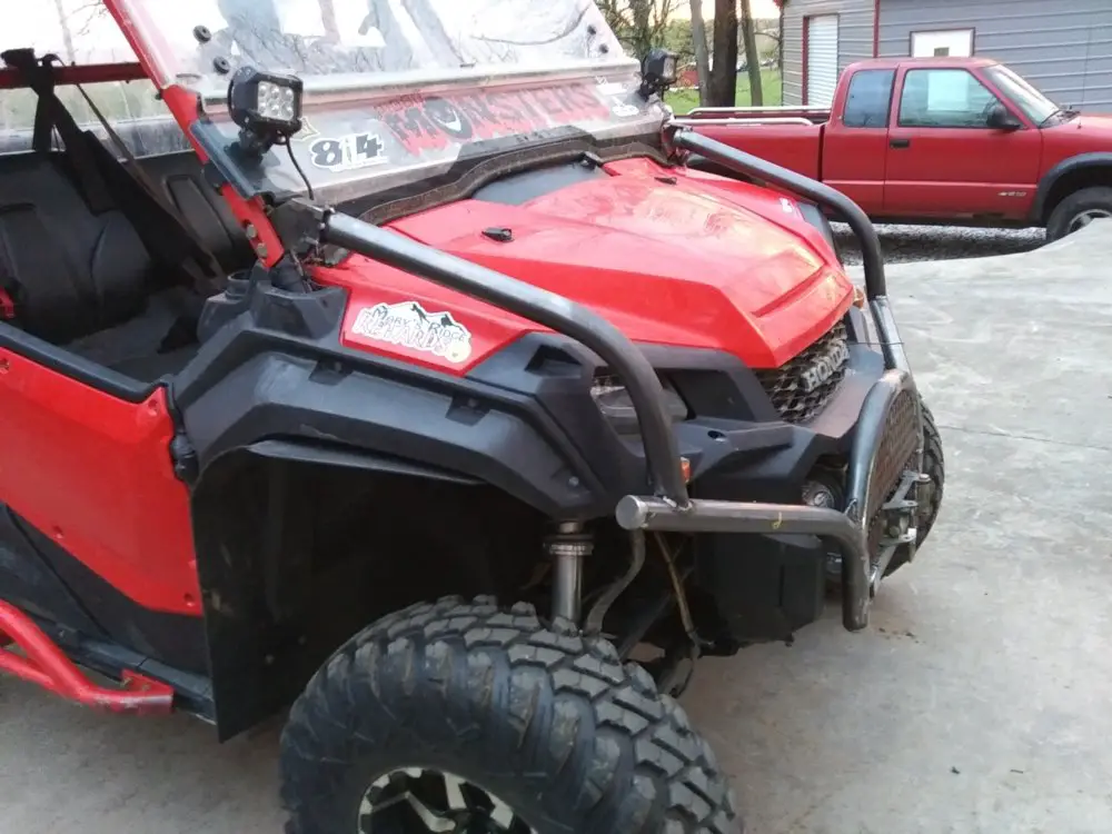

This however is getting me pretty excited. I think i like where it's going.

Hey Delton, where will the recovery points be? Do you remember when we winched on the top middle bar of your OEM bumper? We both thought it would break. Think yours will hold?

Im thinking couple of D rings on end of square tubing. And yeah i remember that winching. Given the much more sound material it should hold up well. Especially when I tie it into the a pillar bungs.

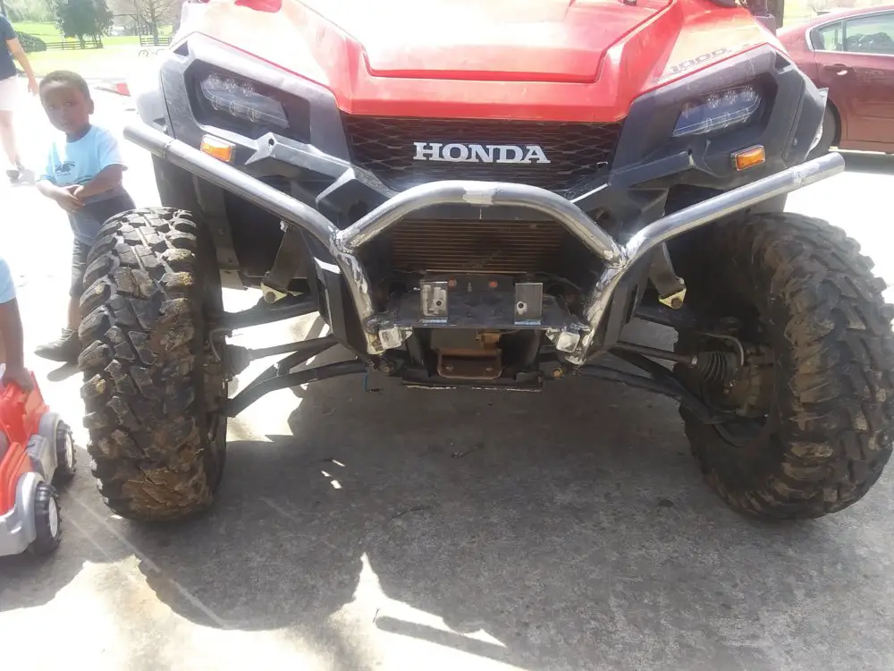

Yeah well thanks or not i totally screwed the pooch on this one. I should've welded everything while mounted on machine. But I removed bumper and drivers side tube twisted on me. Crossover tube is now crooked. Not much but enough to scrap it.

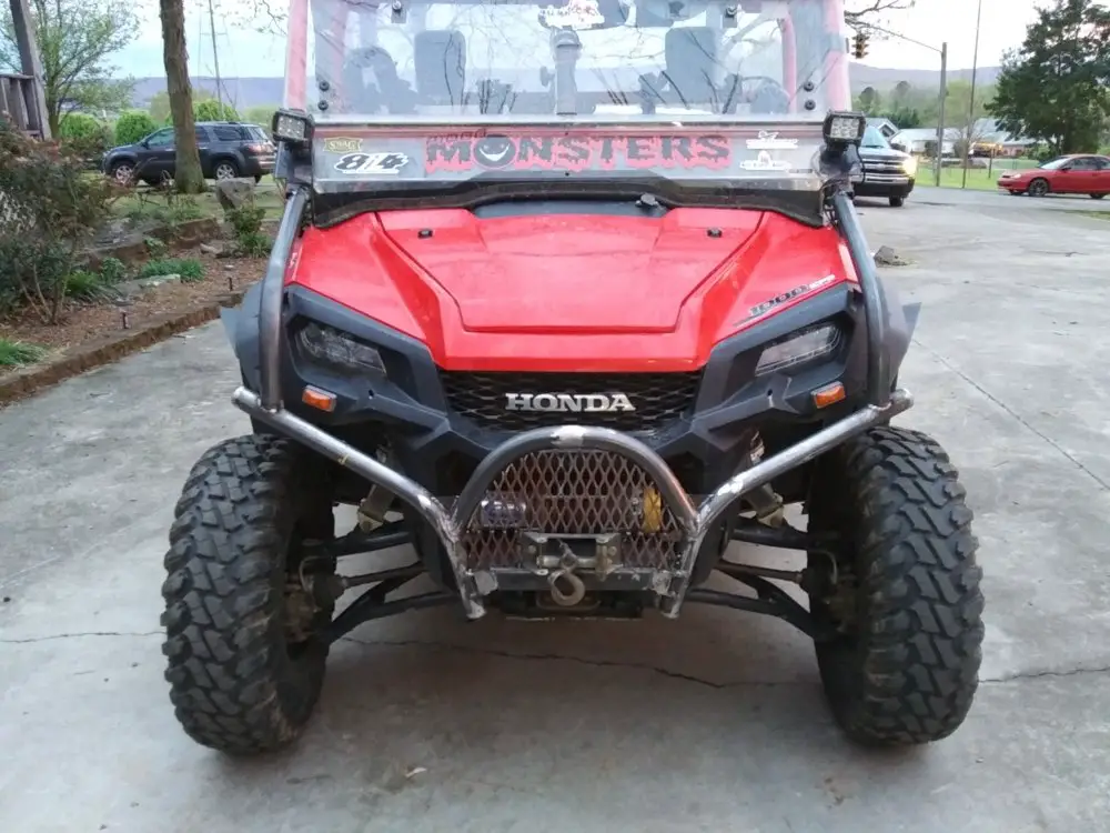

New bumper version 2.0. Learned alot from first one. Reinforcing 2 mounts before removing to weld. Also boxed them in beforehand which lets me get rid of splatter alot better. Did same with tubing. Live n learn i guess.

What are you going to do for a skip plate to protect the lower bumper frame mounts and front diff?

Bash plate similar to one on my last one. 1/4" piece of bulletproof tank armor lol
