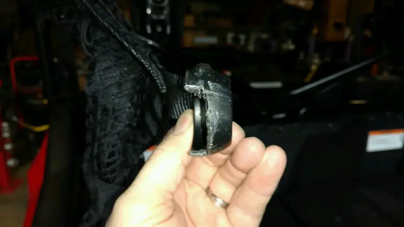

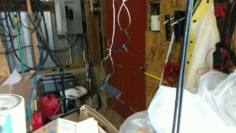

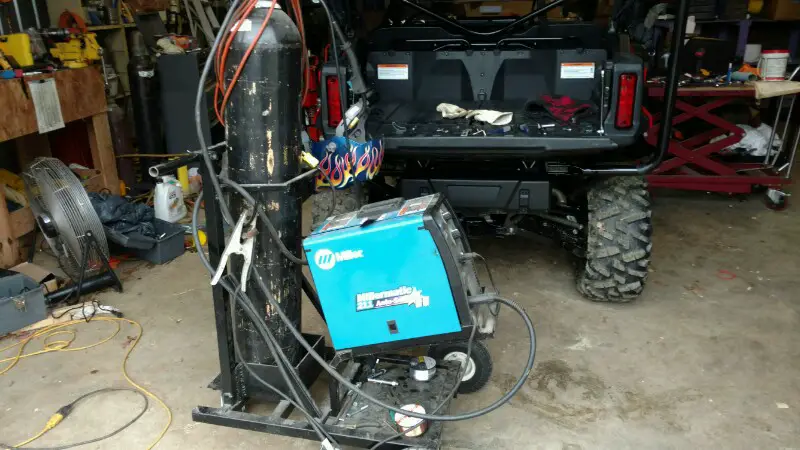

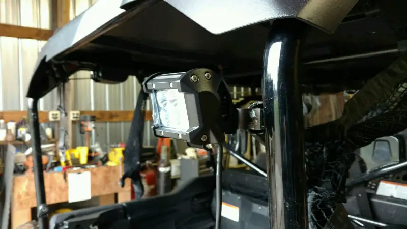

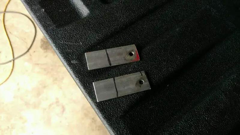

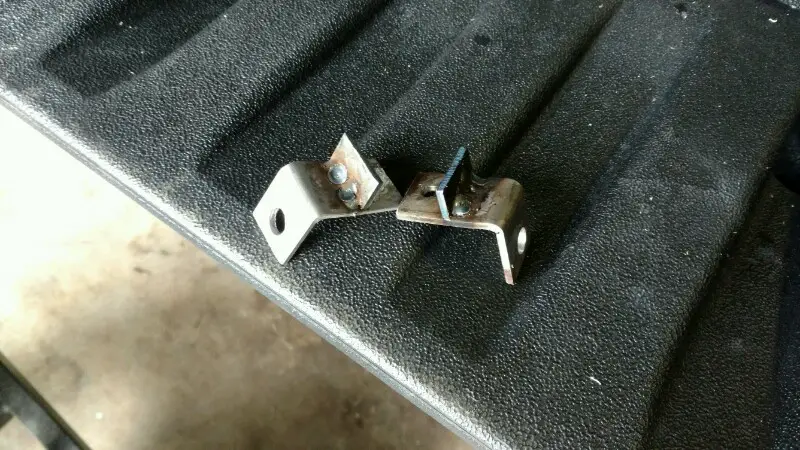

Got my rear lights mounted. Below is a series of pics from start to finish. Maybe it'll help somebody having trouble finding a place to put them.
IMG 20160303 121249330 800x450
Here's where it all started.
IMG 20160303 122254815 800x450
Had to cut away part of the plastic on the net holders. That way they'd sit flat like stock.
IMG 20160303 121235857 800x450

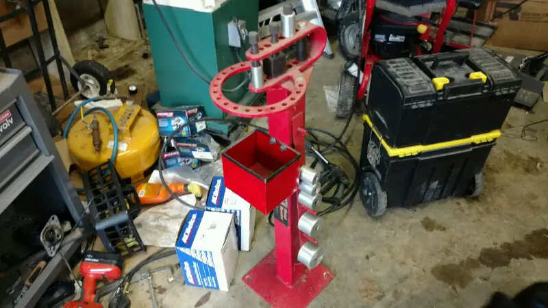

It would've helped if I could remember how to use my bender lol. It's been a couple years since I've used it. A hammer and vise works, but this thing makes sure everything is square.
IMG 20160303 124058036 800x450
I welded a stop plate to each one so bracket doesn't start swiveling if bolt loosens.
IMG 20160303 124121000 800x450
My favorite shop toy lol.
IMG 20160303 130912825 800x450
After installing everything, I took it back apart for paint. I'm pleased with the results.

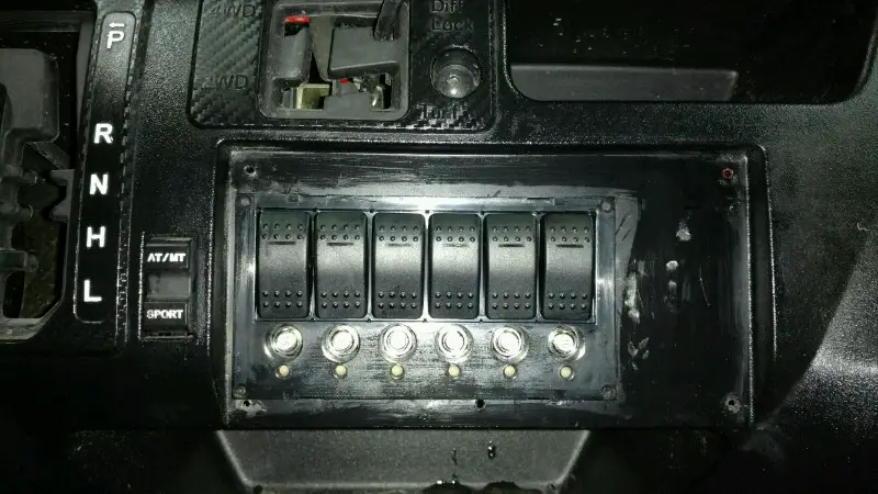

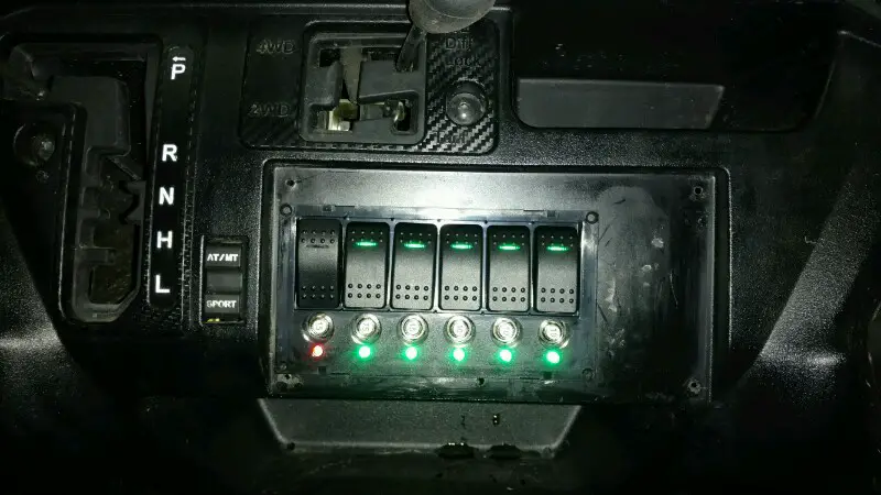

IMG 20160303 183606576 800x450
Made even more progress this evening. Individual wiring will have to wait til when it isn't so cold lol.

I really dig the circuit breakers. Easy to get to and no screwing with trying to find a fuse.
I thought that was a good idea. Can't remember who made this. I'll go over my old emails and find out. I've had too many boxes delivered lately to remember who made what lol. I ordered couple of limit switches today for my interior lighting idea. The lights will come on when door is opened like a car. Or turn them on manually with a switch.
