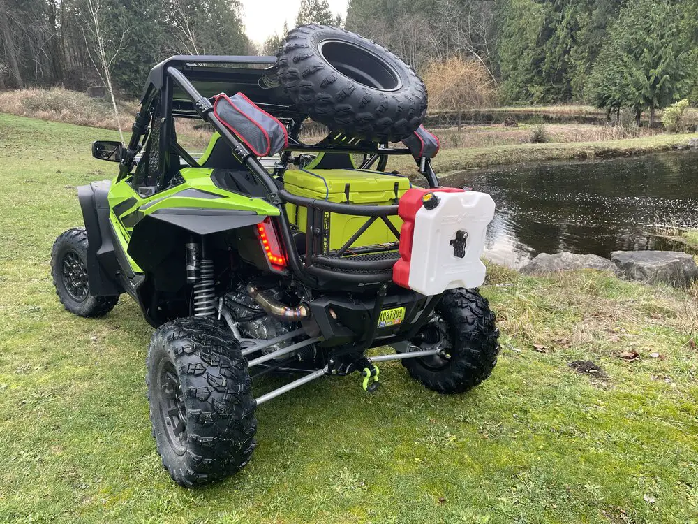

Talk about a picture worth a thousand words. Now anyone have a picture of a low mount? Will all this fit on a 12' trailer?

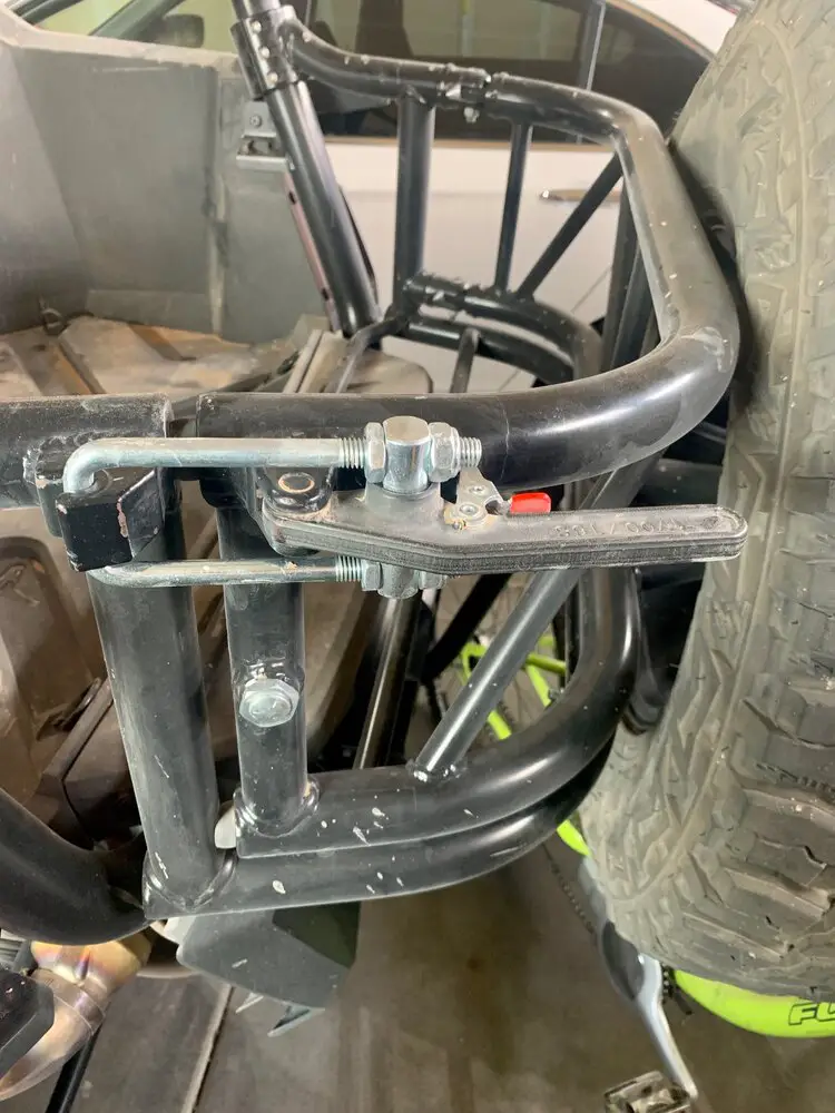

Mine is in the low position and with 30's it clears some pretty aggressive stuff. Completed Moab Rim with it no issues at all and if you've every ridden that trail, you may never again with a Talon on 30's. I also modded the latch system and added rubber bumpers to mine. Love it this way. No rattles and easy for the family to open and very secure.

I love the adjustability of that latch, make it as tight as you want it. 👍

If you flip that spare you'll carry the weight of it a bit lower.
Haha, I was wondering how long it would take for someone to see that.
You are right but the way it is now I can access the cool without having to take it out of the back. I’ve have not noticed any difference with it flipped up that way.

Love the look, those 2 bars on the bottom going vertical from the frame to the tire carrier are those the extended metal option on the drf website? Also did you go with the high mount or low mound, looks like a high mound.
How much did it help with the bucking? Planning on getting a live valve model i wonder if would be a problem with the extra weight in the back.

Many of the places I ride across the country, I find myself off camber quite often. I would think the extra tire so high might make it a wee bit top heavy. I do like the rear mount with rotopax. I’d eventually like to find a spare tire mount for the 1000 that sits off the back. Nice looking rig sir.

I’m newish to this hobby and off cambers pucker me right the hell up!!! :oops: With the aftermarket wheels, I’m a fraction over 70” wide and hope that helps. I do NOT want to tip ‘er over. 😭 Honda says the Talon R is good to 37.3* but that’s a static number - add in the dynamics of a bumpy trail and yer guess is as good as mine.:eek:
