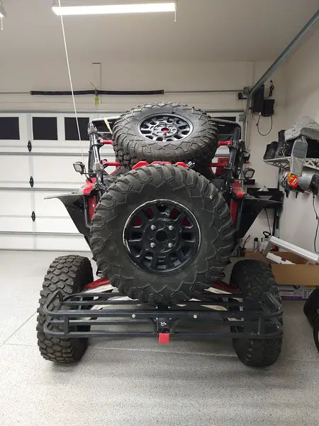

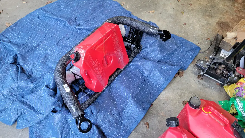

My DRF extender arrived yesterday, I forgot to grab a pic of how it comes neatly wrapped up in a shipping blanket, using foam and rubber pieces to protect ends, then tightly shrink wrapped. Despite the careful packing, UPS still managed to damage it. :mad: The one thing I can count on is receiving damaged goods from UPS.

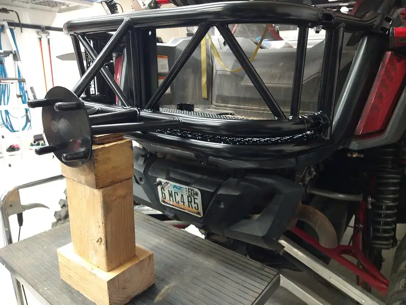

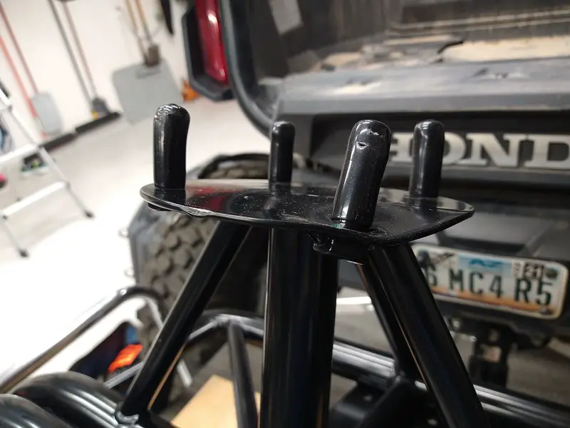

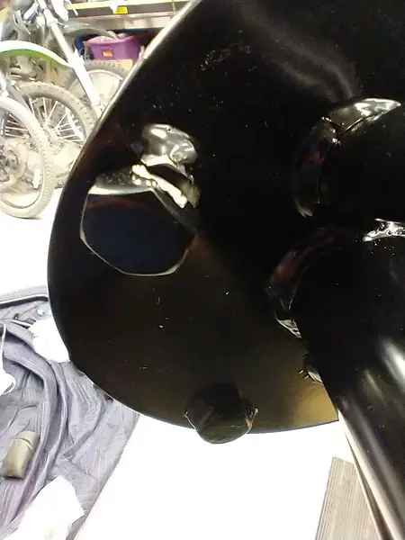

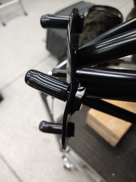

The spare tire mount, despite being heavily padded in foam, is where the damage occurred.
The force of the drop broke one side of the tack welds on the wheel stud.
There's no way I want to wait any longer to rectify this so I just got out a couple of 15" adjustable wrenches and tweaked it back the best I could.

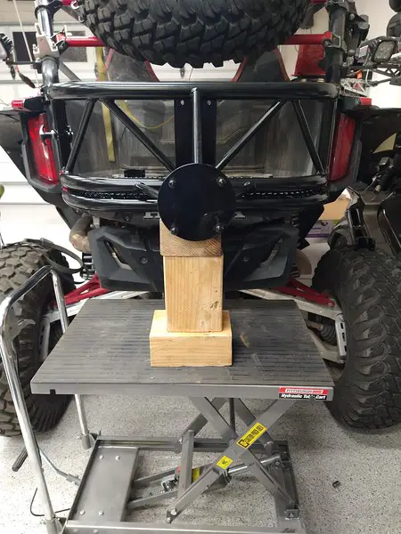

I have a hydraulic lift table cart that made getting the bed extender into position pretty easy by myself. You can also see that I was able to get the damage mostly straightened out. I gave it the final tweaks one it was fully mounted.

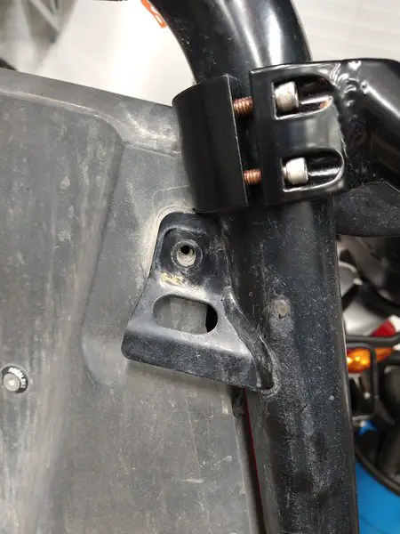

The instructions call for approximately 1/16" clearance of the roll cage clamp about the factory bracket. I applied some anti-seize compound to the bolt threads. I had to remove the bolt (as suggested by DRF in his online installation instructions) from that bracket to get the back halves of the cage clamp on.

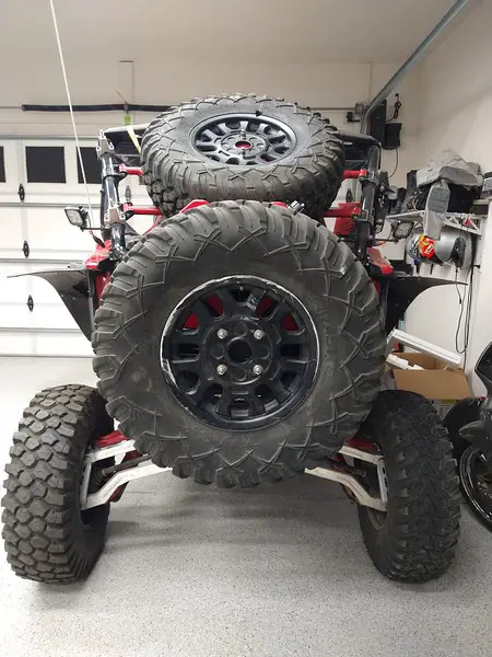

After some final tweaking (not twerking) I was able to mount up the spare.

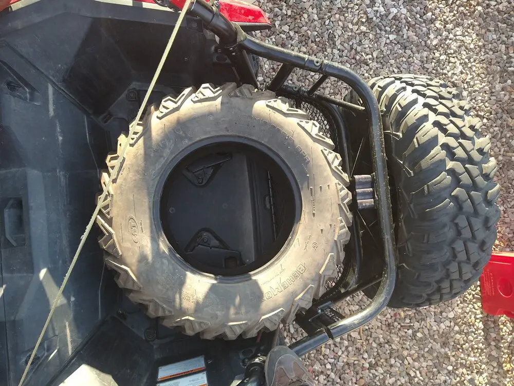

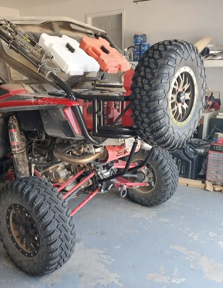

Just to see if it would fit, I tried to install my cargo carrier. It's close but it fits.
I don't intend to run 2 spares often, just on multi day trips or when I think I may need it. Glad to have the option and I'm very impressed with the quality of the @Dirt-roadfab bed extender/spare tire carrier. Now I need to go get re-sprung for all the added weight!

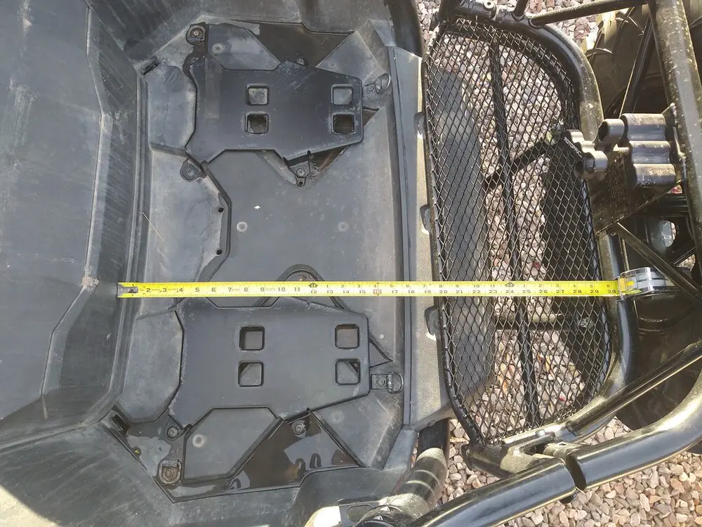

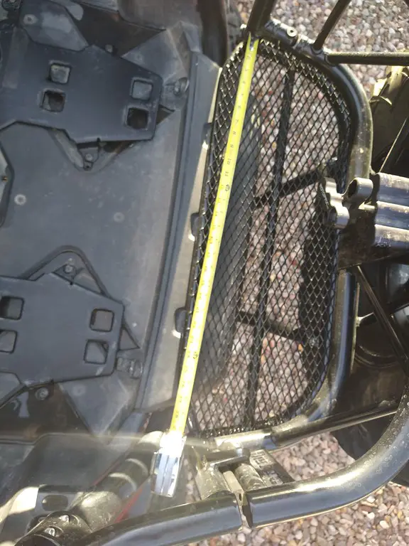

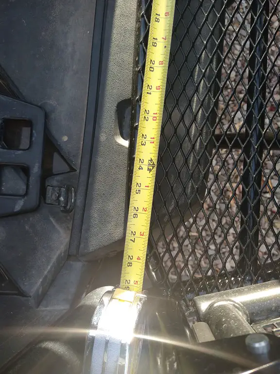

What's the actual interior dimensions of the bed with this extender on?
Thx
Lil_Steve
Lil_Steve
May 22, 2019
544
2,109
Gilbert, AZ
Thx
IMG 20210425 181528289 XL
IMG 20210425 181645142 XL
IMG 20210425 181648253 XL
30x10x15 tire for reference

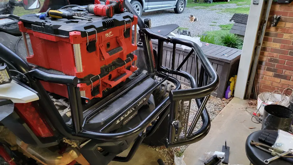

Monday I drove up to DRF to pick up my carrier/extender, as he's only about 3.5 - 4 hrs away from my home. After seeing what UPS did to other's, I figured a little bit of time and gas was worth it. Jared is a nice guy, who took some time to chat as well as go over the features & benefits with me. Last night I installed it, the fit & finish are outstanding; this is some quality powder coating. I was expecting some problems mounting it up since I have a JEI fuel can rack also mounted to the cage and expected that to have possibly moved stuff out of alignment. That, or the two years of bashing about the trails for thousands of miles.
Fortunately, this is well made, and it dropped right into place. The only (very minor) issue I had was getting the back half of the bar clamps in place between the cage & plastic. I loosened the bolt shown in his instructions, gently pried the plastic away, and love tapped them in place with a small deadblow hammer . . . easy day.
One important note, the Rotopax cans with the silly twisty locking bottoms (seen on my REI rack below) will not fit on the carrier, the twisty bottom thingy will hit the rack bottom when you try to close it. I don't think this is a DRF prob so much as it's a Rotopax dumb move to make those cans taller than all the others. The 3 gal gas can you see in front of the tire in the pic below fits fine.
Thanks again Mark. RotopaX did make changes to the Gen 2 two gallon can which allows it to fit as well as the three gallon.

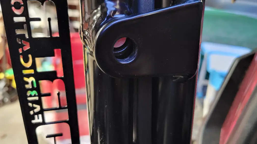

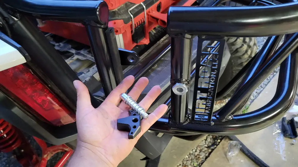

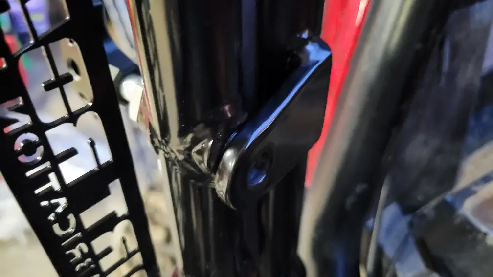

Finally got around to installing mine last night.
Looks well made overall just got to figure out a few things.
Any tips or tricks to get it aligned so the pins hits properly. It about takes all my weight to push it down to latch it.
It seems to be related to ROPS variations but I cant seem to get it corrected.
Also the handle unscrewed while turning it to get the pin to come out.
I haven't reached out to them yet. I plan to this weekend for suggestions. View attachment 344120View attachment 344121View attachment 344122View attachment 344123View attachment 344124
Mine was aligned correctly with the spare tire was mounted on it but when I remove the tire it is safe as you described. I have same plans for mine when I ever get some time

Mine is fine with or without the spare. My only suggestion would be to loosen the clamps to the roll bar, then close the gate and tighten the clamps back & forth, I'm guessing you just have some twist in it from mounting
18,576
67,685
Ya, I'm on my 7 attempt finessing it.
I may end up altering the latch catch.
