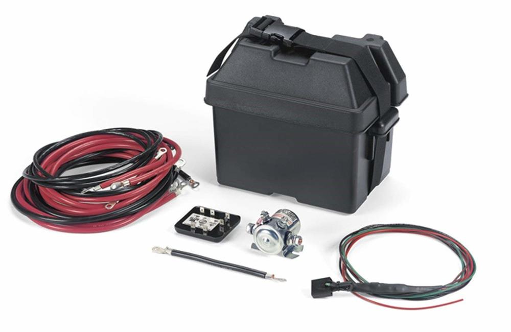

I installed the Warn dual battery kit on my 500, 2 years ago. It worked fine for a while, but now it only charges the cranking battery and no matter how hot it is, never sends a charge to the #2 battery, even when the main battery is showing full charge it still send all power to it. I replaced the SOLENOID RELAY with no change. I've looked for warn part # 80110, the black plastic part between the wire and solenoid in the picture and can't find it listed anywhere, not on Warn's web site or any parts places. I get inconsistent reading from my volt meter when checking the one on my 500 and after running all the connections and replacing the solenoid it's about the only thing left to try, if I could find one. Anyone else have an idea or guess to what could be the problem?

My guess is the second battery is dead. Pull it out and have it tested or try putting a charge on it. I have a second battery under the seat and just have them wired in parallel. An isolator really isn't needed on the P5. Good luck.

I put a new #2 battery on it, if I charge it manually it works fine, just won't charge from the 500's system. It did work for about a year and a half. When I noticed the battery was too low to work the winch I put a new battery on it.

Gotta be that isolator then. Voiced my opinion of them a few times but some guys swear by them. Sure would suck to be stalled out and trying to winch out of a hole and your second battery dies. That isolator wouldn't allow you to pull from the fully charged battery. @lee pointed out that the P1's have issues if the voltage drops too low, so maybe a manual one. It's not needed on the P5 though and it would have to be something pretty demanding to drain two batteries. Chuck that isolator and carry a little Noco. Just my 2...:)
