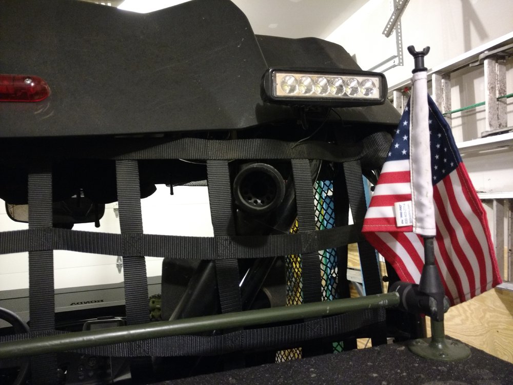

My we see a pic of it?? Please
If i put my arm by it when looking back to back up she starts flapping my sleeve if its close:)

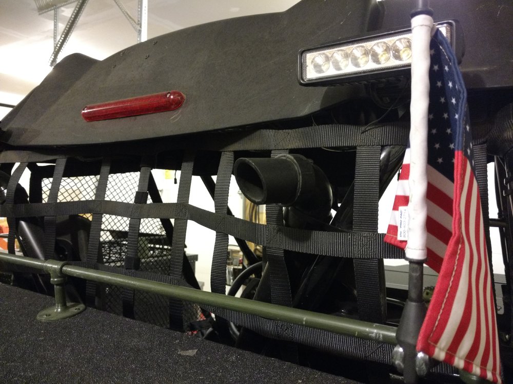

And pre snorkel..also about 200 miles or so here.

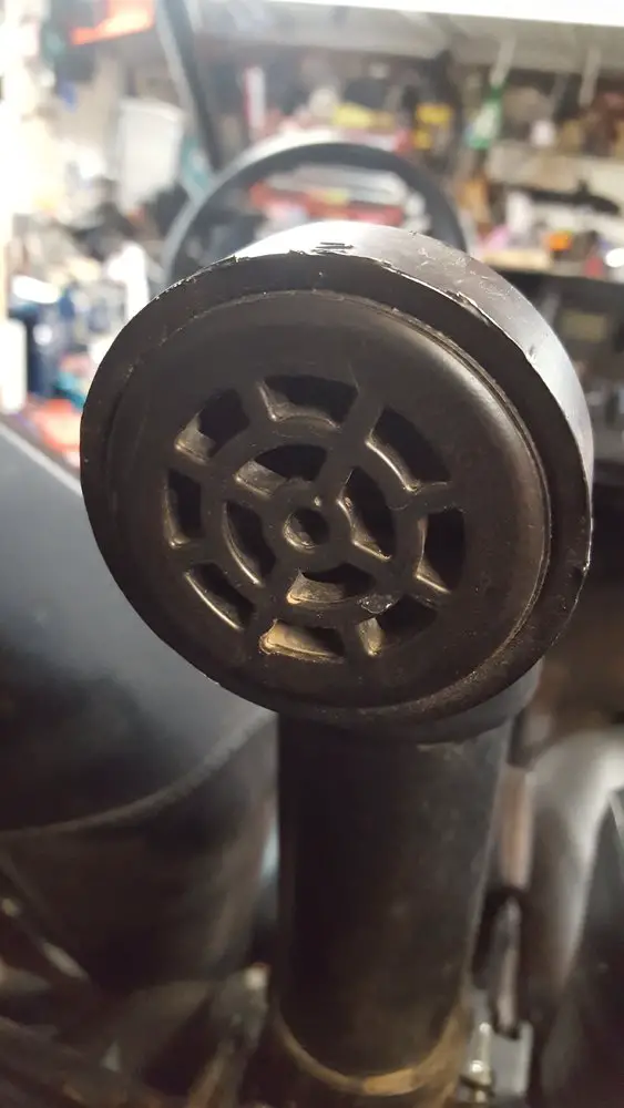

Its a screen/drain cap piece. I believe it fits the id of the pipe so i had to cut a piece of pipe the length of the collar on the 90 and then glue it inside the pipe and then inside the 90. I dont recall for sure but i think that was how it was.
Just an idea, cut a small piece of pipe at an angle to fit in the last 90. Gives it a hood so water won't just roll in. Used drain covers for mine too, fit in the 90 so small pipe piece holds them in. Opened them up a little in the centers with bigger holes.
