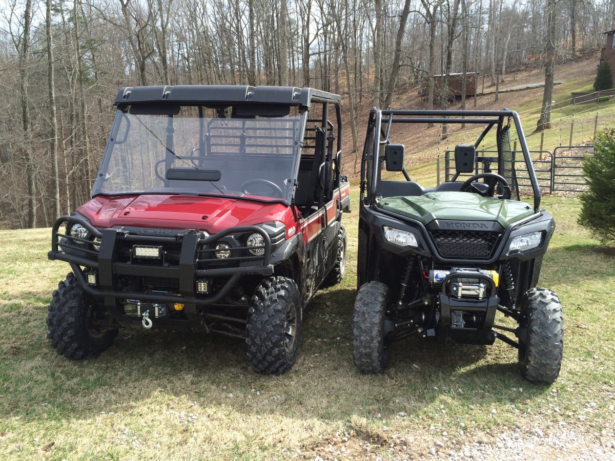

If you look at the windshield on our Mule you will see the black vent in the center and two more on the top of the windshield (above the driver and passengers head) - if you pop them open it lets some air go through and really cuts down on the dust. Really nice design and a good idea. Cant see why you could not add something similar to another brands windshield.
IMG 0784
32,050
take a look at this which is basically how your windshield is behaving at speed.
The Air flows around it and creates turbulence and a low pressure area behind it. It pulls the dust in. You need something to break up the airflow/turbulance... i.e.:back panel.
OR a vent to allow airflow to the middle of the turbulence.
