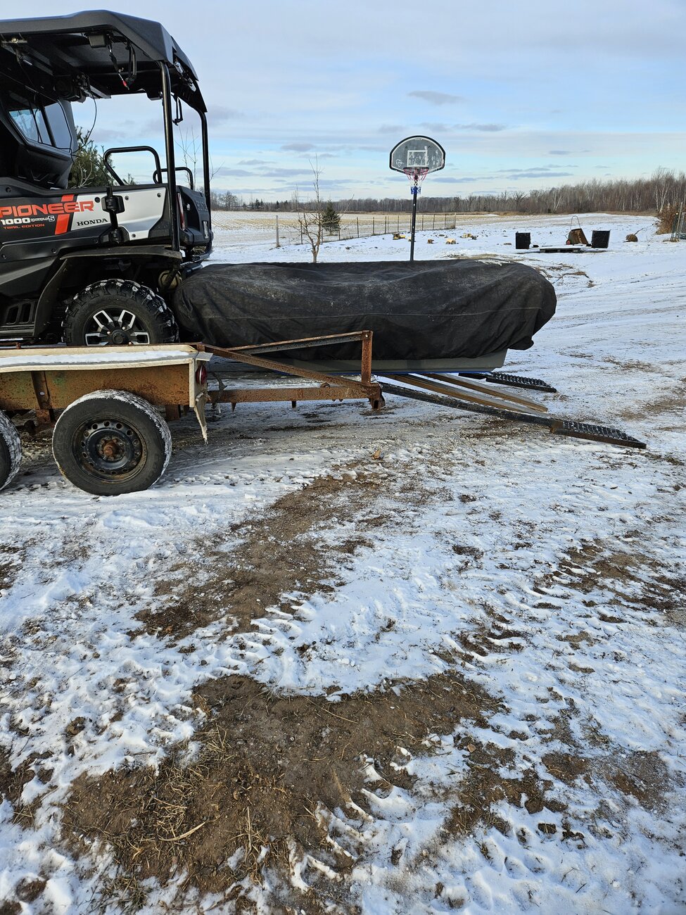

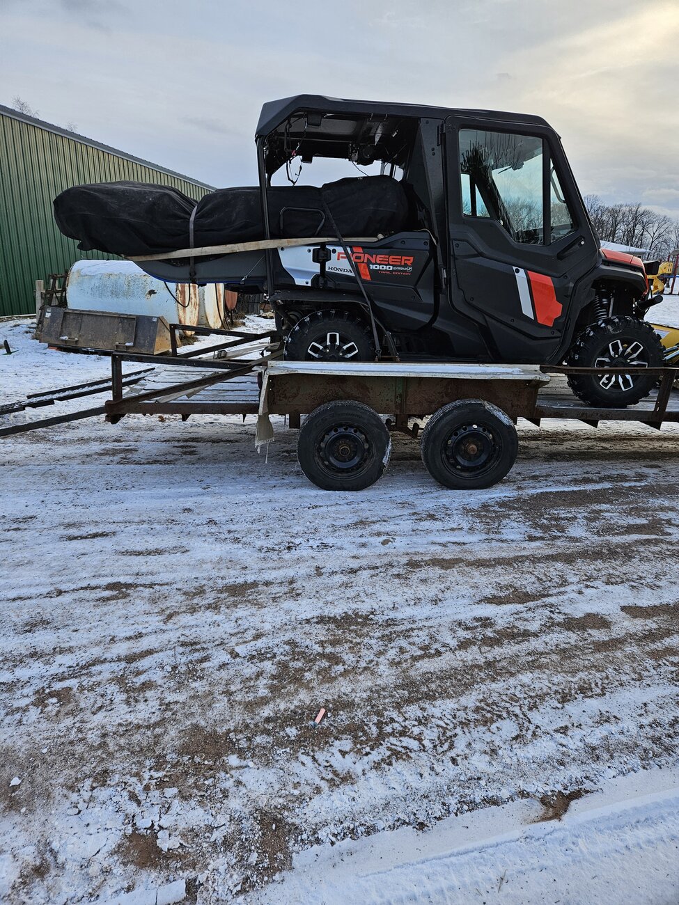

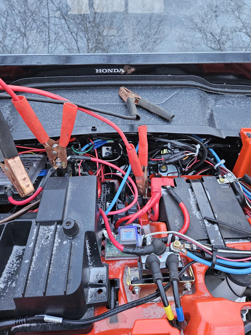

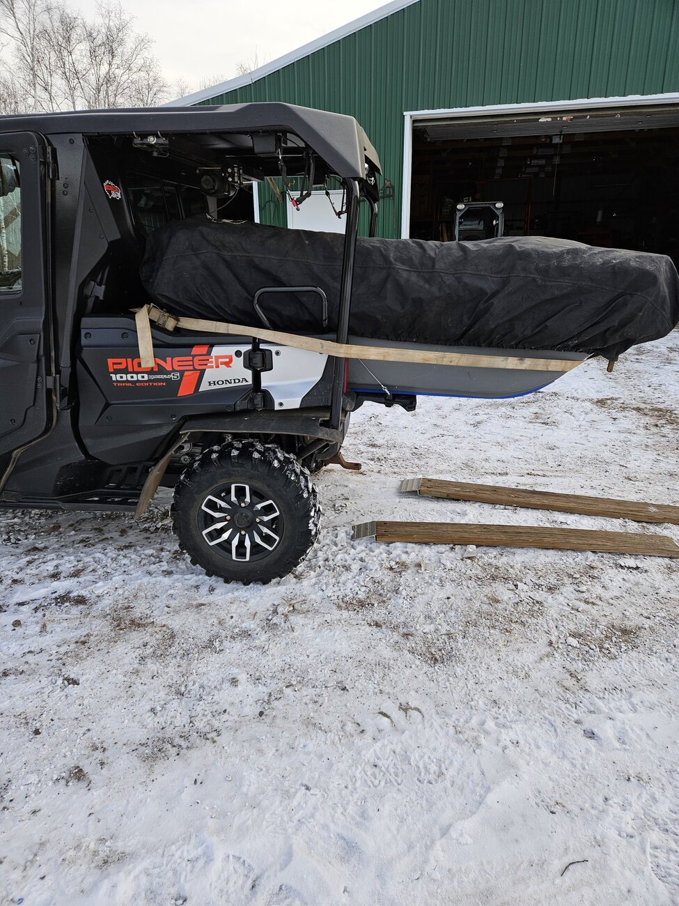

Had a rough couple of days. Had plans to go ice fishing finally and then discovered I measured wrong and everything wasn't going to fit on my 16 ft trailer. I was pretty sure it wouldn't fit in the bed of the pioneer but tried it anyways, and lo and behold it did. I used ramps to pull it up with the rear winch. Thought my problems were behind me. I got to the lake this morning and everything had sat out overnight and it was -7 when I got to the lake and found my stinger relay failed in the extreme cold. Cole hersee on order! Found some jumper cables in my truck and rigged them up so I could use the heater! Left the hood off until I got onto the lake. Caught 2 largemouth and 2 small pike. Then had something come in to my bait really quick and before I realized it, my pole was going down the hole. I reached in quick and went up to my shoulder down the hole but couldn't grab it.

Looks like an eventful day!
You could rig one of these up on the pioneer and make the load super stable.
View attachment 415393 View attachment 415394 View attachment 415395 View attachment 415396 View attachment 415397
That LM has some pretty good color for being under ice. I fish out west and my deeper fish in winter and early spring are almost as white as a paper plate ....
Yes I may need to,my 12 y/o suggested the same thing actually. I'd rather have an 8x20 enclosed trailer though!

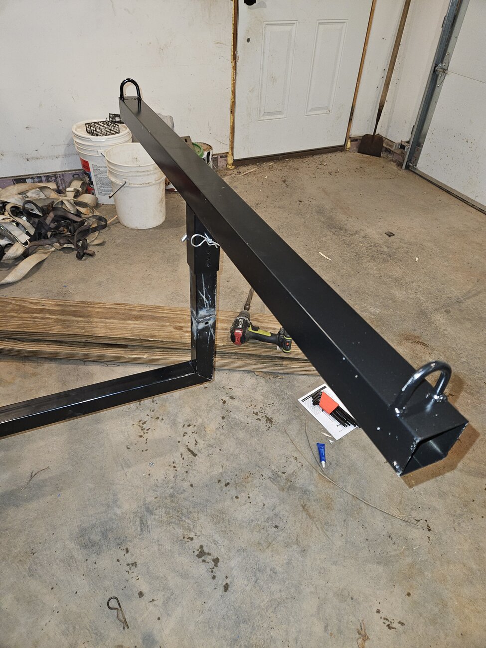

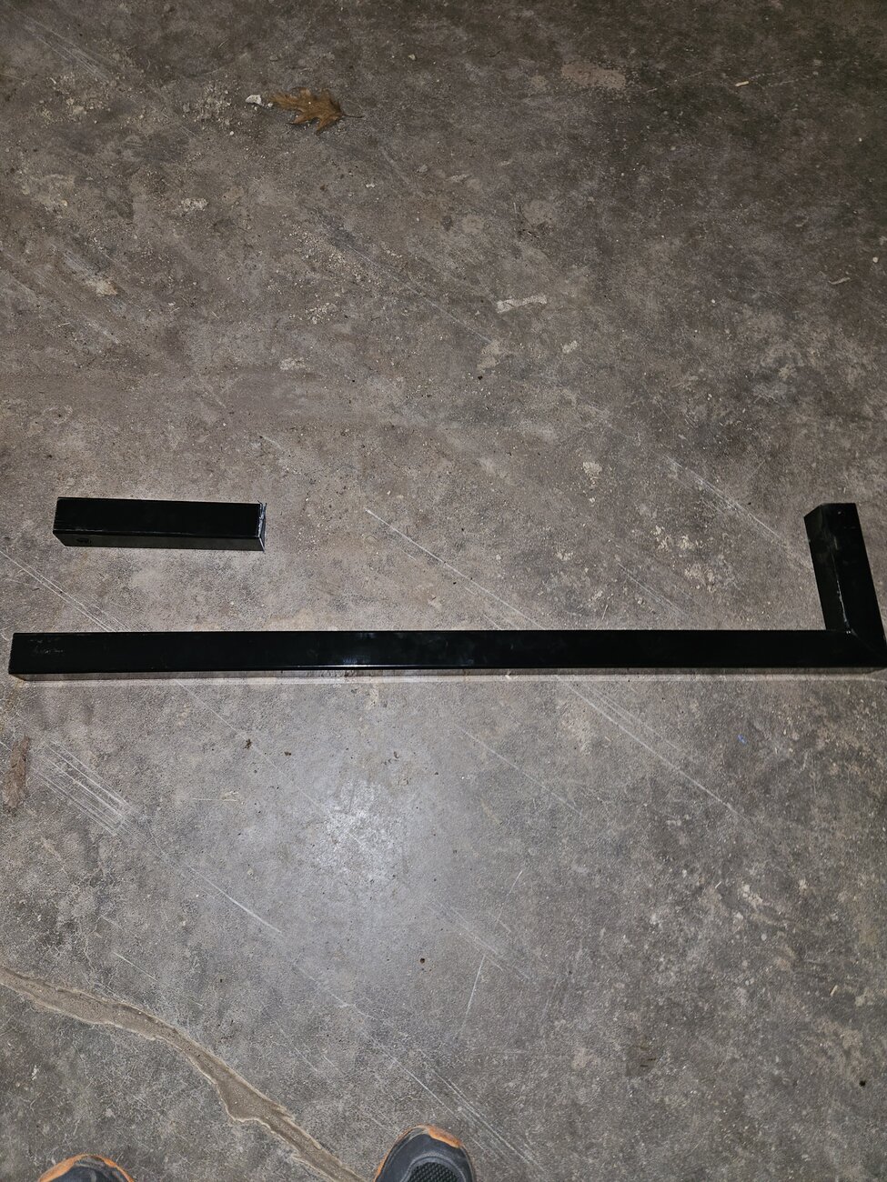

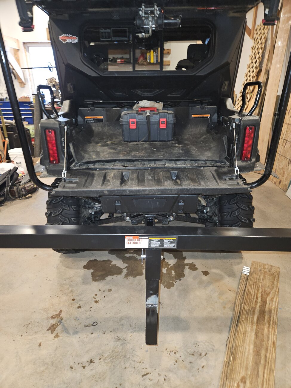

Thanks for the link to harbor freight @Robobrainiac , went to harbor freight today and picked one of the hitch extenders up. Not sure what kind of trucks it was made for, but not most modern trucks. The up/down height was about 10 inches too short and the overall length was 10 inches too long. So I cut 10 inches off the tongue side and welded it to the crossbar upright, drilled a new pin hole for the hitch and , within about 15 minutes was all done, minus painting the weld. For $60 it wasn't worth trying to make my own. Set the overall length so that I do not have to take my tool box out. This will be a much more stable and secure solution than what I had going on.
20240121 151133 20240121 153323 20240121 153337
View attachment 415624 View attachment 415625 View attachment 415627
Super Awesome!
