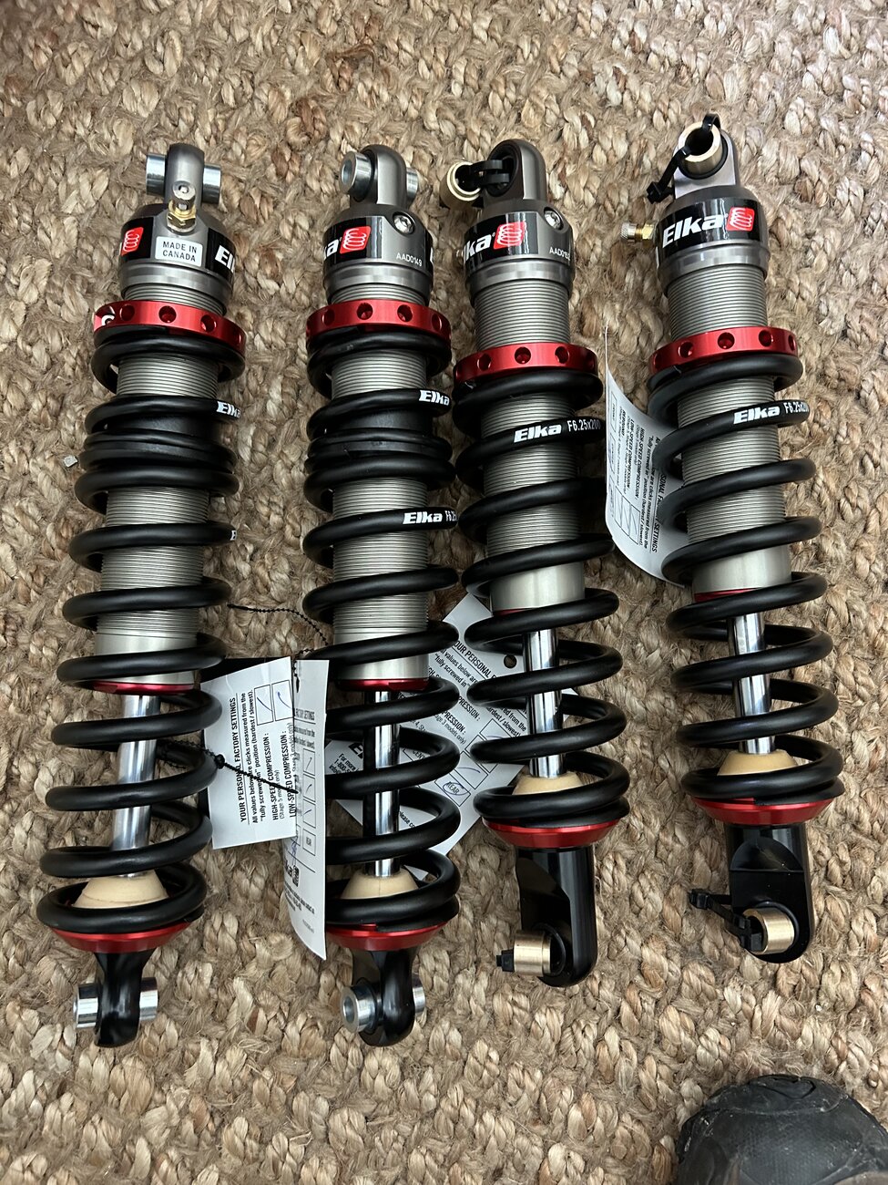

Finally pulled the trigger on stage 1's Super excited. Well my back is super excited once all of this snow melts and can test them out! I have to say they look amazingly well made. Almost sexy even. Thanks for everyone who chimed in here

You will like them!
