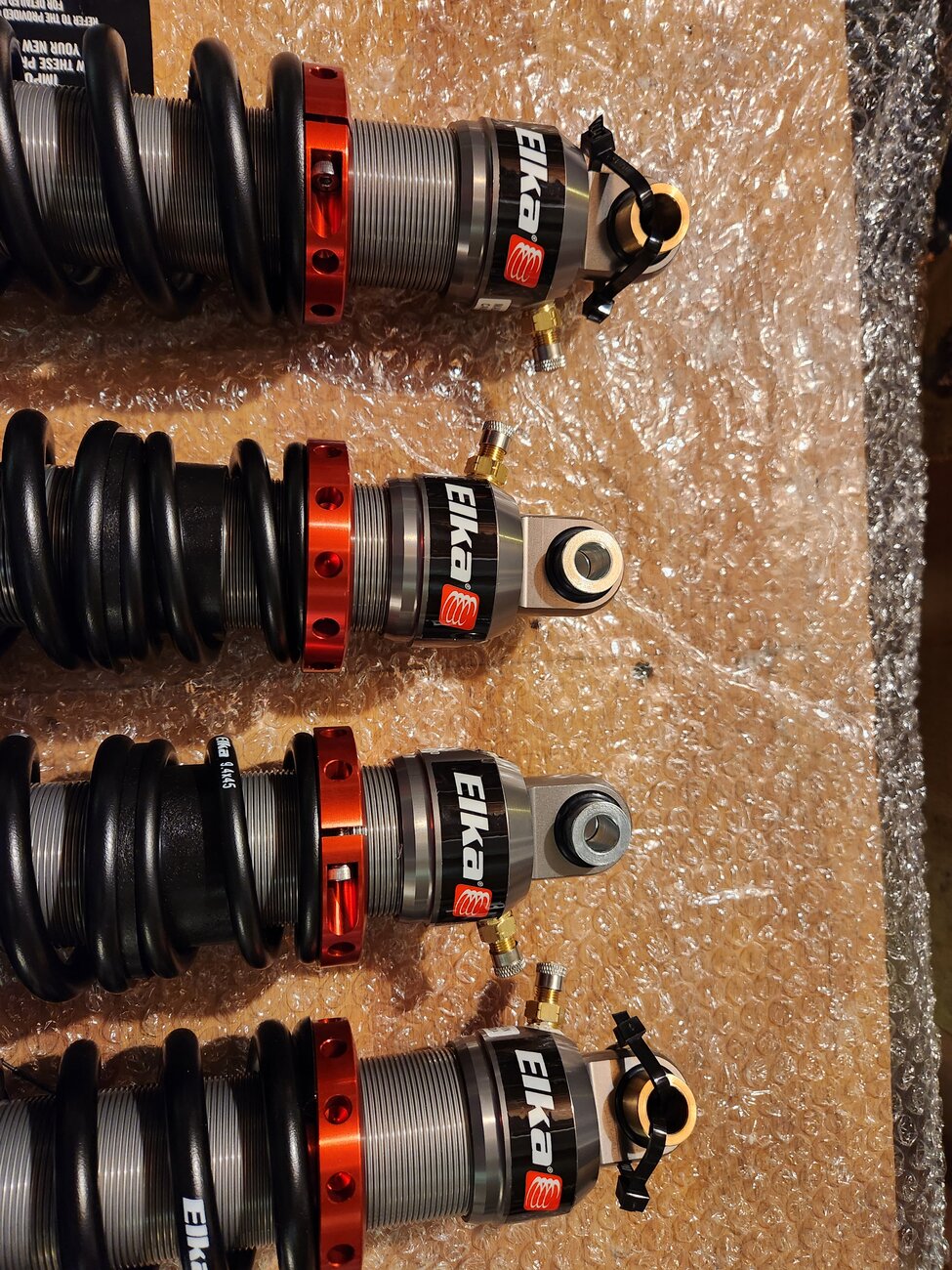

I ordered these back in August. They just arrived today;
F839913C E41B 49A8 948A EE43253840D7
I went back and forth considering the WE vs Elka’s. I’m sure had I gone with the Elka’s, I would have already been enjoying them for months, lol
Hopefully these will be worth the wait.

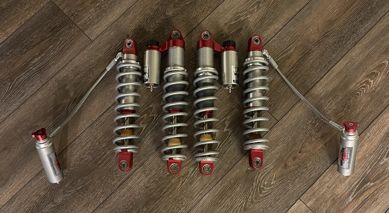

I just bought a 1000 5 unit.
69647608191  562BB9E9 AE46 4FF9 967B DF534A3DD67C
Looking to upgrade shocks right out of the gate. Has anyone purchased or looked into the John Hester edition Elka Shocks? I called the customer service team at Elka and they told me to contact Hester Motorsports in New Mexico. John Hester takes the Elka shocks and does some custom tuning to them...Check out his video on the difference on stages 1-5. Please let me know if anyone has dealt with John Hester when purchasing your Elka shock set up.

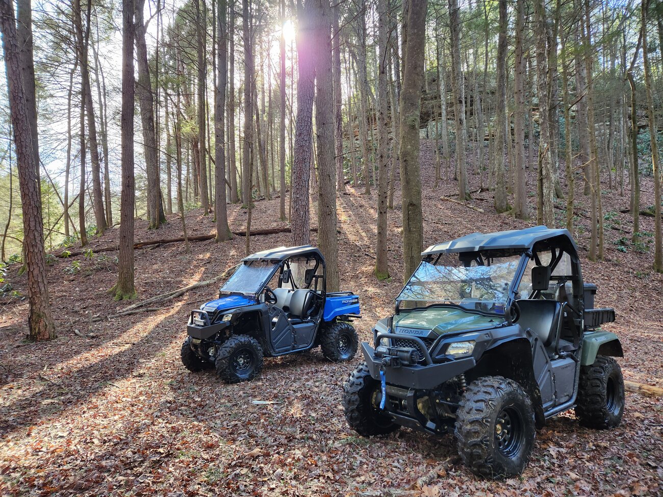

Test ride this afternoon . . .
The difference is dramatic, especially with my 8 ply HTRs. Definitely no regerts, not even one letter.
With power steering, torq locker, 27s, proper skids, winch, roof, windshield this is a trail version of the P5 Honda could easily release/market without having to introduce a new model.
Me and @KYgal83 took out Critter (new shocks) and the 520 with her tires/rims on it (5+2 wheels with 25.5" Bighorn "27s"). We swapped buggies occasionally for comparison. She ended up driving Critter more than I did, but we agreed the ride was very much improved and worth the purchase. I do still feel like these things shouldn't cost +/- $1K though.
The stock shocks are like the guilty Catholic girl, or the prim Baptist. They'll go out with you, but don't expect much to happen. There will be stiffness, resistance, reluctance to get into it. They're there, but they're not much fun. If pushed, you get nothing but push back. Expect an uncomfortable outing.
The Elkas though, they're like the feisty redhead. They're engaged, involved, moving and having fun along with you. When pushed, they react with enthusiastic responsiveness. After the ride you'll say: Well, that was fun!
KYgal may have more to add, but my takeaway was I'm glad I bought them. Looking forward to another ride on them . . .
