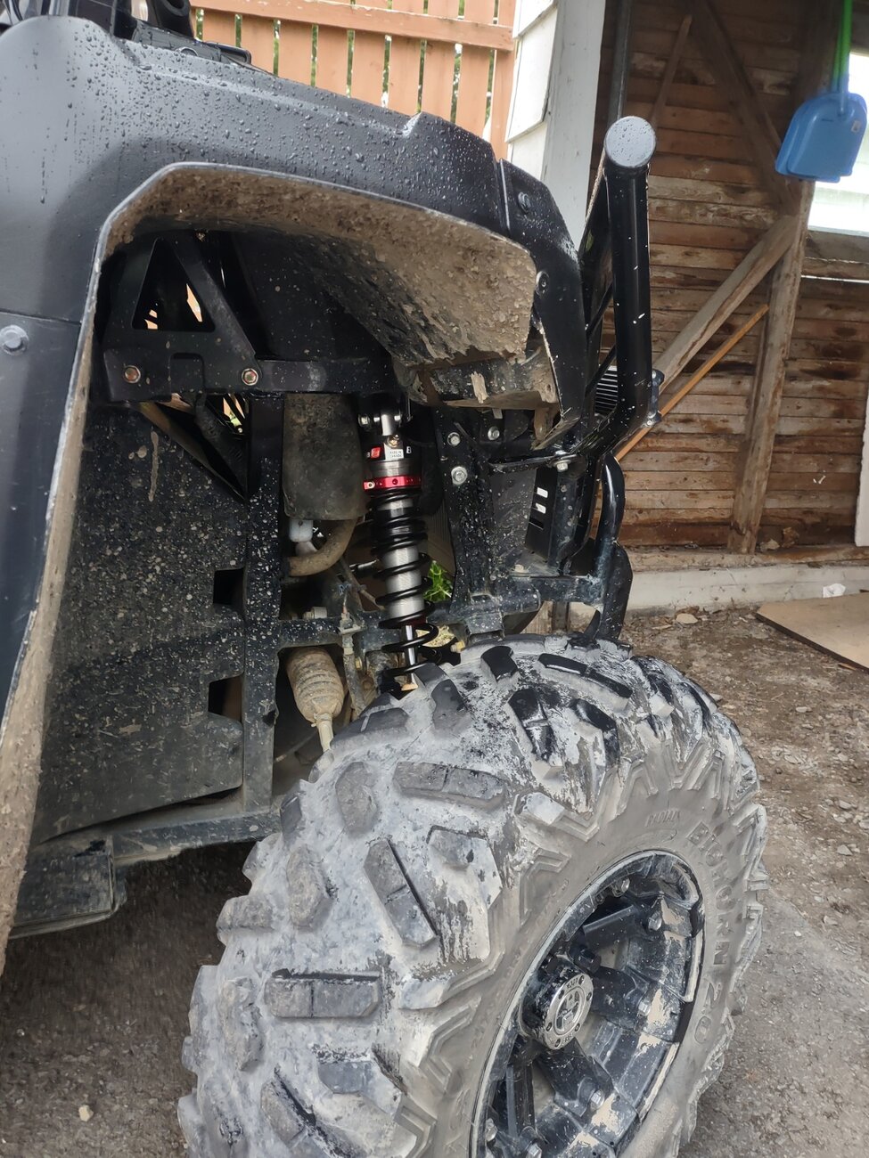

My Elka 1s (Front) just arrived today, installed them and toke a little ride in the mountain up and down to test them with my girl friend. It's totally another machine now, so smooth ! Cannot imagne what it will be once the rears will be istalled. Really worth the buying :)View attachment 350087
I agree, the transformation is dramatic.
