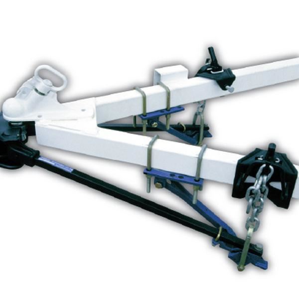

This is why I hijacked this post these will not fit a Vnose trailer I have one for my camper and tried to use it but there is no where to mount it on the tongue because the box takes up the tongue space.
I have a weight distribution setup on my v-nose.
It's a pain to hook up but it uses bolt on hook for the chain.
I use the tongue jack to lift the back of the truck and hook up the bars.
Hook looks like this:
RP58305 250
This might combine with a bolt on cam lock system.
If it's a steel tongue it will work, no idea with aluminum frame (can't afford one of those yet).
RP66084 37 250
Cruise e-trailer, see what they got, look at the prices then try playing with the tire pressures.:eek:
