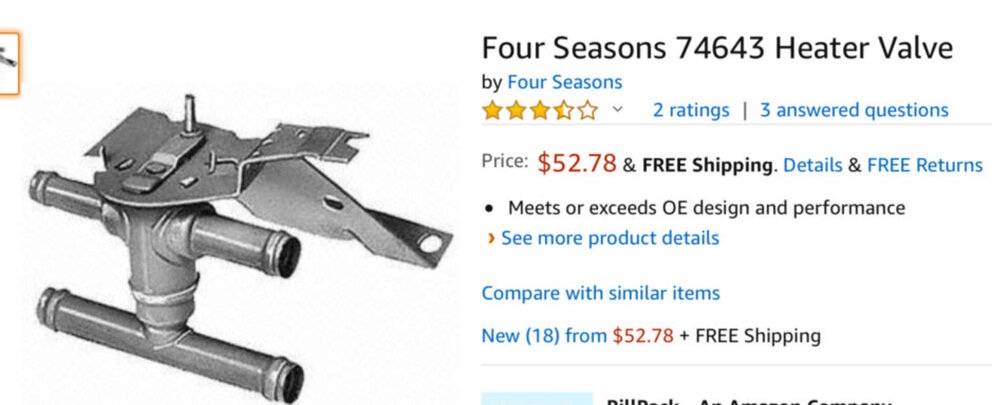

Using an adjustable flow valve like this? Maybe cable operated pull/push knob on dash, like the choke on my old FJ 40.
That’s the same valve I used when I made my kit. I used the remote engine thermostat and it requires coolant flow all the time in order to get the thermostat to open and close properly. My heater is getting water before the thermostat so it gets hot water all the time. This Valve allows me to bypass the water around the heater to control the cabin temp. Heater works pretty good when the engine is under load, it also helps to cover the radiator. Covering the radiator also helps with the cold air coming through the holes in the dash.
Reactions: Mudder
