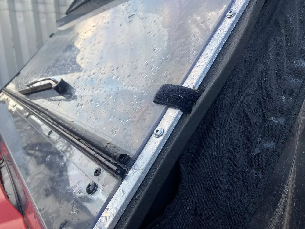

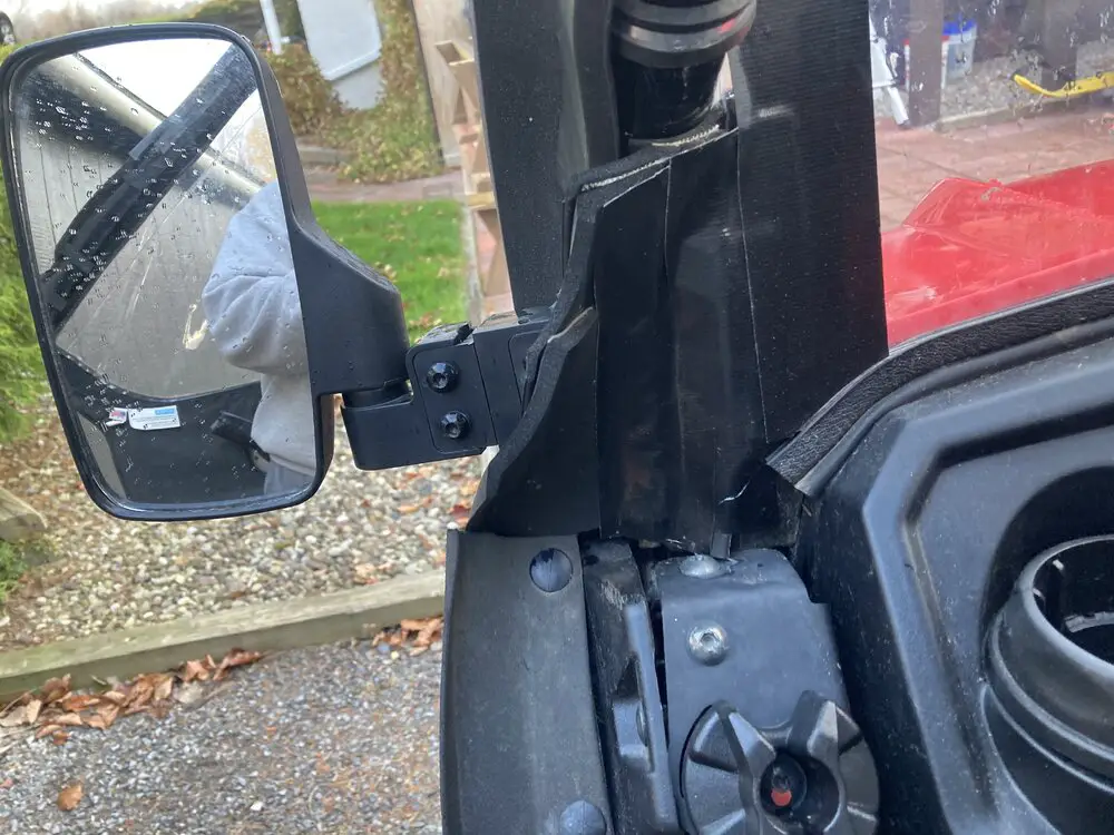

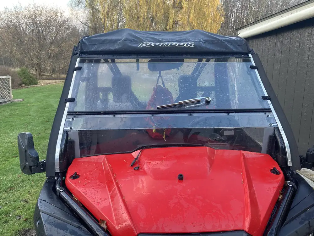

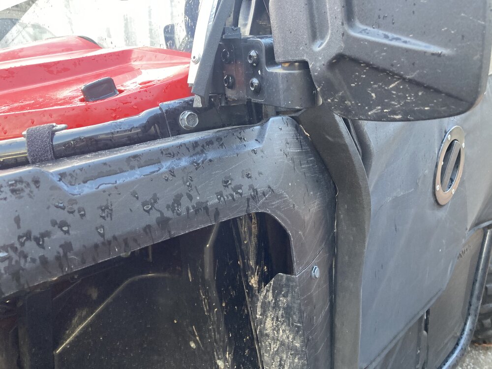

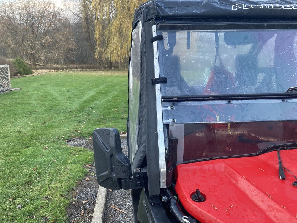

I agree with FlyingPot8oh in stopping the wind.
I have a full windshield with Honda full top and doors. When driving there is a lot of wind leak.
I made some wind deflectors out of garage door bottom seals.
They made a huge difference in staying warm.

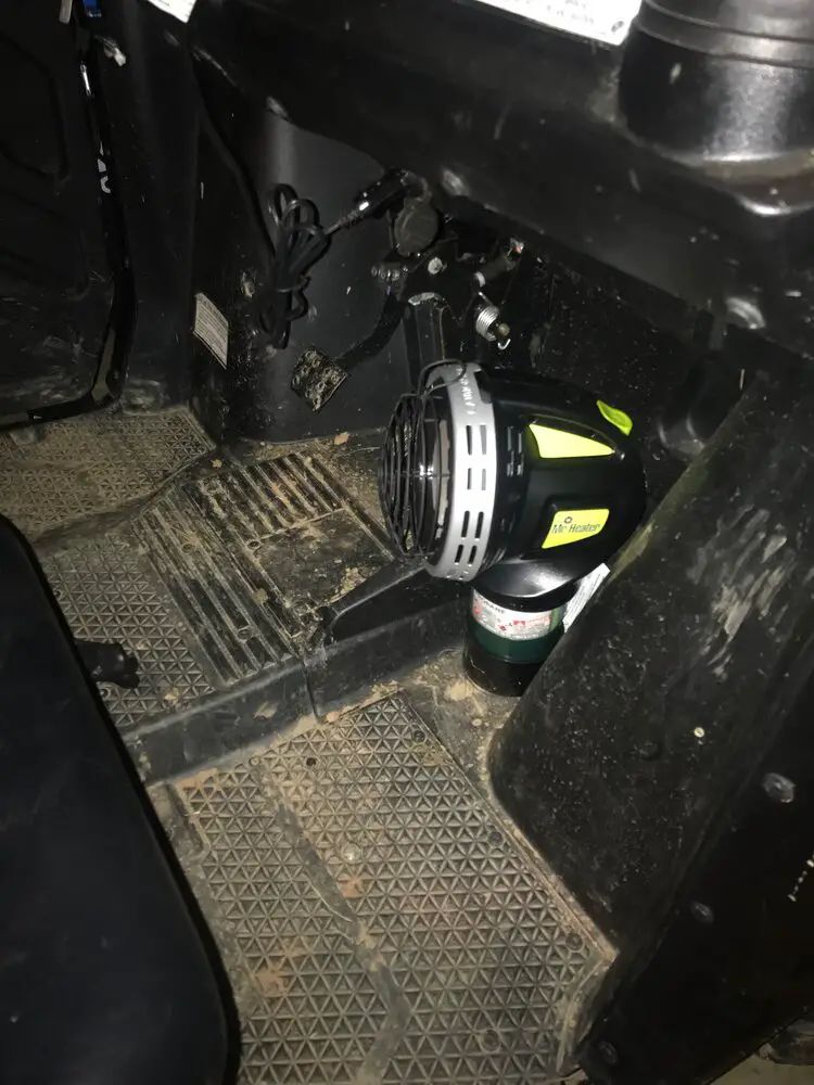

I have soft doors and use pipe insulation to fix the fitment issues especially by the hood with the non Honda windshield. I have a propane golf cart little buddy heater mounted in the passenger floor board and a 12v defroster on the dash.

Curious on how long a canister of gas lasts? Thx
View attachment 234857 View attachment 234858 View attachment 234859 View attachment 234860 View attachment 234861
