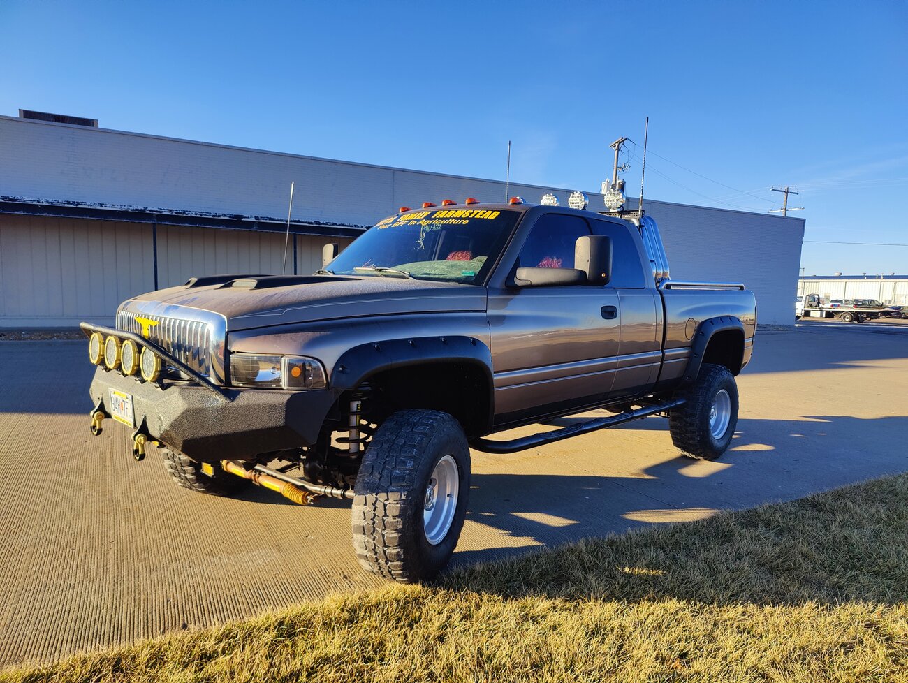

Truck Norris is officially up for sale. I can't drive 3 trucks and I can't justify 3 trucks. Especially when 2 of them are now cummins and much more usable.

If it's for sale why don't you describe it?
This was my wife's description she came up for it. She asked me what things I have done to it and I gave her a list. It is located in central MO. I am attempting to get $6500.

Thank you. The basics were covered in her listing above her description.
2000 Dodge Ram 1500 5.9L Magnum 4x4 Extended Cab Short Bed. Base model with crank windows and rubber floor. 190k miles.
We are selling because this truck just sits. It is rare I drive it since I got the black cummins. The black cummins is so much smoother, comfortable, and fast. Now that I have the red cummins the brown ram will most likely never be driven unless someone else owns it.

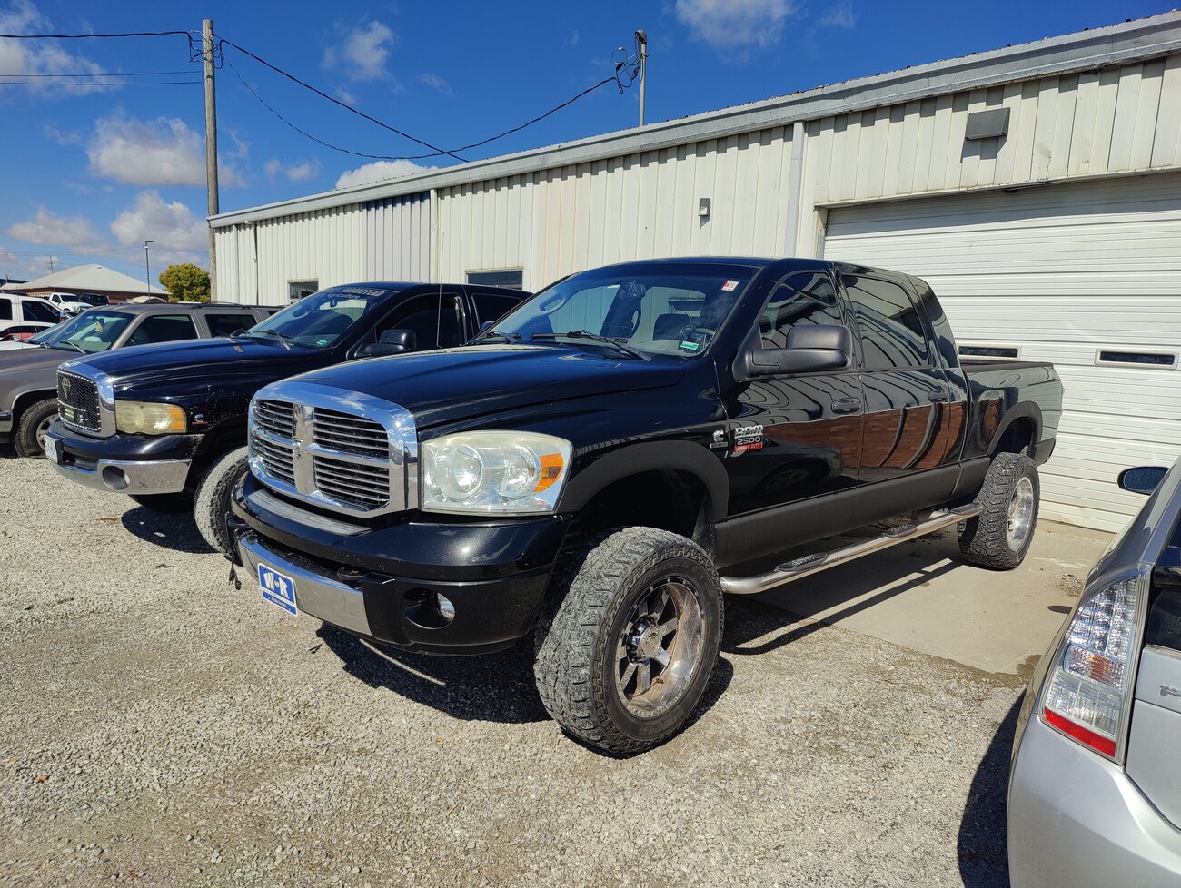

I will ask this here just in case someone might know.
Would anyone mind helping me confirm this injector? I assume it's a stock size Bosch. I got a P2146 this morning. I checked the injector harness and had resistance from end to end at 0.3 to 0.7 I checked the injector and have 2.7 between the leads. The other 5 injectors all read 0.6 this is a new to me used truck. I am being cheap on this one and want to replace the single injector. From what I can see truck is all stock except for aftermarket exhaust. 2006 dodge ram 2500 quad cab
I posted that 6 hours ago on cumminsforums and have not gotten any response.

I spoke with injectorsdirect.com today and they confirmed the number in the previous picture is an OE style Bosch but the guy said the way it is printed and laid out is consistent with many Bosch knockoff injectors. The nozzle size is most likely stock because he has not seen a knockoff injector yet that is oversized. So that confirms the injectors have been replaced at some point. I ordered a single injector from injectorsdirect.com and it will be here Monday.

what Cummins engine? It matters if you're talking about a 12 valve, 24 valve, HPCR 5.9 L or a 6.7L. If it were mine I would purchase a "6 pack" of rebuilt Bosch injectors from a Ram or Cummins dealer. They are not cheap but they are rebuilt by a Bosch expert and selected or calibrated to inject the same volume and spray pattern within very narrow tolerances. They come with a warranty if memory serves.
If the injectors are not balanced, they will spray different volumes of fuel, and may have a different spray pattern. Variances between injectors will result in a rough idle and could result in over fueling which can burn a hole in a piston.
Beware - there are many so-called or self-identified "diesel shops" around the country who claim to be capable of rebuilding injectors. They are most often bs artists. Cummins-Bosch injectors cannot be rebuilt to specs unless the shop has a very expensive Bosch test bench. Perhaps $100k or more.
As you read my post keep in mind - I am not a mechanic. I acquired a base of knowledge of Cummins engines in Ram trucks from owning three of them and putting a combined almost 800,000 miles on them along with being an active member of the TDR (Turbo Diesel Register) and reading the writings of genuine experts. I AM NOT an expert. So take my advice for what it's worth.
I had an old shipmate and friend a few years ago who bought a new '06 Ram 3500 after driving mine. Later, he experienced a rough idle when his truck had some miles. He called me and I told him to buy a $150 "fuel control actuator" which was a common problem in some '06s. Instead, he went to his local farm tractor diesel shop in Springfield, MO. Those clowns told him I was wrong, her needed a "rebuilt injector." They did not have a Bosch test bench but claimed they could rebuild injectors.
Not long after that he called and told me his truck was using more fuel. I warned him his tractor mechanic buddies had sold him a bad injector and it was over fueling and might hole a piston. Once again, he believed the tractor mechanics and bought another injector or a set of fake rebuilt injectors.
A year or so later, pulling a big fifth wheel trailer back from Colorado, he burned a hole in the top of a piston. That cost him thousands of dollars for a rebuilt Cummins engine and labor. And the icing on his cake was the tractor mechanics sold him another set of fake rebuilt injectors which caused a rough idle. He sold the truckd before he holed another pistonh.

I appreciate your advice. I do most of my own work. I used industrial injectors for my 03 ram. I went overstock size for more fuel on that one. I am looking at keeping the 06 ram stock. The injectorsdirect.com are labeled as authorized rebuilders on the Bosch website so I am hoping they do good work. Both trucks I have are 24v 5.9L cummins.

When I worked on them for a living I used a certified Bosch dealer. He also built my Ford 6.9 and 7.3 injection pumps, as well as the numerous 7.3 power stroke injectors I used.

A certified Bosch dealer should be a good source. I've never replaced just one injector so I don't know how you should proceed. I suggest you make sure a replacement injector is a close match for the other five. I don't know if you'll have to exchange all six and buy a matched set or . . . . . ? I would certainly ask the injector shop.
In fact I've never replaced an injector in a Cummins engine because of wear or mechanical failure. I did replace all six in a new engine once which is another story.
@Robobrainiac It's none of my business but let me caution you about "oversized injectors." Oversized injectors will perk a Cummins up but can be dangerous (read expensive). Do you have Boost and EGT gauges?
Let me tell another story. I bought my first ever diesel, an '01 Ram 3500 HO six speed in May 2001. I quickly heard of the TDR magazine and joined the TDR which was a great source of technical knowledge. As it happened, the TDR was holding a rally at a nice RV Park along I-10 near Boerne, TX in June or July so I registered. I attended and met some great people. One was Joe Donnelly, a prominent TDR member, technical writer, holder of a Ph.D. in Chemistry, and a Cummins diesel hotrodder.
Joe delivered a technical presentation at the rally in which he discussed replacing the factory 245hp injectors in the new 2001 Cummins HO enigne with "motor home" 275 hp injectors. I was impressed and spoke with Joe after his lecture. I bought a new set of 275hp injectors and Joe installed them in my Doidge in the parking lot. They made a huge difference in horsepower and acceleration of my Dodge as well as torque and hill-climbing ability when pulling a trailer.
BUT a very important BUT when I floored the throttle in any gear, Exhaust Gas Temperature immediately pegged my EGT gauge @ 1600°. The Cummins uses aluminum pistons. Aluminum melts at a temp above 1300°. The factory tuned engine is carefully tuned so EFT doesn't exceed 1300°.
Oversized injectors over fuel each cylinder at full throttle. If you use full throttle while towing a heavy trailer your EGT is almost certainly moving into a dangerous range. If you're pulling a long hard grade with a heavy trailer in tow you can easily burn a hole in a piston.
Now, after I've got your attention, I put 325,000 miles on that '01 Ram mostly pulling trailers. It was still running strong when I sold it. 150,000 of those miles were accumulated working as an RV transporter for Horizon Transport in Wakarusa, IN. The engine survived because I used judicious throttle and kept my eye on the EGT gauge when I was towing.
If you don't have gauges on the truck with oversized injectors start saving your money for an engine.

The 03 ram was my first diesel and I have learned alot doing a ton of research. I have the "smallest" over stock industrial Injection sold. I think it was 13% 60HP injectors. They claimed they are designed to be used with stock fueling/air components and give you a nice bump in power. I also installed the adjustable wastegate/turbo elbow from thoroughbred diesel. Factory boost is around 23PSI. I have it set to 28PSI currently. I use an Edge Evolution as my LCD monitor and I do have the EGT probe with an audible alarm set to 1400F. I have never hit the alarm yet. I race hard thru town for fun but pull easy when I have a trailer. I spent around $2500 on a black Friday sale for the set of injectors on the 03 cummins with lines, tubes, and gaskets. I am not looking to race the 06 truck so I don't want to spend that much on it. Injectors direct has a complete Bosch reman set with tubes, lines, gaskets, and injector harness for 1300. I may go that route. I am on the fence on keeping the 06 ram currently as I feel I have an opportunity to make a good profit if I decide to flip it.
