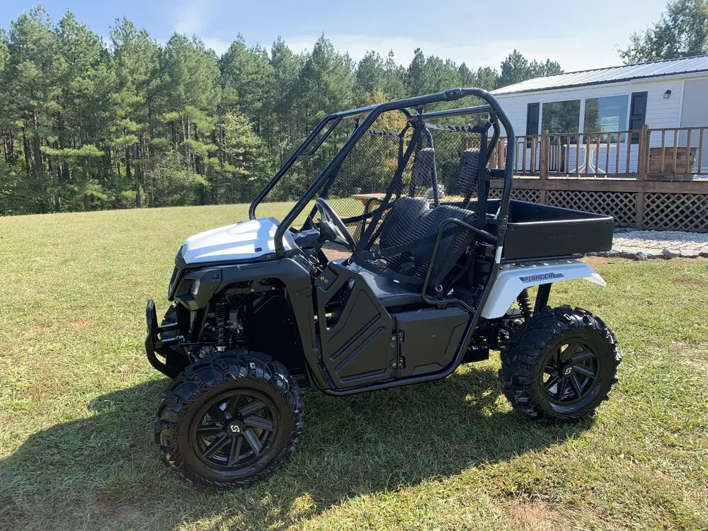

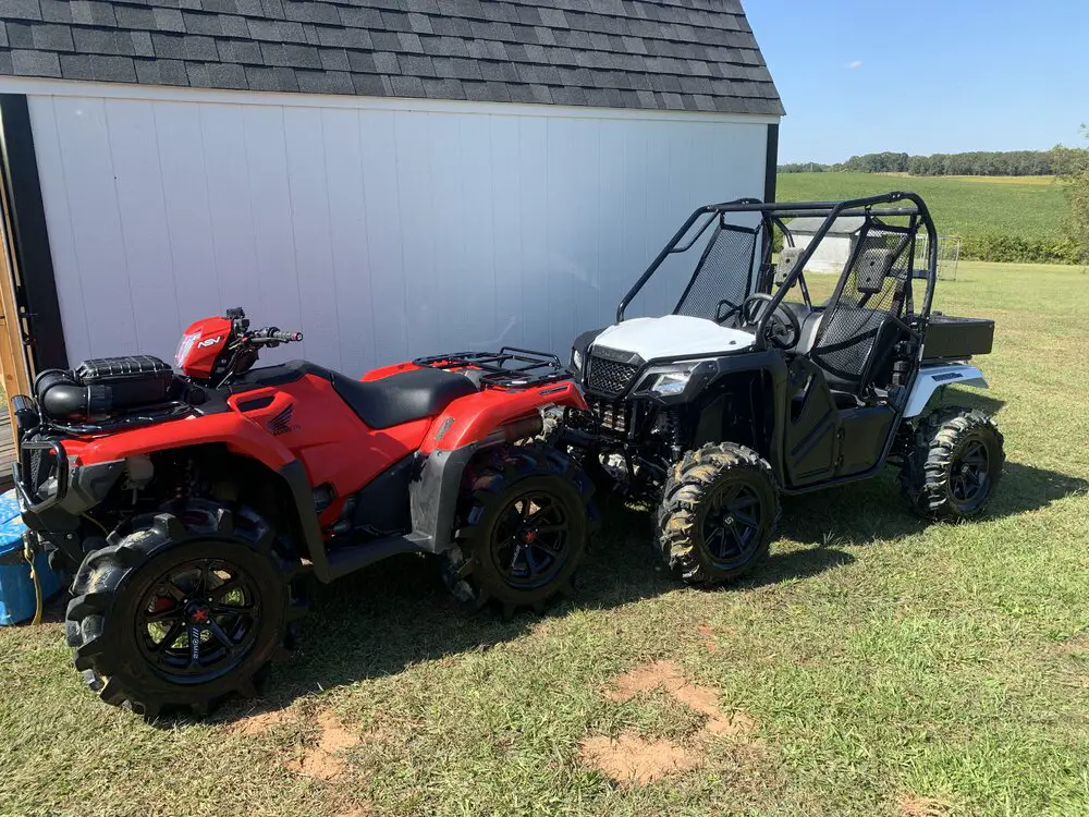

My wife’s 2020 is due for its first service. Plan on using a Honda filter and rotella t6 which I’ve been running in my 17 rubicon. Was looking for opinions. Is this oil okay to Use in her 500 as well?
