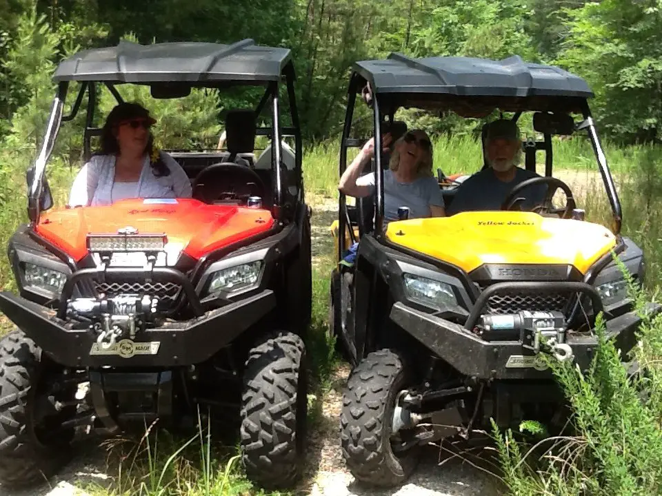

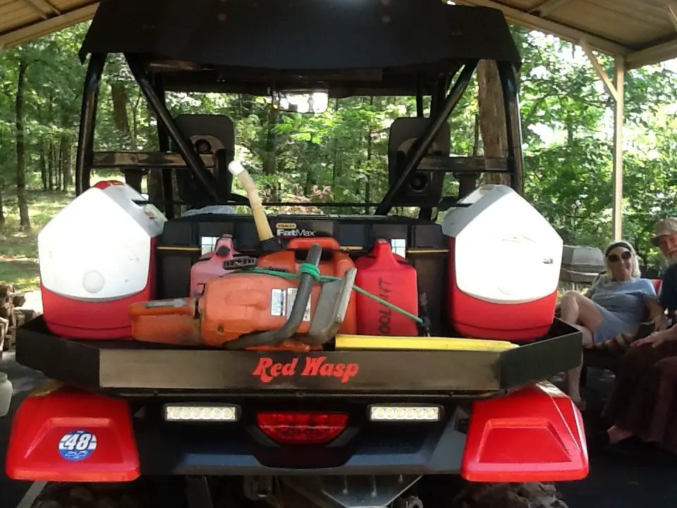

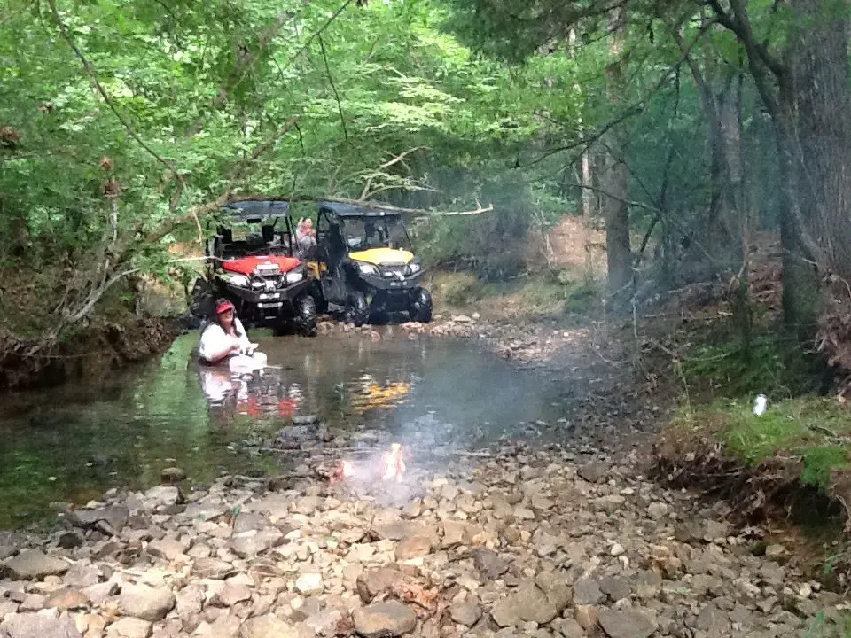

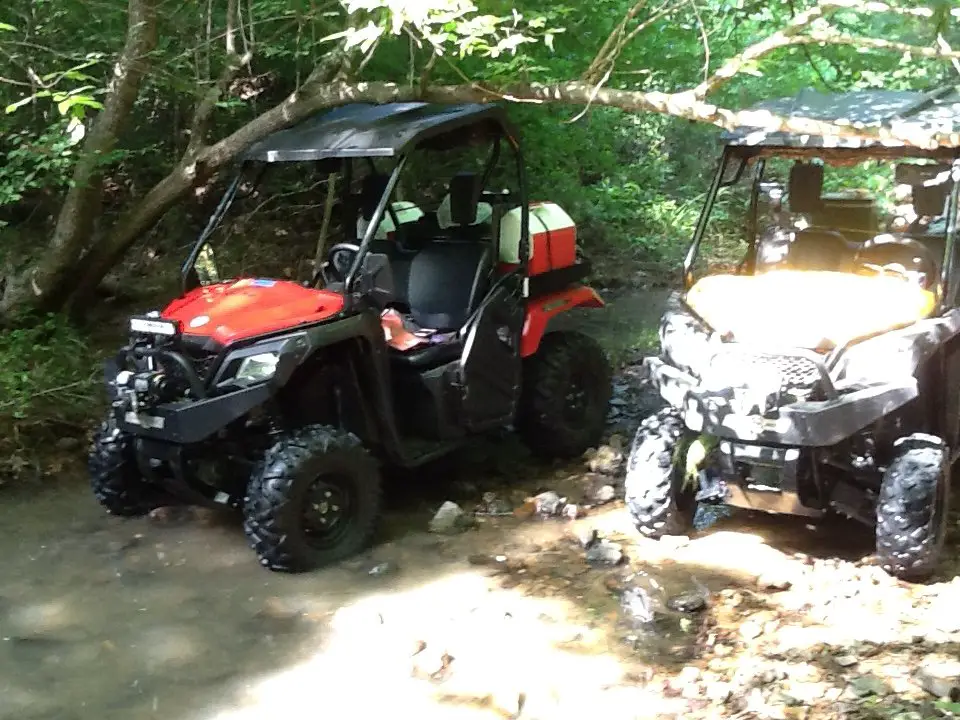

View attachment 17137 View attachment 17139 View attachment 17141 View attachment 17142 Haha. Ok so I disconnected my sway bar. Left the cabin for the 5 mile run to the NF. First a couple miles on gravel then rural asphalt road. No real discernible difference there. Didn't really feel the "drift" that some have mentioned. Once in the NF and on the abandoned logging roads (which are overgrown and rutted out to merely trails now) I began to feel the difference. It is as though the rear spring/shock assemblies are working independent so the ride feels more like (but not completely like) my PoPo, it seemed to float over the ruts and bumps and rocks. Mama noticed it right off.
In the 50 miles we did Saturday, I navigated through multiple off camber events, the kind that always lifted one wheel off the ground, but this time I kept my wheels on the ground. In one particular place we both were certain this was it, but it stayed upright, to both our surprise.
So, I still can't see why it has a sway bar, but for the time being, I'll leave it on but disconnected and wired up (yeah, the zip ties both broke) and continue to experiment with it before I'm certain enough to remove it altogether.
One other thing. Sunday's ride was to the Ouachita river where we finally found a piece of bank that we could negotiate down in and back out without winching. But running in the river, the Yellow Jacket had difficulties a couple times, and once, the Red Wasp had to winch him out. He said, "that's it, I've got to get new tires"! Oh, and on Saturdays ride, he clocked 50 miles while I clocked 45!!!! So, those of us with larger tires than stock are not accumulating accurate mileage. Oh, and I lost the pig tail off my receiver, the hook off my winch cable, and the scabbard off my chainsaw. :(
Any way, I have an overall positive review of the sway bar disconnect but will continue experimentation with it.
A few pics over the weekend.
