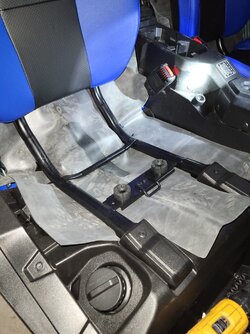

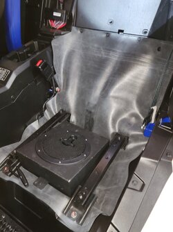

@Gohonda2 Picture when you install it please, and before you put the seats back in.
Here's a couple from @aprils_fool machine, one of them is before he reinstalled the seat. No permanent alterations needed and should work with the seat riser mod that many are doing.
Talon Shield 3Talon Shield 4
