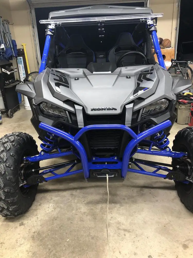

Hmf front bumper with warn vrx 45s I pulled off the pioneer before selling it
That's definitely the best color scheme, 2 seat or 4 seat. I figured with you being young, you would get a 4 seater so you could haul more b****es. Too bad I won't be there next weekend to watch you destroy it. It is definitely a sweet ride.
I would have went with 4 seat if they had it in an r model lol

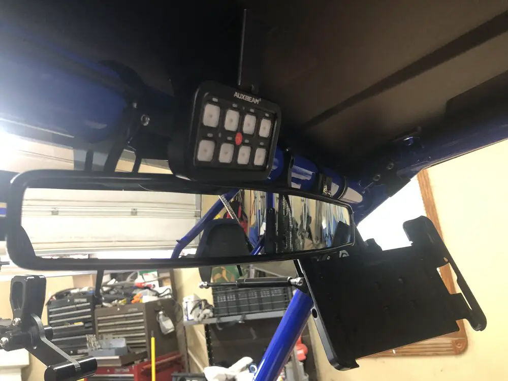

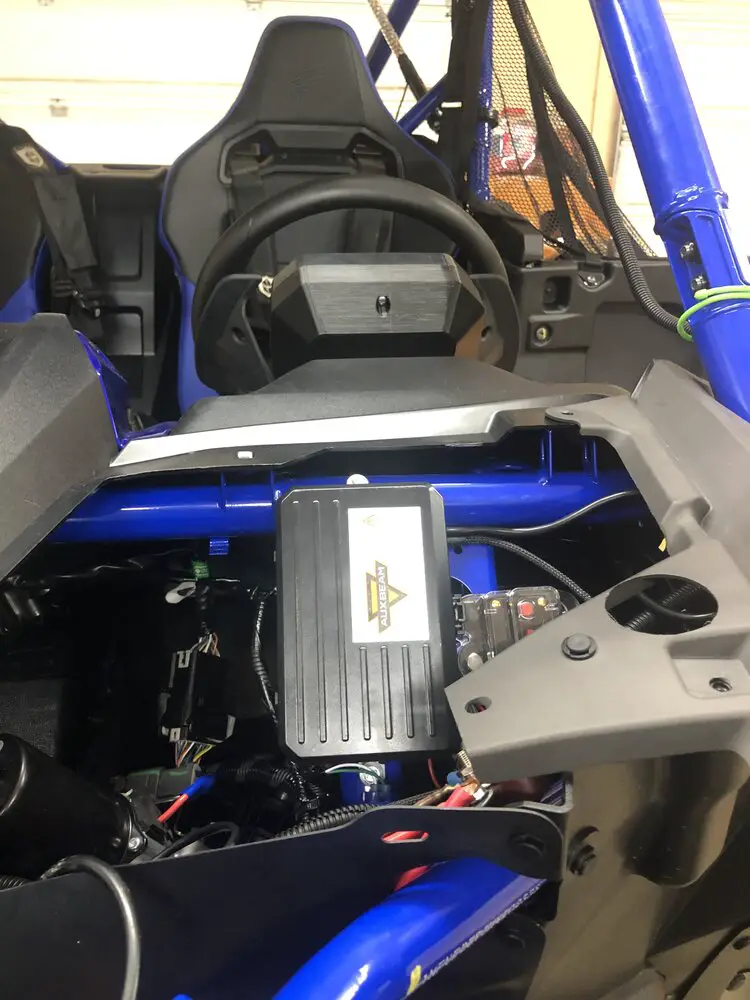

Got all my wiring ran through aux beam controller. Very simple and way easier then rocker switches to install accessories with this.

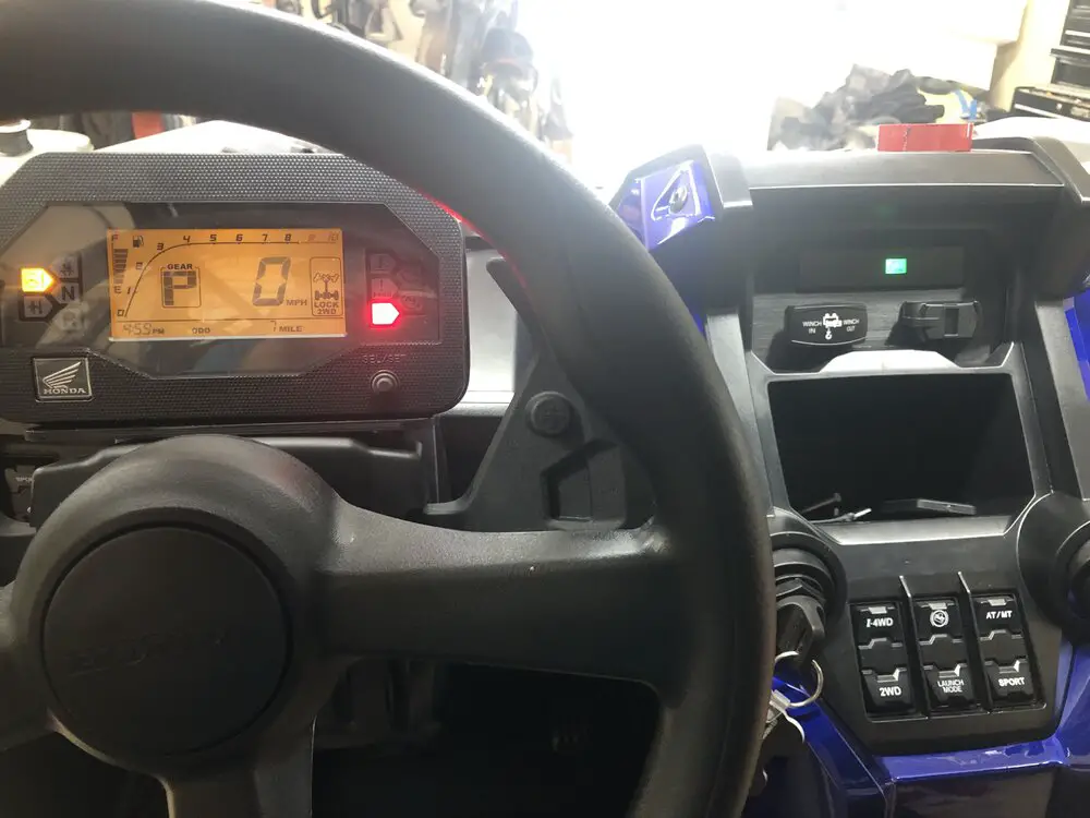

Went ahead and done @sspeederr gauge cluster relocate from . Much simpler then expected lol. Now have winch control where the cluster was.

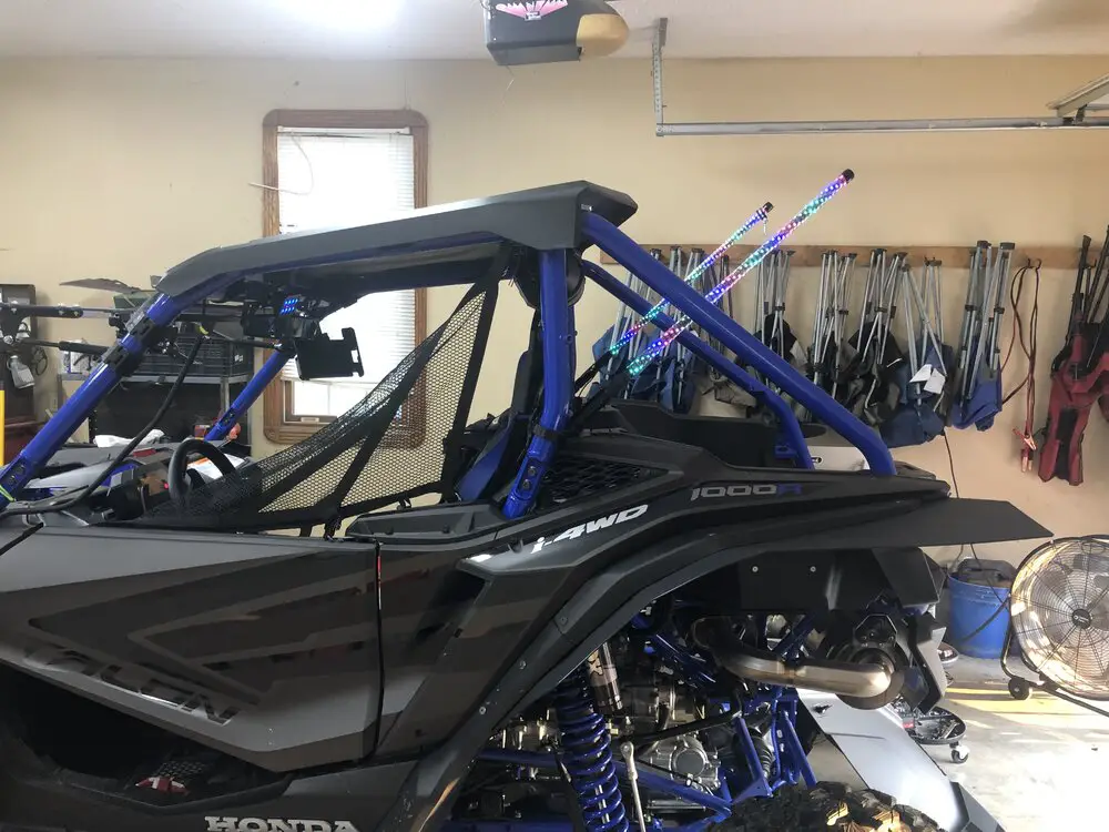

Went with whip lights from @Adam490 mounted with rb3 360 mounts

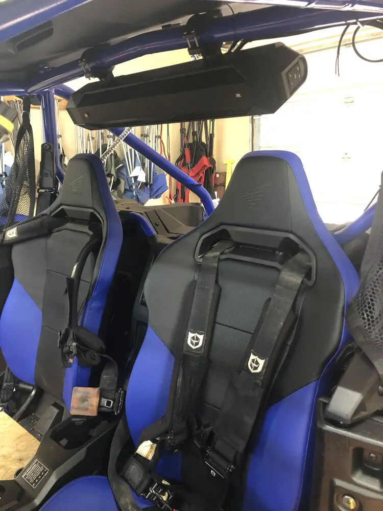

JBL sound bar
4 point harnesses out of the pioneer

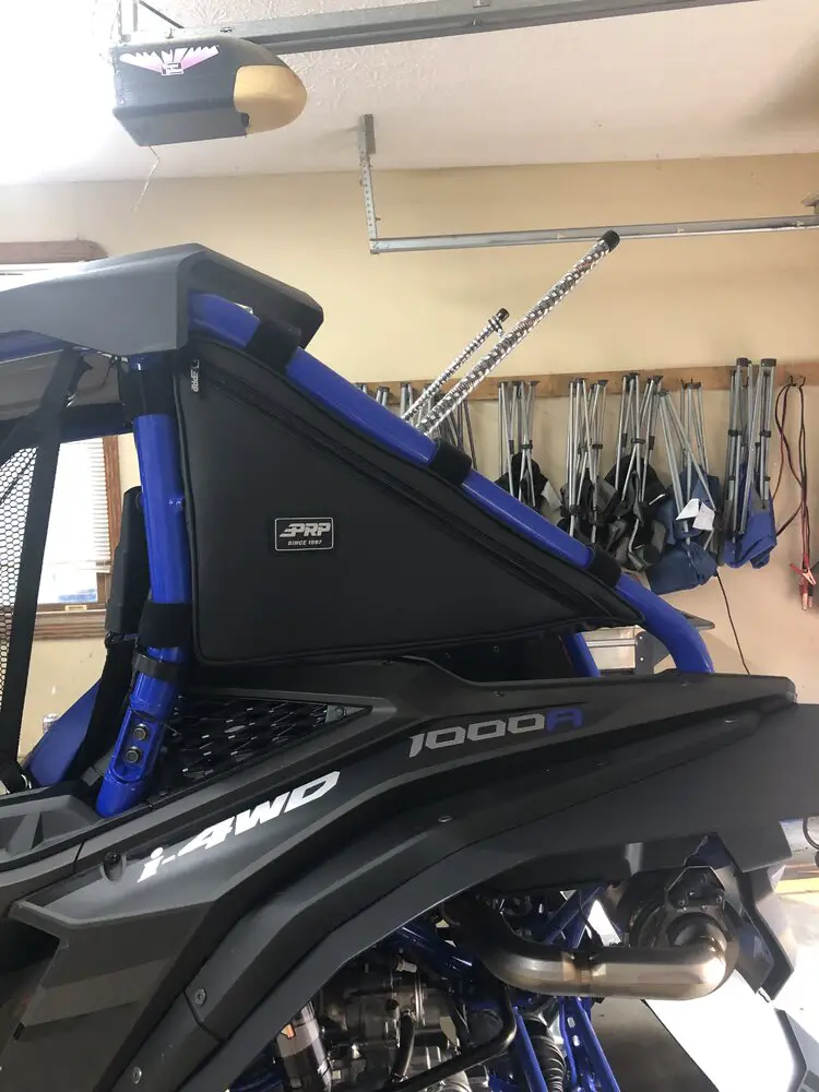

prp center storage and truss bags

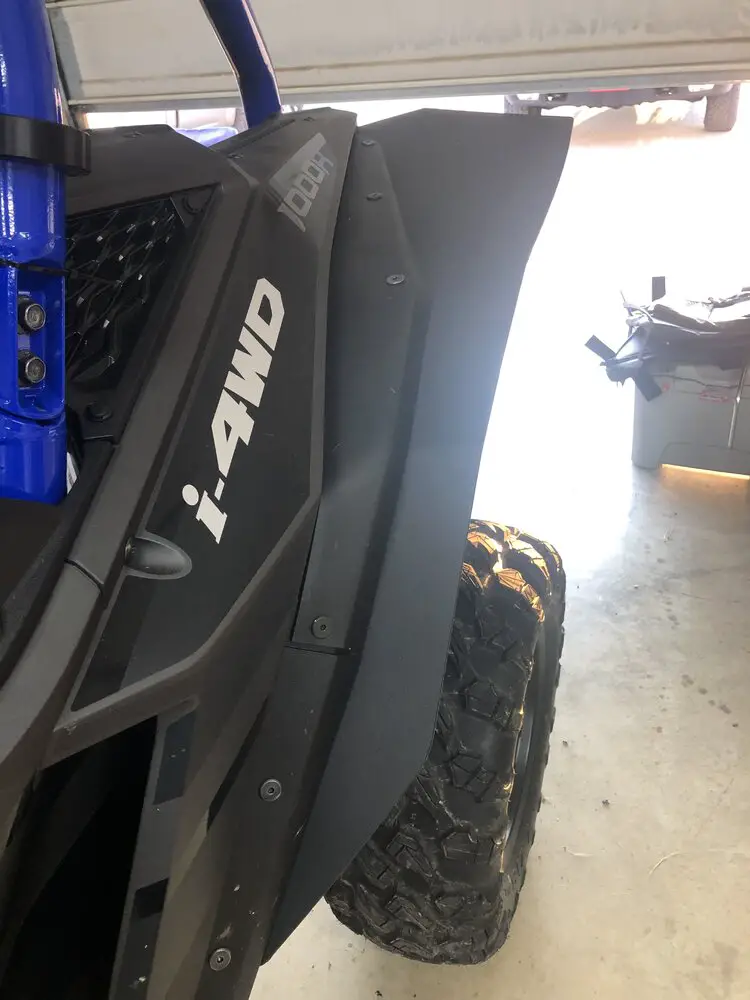

Mudbusters all the way around. Just realized I only took a picture of the rear

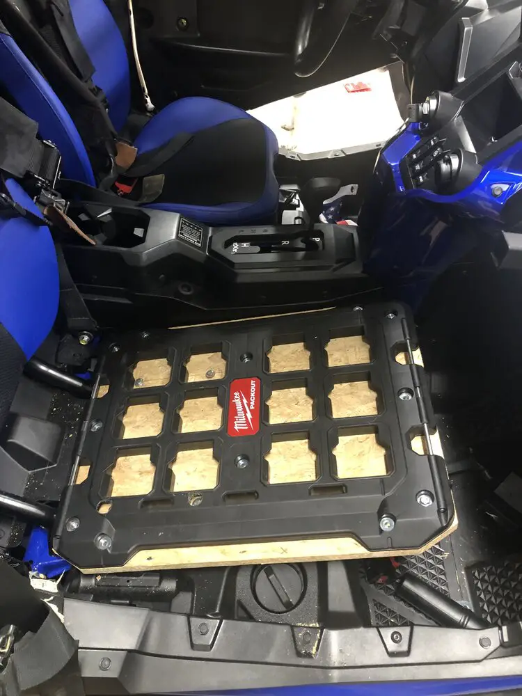

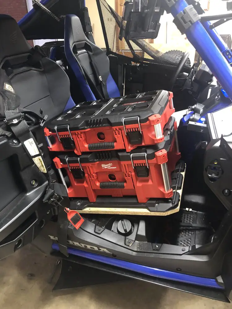

Made a Milwaukee packout box mount in the passenger seat for over landing adventures. Nutserts installed into seat frame and ply wood bolted down then the packout mount bolted to it. Had to take he grab handle out to make this fit but it seems like it should work great. I Will know in a few days

Got all my wiring ran through aux beam controller. Very simple and way easier then rocker switches to install accessories with this.View attachment 291171 View attachment 291172
Went ahead and done @sspeederr gauge cluster relocate from . Much simpler then expected lol. Now have winch control where the cluster was.View attachment 291173
Went with whip lights from @Adam490 mounted with rb3 360 mountsView attachment 291174
JBL sound bar
4 point harnesses out of the pioneerView attachment 291176prp center storage and truss bagsView attachment 291177
Mudbusters all the way around. Just realized I only took a picture of the rearView attachment 291178

Made a Milwaukee packout box mount in the passenger seat for over landing adventures. Nutserts installed into seat frame and ply wood bolted down then the packout mount bolted to it. Had to take he grab handle out to make this fit but it seems like it should work great. I Will know in a few days View attachment 291180View attachment 291181View attachment 291182
Nice job 👍
Is that particle board under the pack outs?

Small piece of advan tech I had laying around

Hopefully it holds up, I don't personally have a lot of experience using OSB for stuff like that. Ply wood might hold up better.....my 2 cents (not that you aske though) 😂
JBL sound bar

Looking good. Love the packout mounts in passenger seat. I would paint or seal the board under the packout mount.
