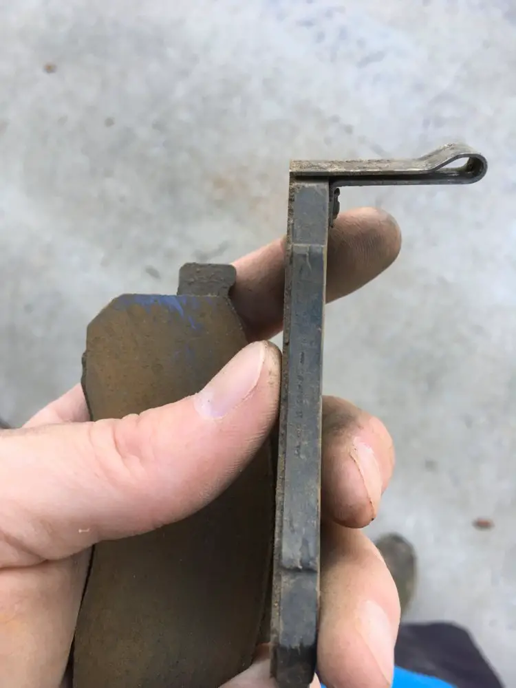

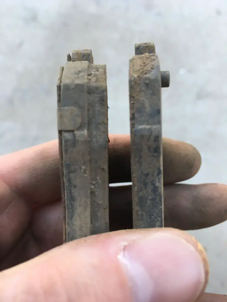

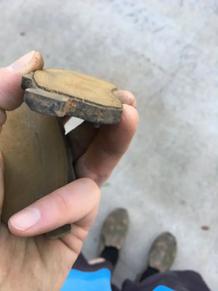

Just wondering what brand of front pads people are going with? Obviously the stock ones don't last too long and I want to go with something else. Here's mine at only 652 miles. I rarely use the brakes and always just downshift. My Polaris stock brakes lasted 2K for comparison. On a positive note these Honda rotors are twice as thick as the ones on my Polaris. I did a quick search and couldn't find any threads on what people are using for replacement. On a separate note the last picture are the pads off the drivers side. The side opposite the piston looks good, but the side with the piston is wore out. Is that normal? Thanks!

Oh, I see. You forgot to rotate your brake pads. Just kidding.
Seriously though, it looks like the slides and pins may need some grease. The caliper and pads need to be able to "float".
Just be careful and don't get any on the pads or rotor!

Haha, I knew I forgot something! But a little grease or anti seize probably wouldn't hurt. There wasn't any "free floating" going on in there. The back brake still had plenty of life left, not fun to get to though...
