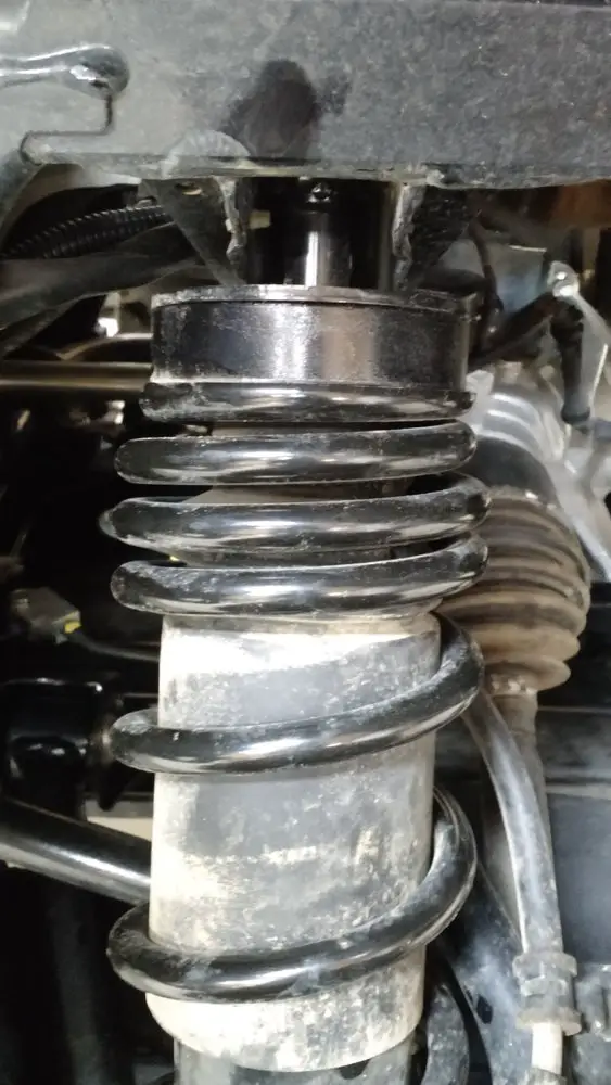

The rears take 3 in for the load level shocks on the 1000. I cut mine 3/4in thick on mine.
Sorry, this is for a buddy of mine who has a 700, looks like 2 inch on his. I have been thinking believe it or not, SS is very hard, wonder if contact with softer metal will wear into the shock. May need to go with black steel pipe????????????
I have seen people use pvc pipe....but i wouldnt recommend it. I used shc.40 steel pipe for mine.
PVC pipe? Sounds like something a plumber would do, HA! Would keep the unsprung weight down though. I used Elka Stage 5's spacers, HA!

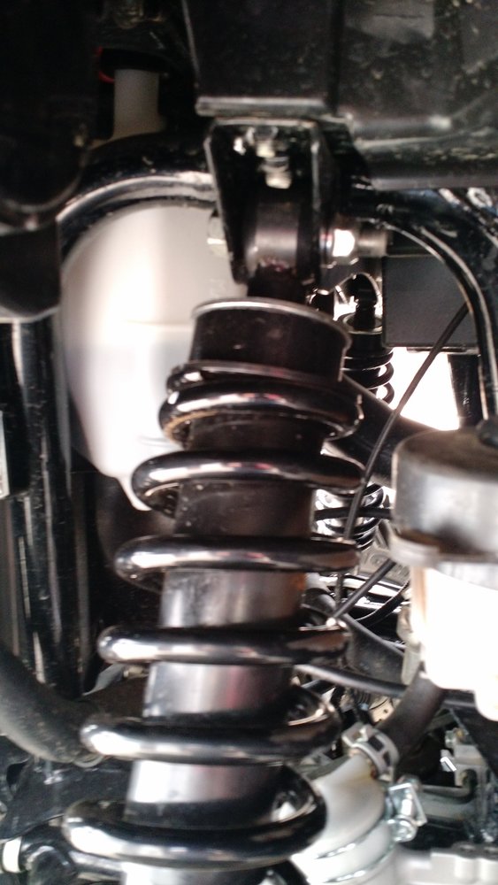

Will this work with the spacer on top of the spring? I think it will, but saw yours on the bottom.. just got me to thinking.

Mine are on top...
