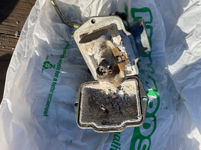

Here is a picture of our Honda xr80 carb that had ethanol gas in it and sat for a year without running it. Just ordered a new carb. And will use non ethanol gas in it from now on which is hard to find in the land of stinking.
It looks as though you had phase separation going on with your fuel: the ethanol in the fuel eventually absorbs enough water that the water/ethanol mix settles out of the fuel. (Could be contaminated fuel to start with, or the moisture can come through condensation in the tank or the fuel can from which you filled, or the ethanol can pull moisture out of the air.) That ethanol/water mix is corrosive.
If you are looking for E0 (ethanol free) gas in your area, try this site: Pure-gas.org - ethanol-free gasoline in the U.S. and Canada It's a user-updated site listing gas stations that sell E0 gas.
(Don't forget the hyphen in the URL. Leaving it out takes you to a scam site that tries to download some malware on your computer, claiming it is a security check.)
always more to the story - hard to understand if there was actually fuel in it since there is not fuel residue- looks like it was filled with water - a little vapor blasting, passage cleaning, rebuild kit and that carb will trickle fuel - lol
