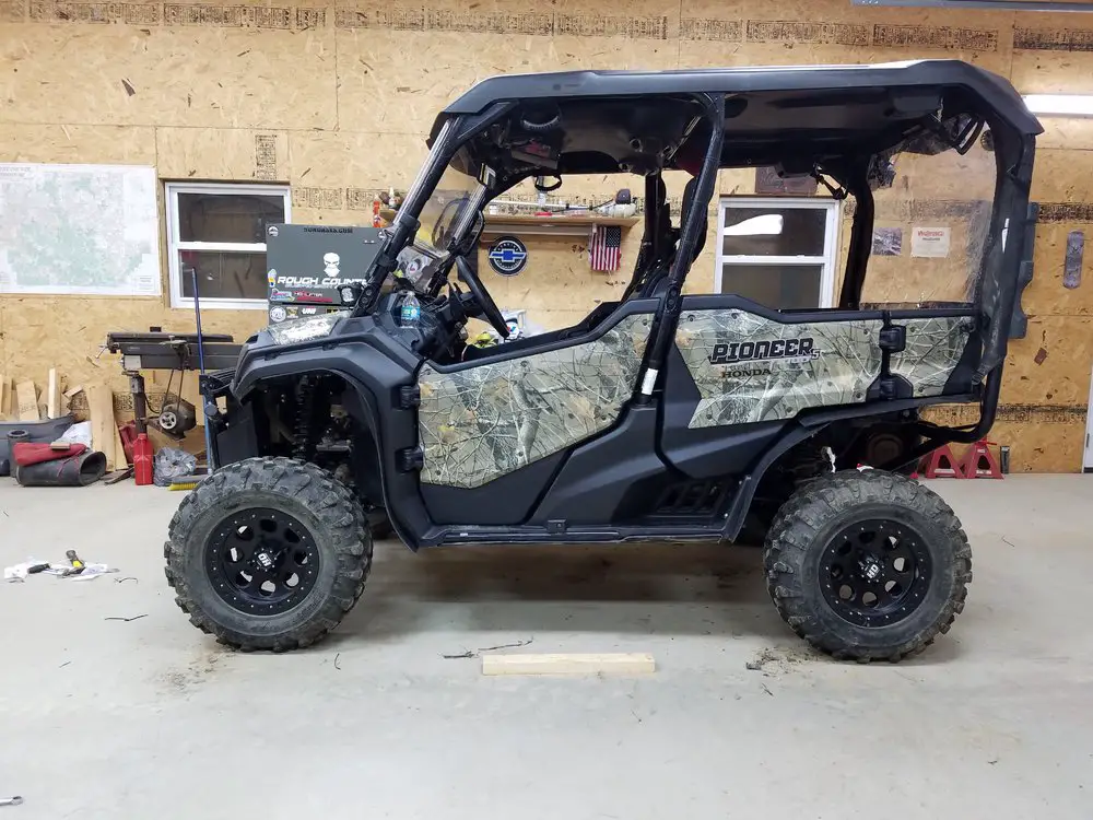

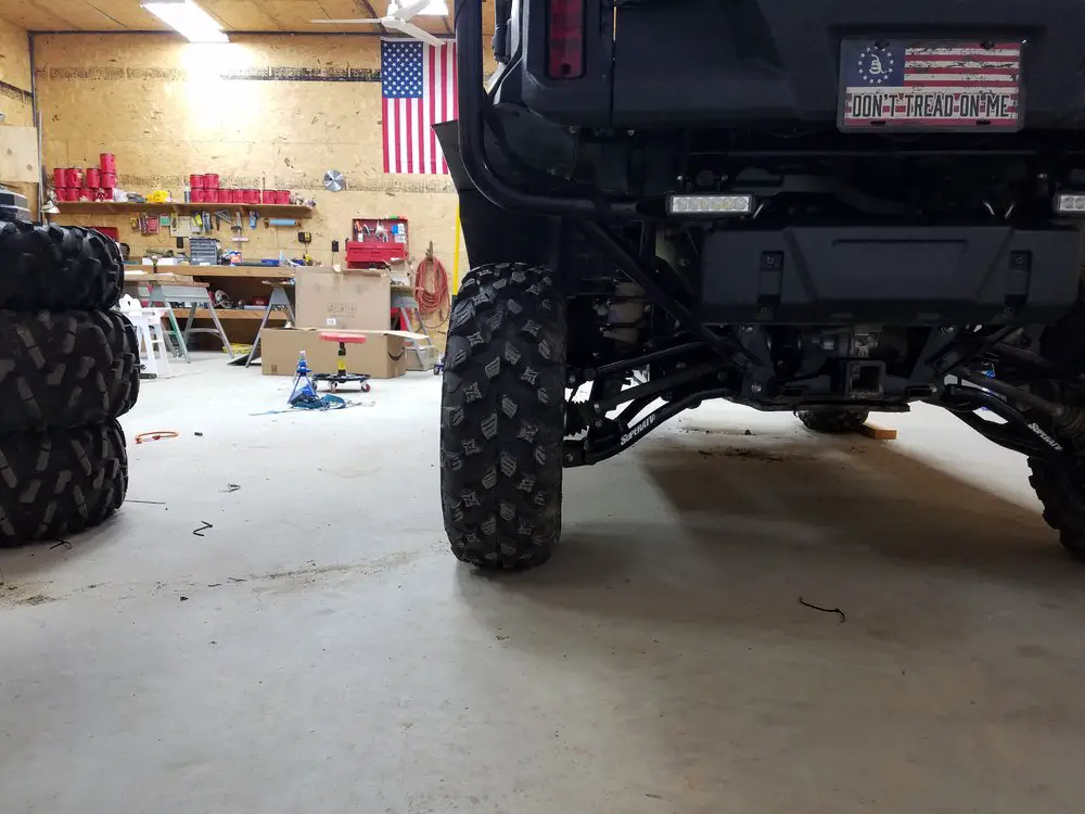

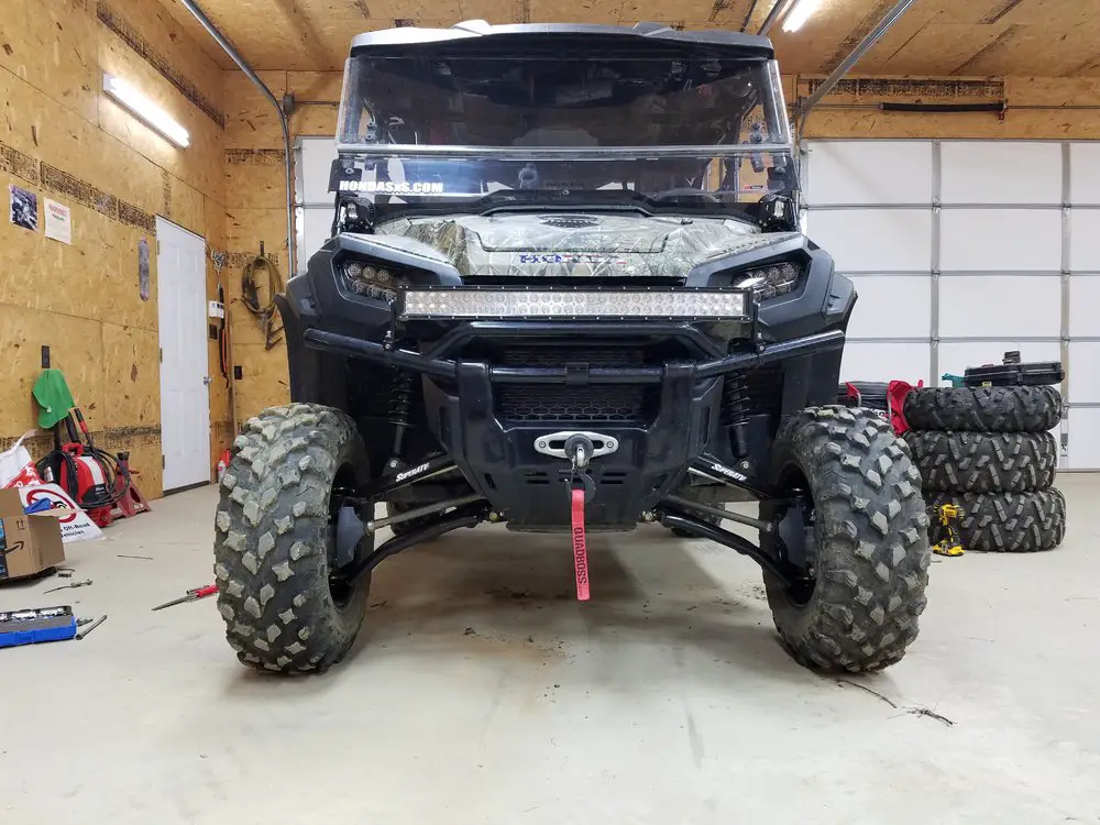

Front done...got to adjust toe. And do some adjustments on the rear...little to much negative camber. Overall pretty happy with it

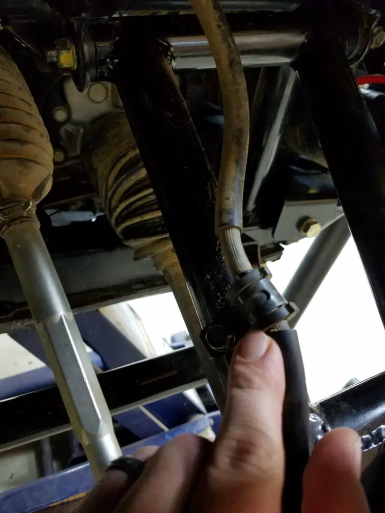

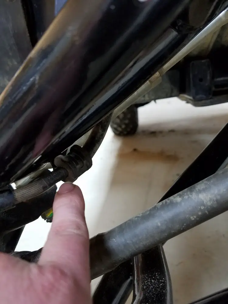

For anyone else doing this watch your brake lines. If you use your factory hardware there are two rubber buffers glued to the line. Take the bracket off and peel this buffer off so you can slide the brake line through it. Other wise at full lock even with the steering stops installed you could damage the brake line.

Thanks for this tip. My new balls (that’s a setup for JTW) came yesterday and I’ll be tackling this next week.

really helps good tip on the brake lines I didn't mention that in my post when I put my arms on can't remember been to long Haha
