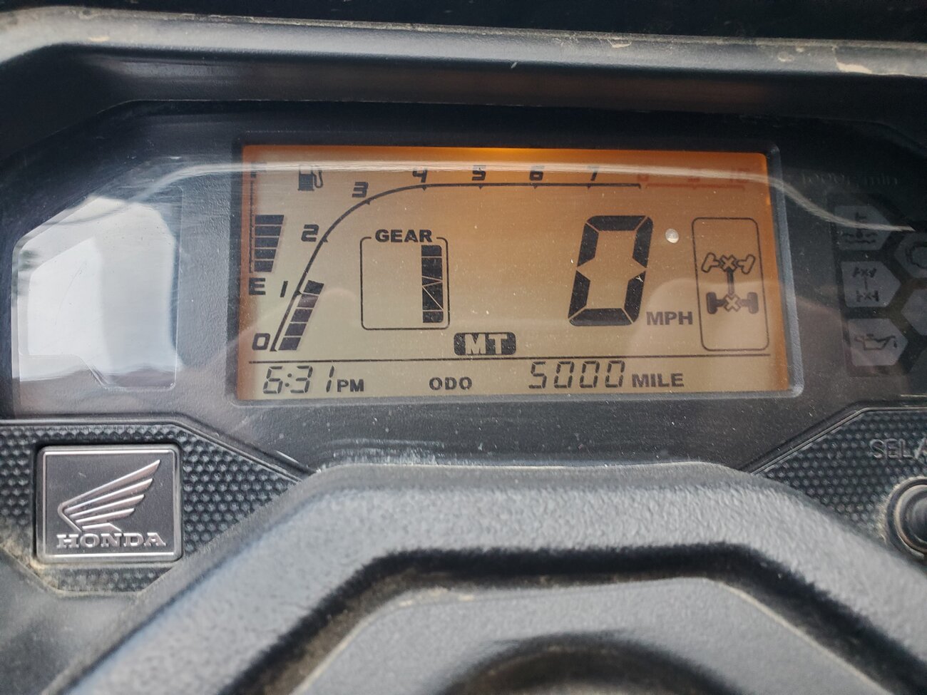

Hit a milestone today...

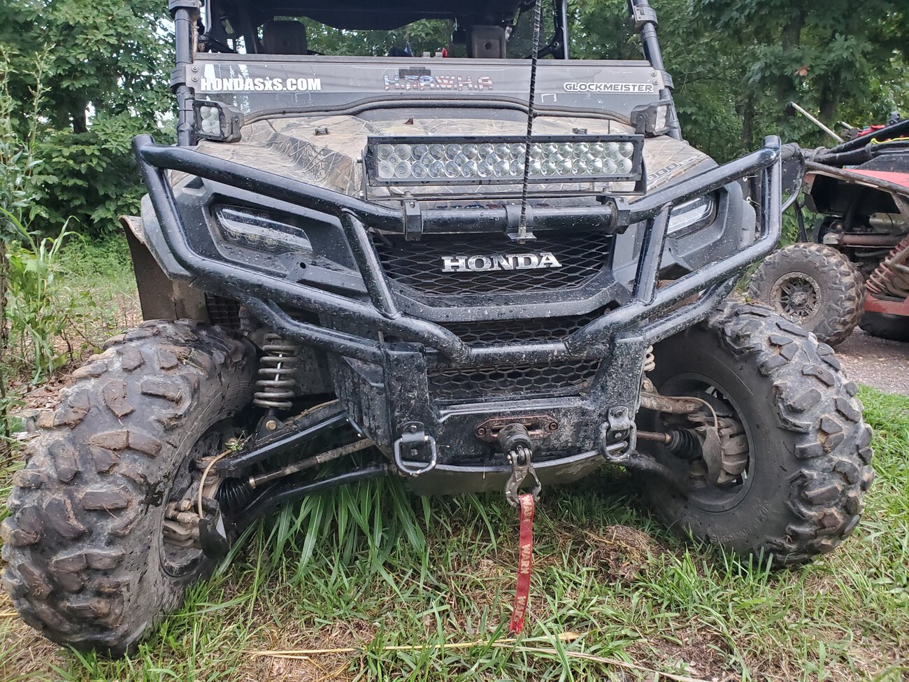

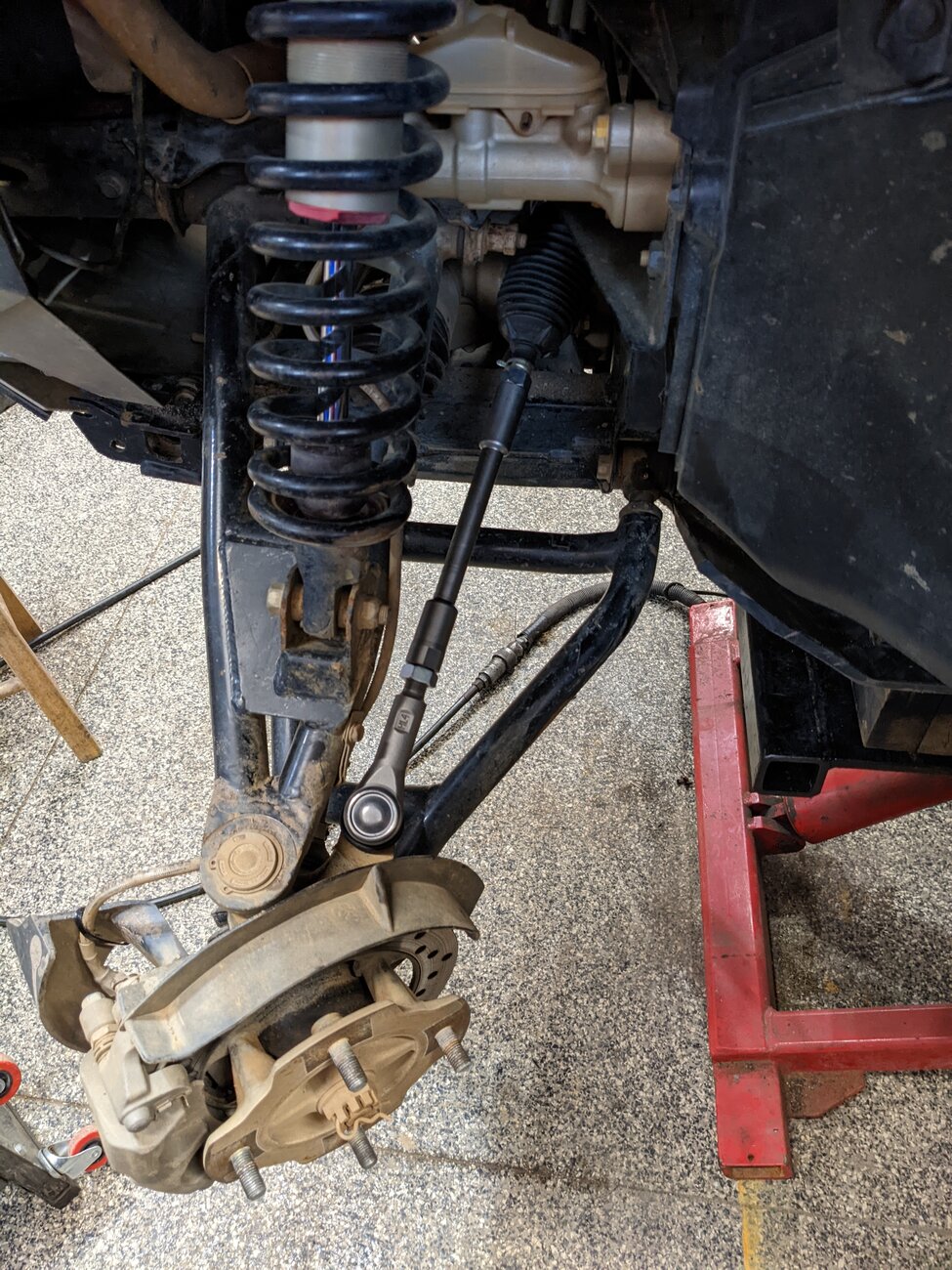

Then literally 2 miles later...then f***er breaks...upper a arm bolt...an upgraded 12.9 bolt at that!
20220820 191916
Was going about 30 mph...jerked me off the road and cut my brake line. Gonna have to call Jaks and get a new one.

Which nuts are you running with the 12.9 bolts? I've only broken the driver's side and I've only broken the bolt when the nut backs off. I'd recommend double nuts on bother upper control arm bolts and red locktite.

Nylon lock nuts...that could've been what happened but I honestly didn't look at it that hard.

You have weld washers on those too right? Glad you guys came out of that safe.
@Neohio had some of these kits made up for the 22 TO and I believe the Club store has them now, weld washers and bolts. The P1's need them.

So Todd called it...bolt wasnt broke. Nylock nut backed off. Not sure how or why...but it did. Got it back together and back home yesterday. Put on a new brake line and she'll be good as new. If u hadn't put gussets on the a arm tabs I'm pretty sure it would have ripped it off the frame.

Red Lock-tite, double nuts.
