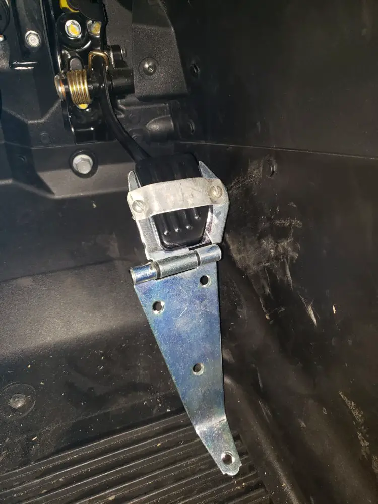

My throttle smoothed out after the first break in service, it was more sensitive than my pioneer, but I was also sort of used to it owning a pioneer for the last 3 years. I did cut a flat section into some solid round aluminum stock, 1” in diameter. Than drilled and screwed it to the floor board as a place to anchor my heel to the floor. It definitely helped when running the rig really hard and fast in low range. It stoped my foot from bouncing off the floor when I hit bumps. I’ll try to post pics

Beyond those things, the overly sensitive throttle tip-in Is a real deal and will take a learning curve to drive smoothly. First test fit into the toy-hauler was a nerve racking event with spinning wheels on the ramp and white knuckles on the wheel!

THE PIONEER 500 THROTTLEMAX WORKS PERFECTLY ON THE TALON ! I PULLED MINE OFF THE P5 AND PUT IT ON ! A FRIEND ORDERED A P5 ONE IN RED TO MATCH HER TALON .

I ALSO HAVE ANOTHER FRIEND WHO PUT A T H I C K PEACE OF FOAM RUBBER UNDER HER GAS PEDAL AND THAT SOLVED THE PROBLEM FOR FREE AS SHE ALREADY HAD THE FOAM SHE FOUND OUT ON A TRAIL .
