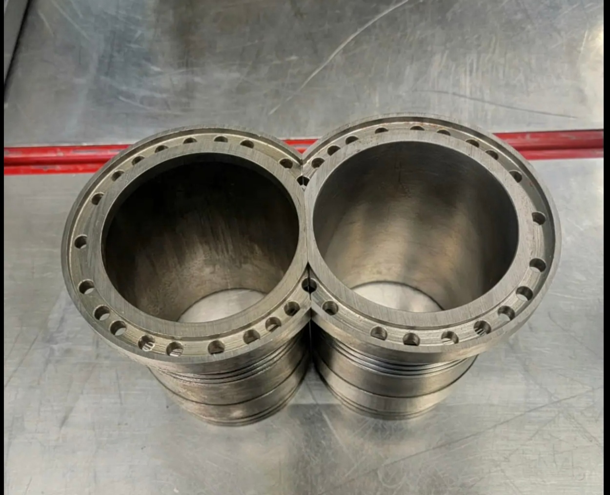

One thing he was wrong about is the cylinders being plated. They are not plated but do have extremely thin iron sleeves pressed into them that can't be bored oversize although some say they can be honed enough for .020 oversized pistons. Once you go past that dimension the block it no longer usable and needs to be replaced. There is a machine shop in Iowa that bores the old cylinders oversize and installs new sleeves that are much thicker than stock for less than half the cost of a new block. I'm literally about to ship them the block in my race car because I pulled a stupid and let the engine suck in a bunch of dirt. That guy sounded really dumb saying "they bored my motor out and put stock size pistons in it." If he had even the slightest clue he would have realized that what he is saying was false and would know that rhe engine wouldn't even run like that.... 🤪
All the turbo Talons I know of that are making big power (well over 250hp) with high boost reliably are using custom Darton sleeves that prevent the tops of the cylinder walls from breaking like his did.

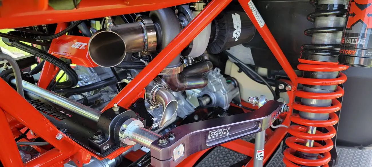

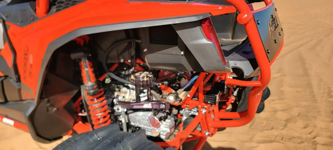

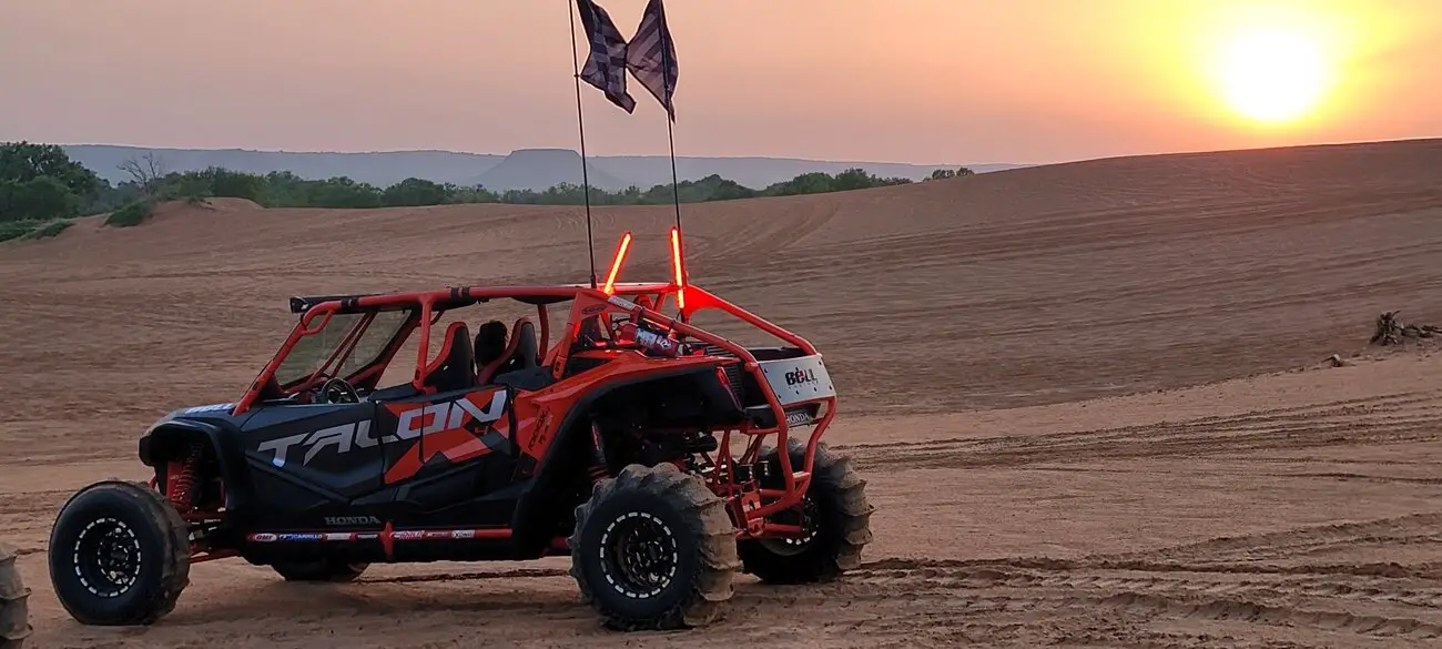

My engine guys turbo Talon makes big horsepower and has ZERO issues.......
I have 33k into mine how much into that?

Lots easier to buy a decent used motor, ship it off to have the Darton sleeves installed, and then build a fire breathing dragon. So much cheaper to ship it, than to haul it.
