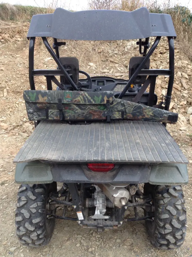

Here is mine. It is off an atv but I didn't use all the parts. It's nice.

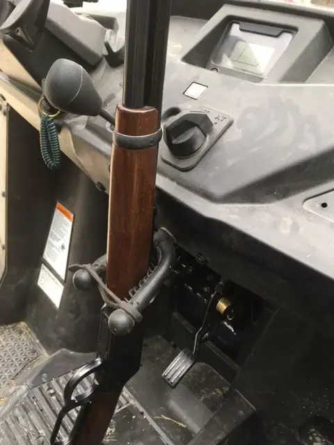

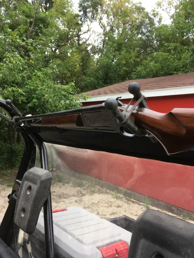

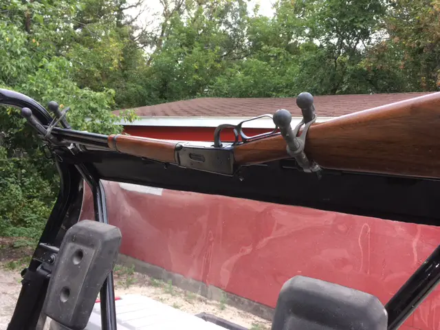

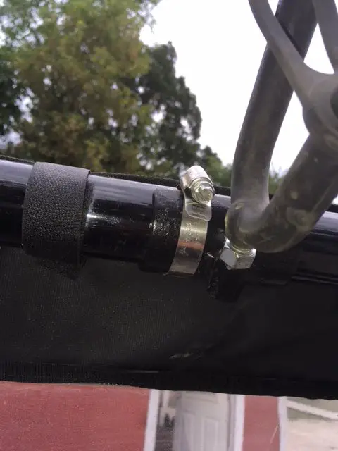

I just made this out of materials on hand. They are adjustable to fit any length/type of gun. I use a cloth gun "sock" to give dust protection and so it fits in the cradle. I'm sure there are guys out there with better ideas but this works well for me and feels good to be homemade. The dash mount works well too. It is secured through the dash with washers and nuts so it can pivot to vertical and give more knee clearance when not needed. The two clamps on the back bar are made of 3 inch long, 2 OD inch pipe cut vertically and secured with hose clamps. Easily adjusted. I'm 5'10" with a hunting cap. With the seat belt, I cannot bang my head on the gun or mount. About 5 inches of head clearance. No issue with a roof. Hope this helps...

What is the brand of that case and where did you find it? I saw another hunter using one but I have not been able to find it.
Mad dog is the brand,bought from cabelas closeout sale. Pretty much stole it for $30 5 years ago. Koplin has one for an atv that looks like it will work for a utv that costs$60 from cabelas.You might have to drill a hole in the mount and bolt down a rubber mat first to put it where u want it.

I guess Cabelas don't sell it anymore. I couldn't find it on their site. I think I would like it better than the Kolpin hard cases.

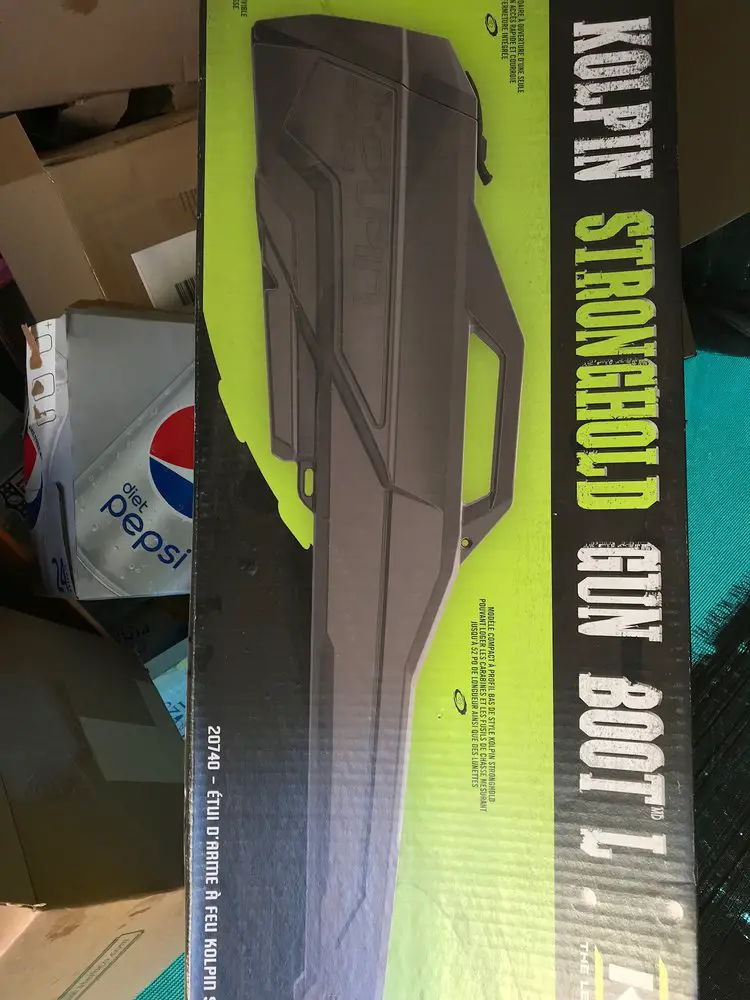

Took a pic of the Kolpin gun case box, it worked really well on the platform I made, it's easy to get to and complies with Colorado Laws.

Colorado laws??
Yeah, in Colorado while deer or elk hunting and you are riding in or driving a atv or utv the rifle(s) must be transported in a completely enclosed hard or soft case with no ammunition loaded in the magazine or chambers. And they enforce it pretty strictly. If you are in a motor vehicle the rifle doesn't have to be in any type case and can have ammo in the magazine.

What is the width of the thickest part of this boot? I asked Koplin a while back and they would only tell me what the whole unit would be with the brackets and everything. All I am wanting is the boot as my space is limited...so if it fits...I would make my own bracket for it.
