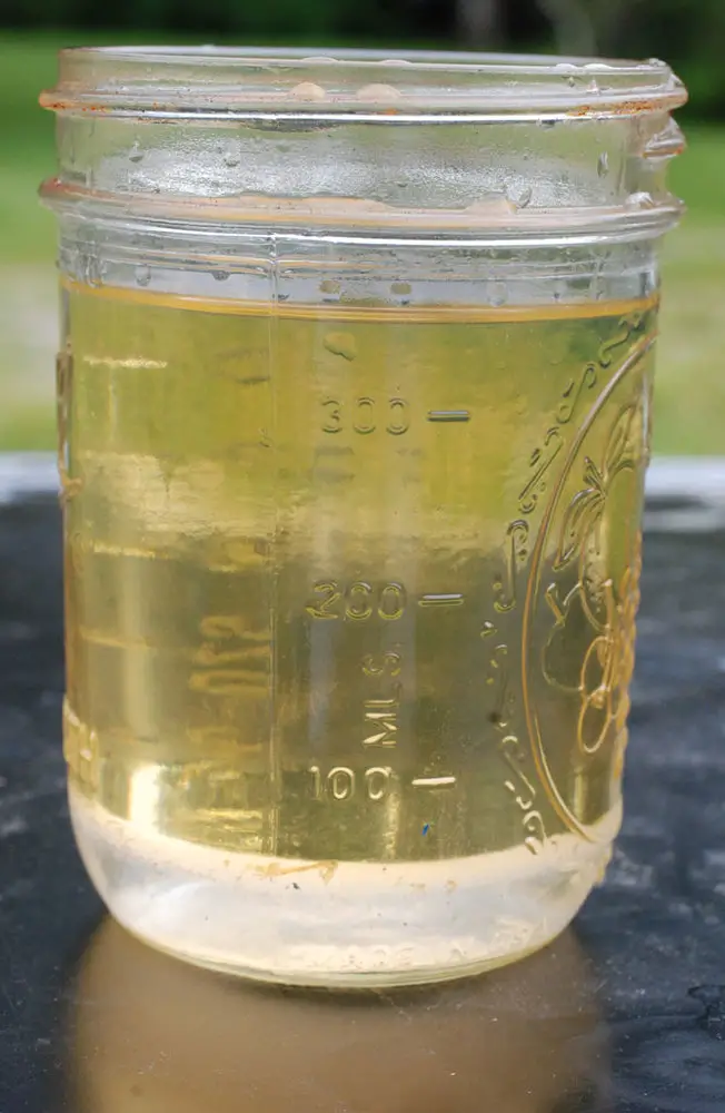

It's easy to see if there is water in your fuel. I do it with my boats every Spring. Siphon some of the fuel from of the bottom of the tank into a glass jar. The water will be on the bottom.
Siphon with something like this... not your mouth. ;)

gonna have to siphon the tank and look for water.....they make a paste you can apply to a dowl rod and probe the tank and it will change color if water is present.....If water is frozen in pump,Im not sure 45 will thaw it out...need topedo heater or somewhere warmer..JMO

Took a chance and went ahead and siphoned all the fuel out with a battery powered pump, it did have some water in it. I refilled it with 5 gallons of new gas and tried it, it took about 3 tries and it fired up. I let it run for about 10 minutes and then drove it a little, seems to be ok now. Gonna get some seafoam tomorrow and add to it. Idk if it was condensation or I got bad gas last time I filled it up but glad it's back running. Thanks for the replies!
