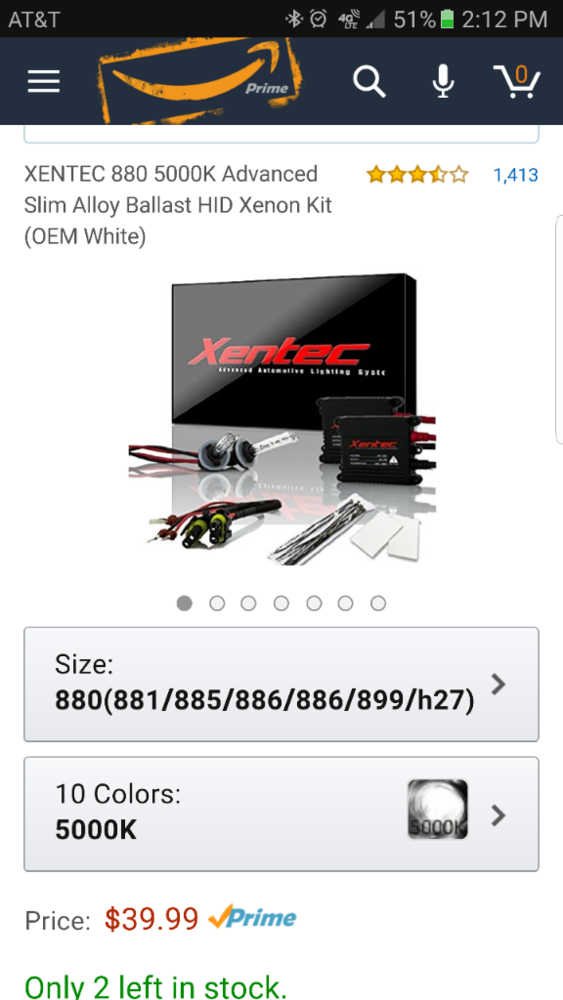

What brand did you get?

Screenshot 20161011 141251

I'm going to reorder the same thing again. Hopefully I just got a bad one. I was able to plug the oem connector into the connector. It just doesn't have the correct clip to hold in to place. I think it was tight enough to stay together

Just noticed the ones I got were 35 watts. I think I will get 55 watt next time. The 35s were pretty bright, bug you can never have too much lite!!!
