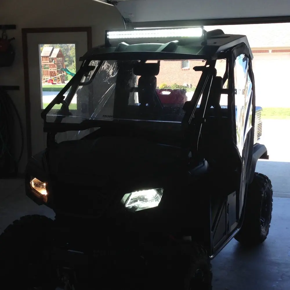

When I installed mine, the lights were pointing at the sky. I adjusted them down and I think the pattern is really good. It has a good cutoff so I don't believe I am blinding cars when going down the road. Between the HID's and the light bar, I have plenty of light. The headlights are aimed like a low beam, and the light bar is my high beam. The HID's project a bit further down the road than the light bar. It's a really good combination and I don't plan on changing a thing.

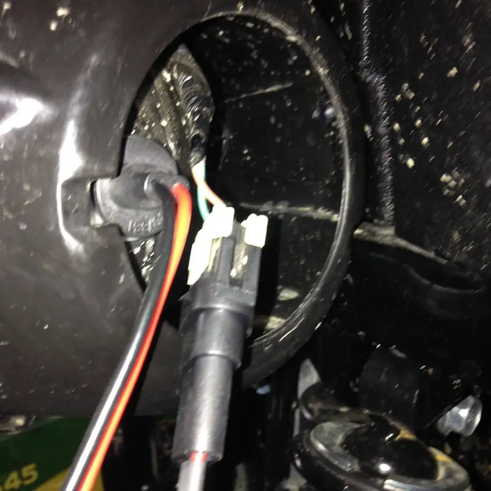

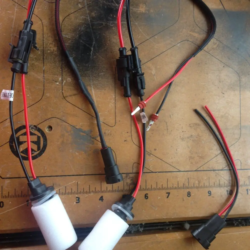

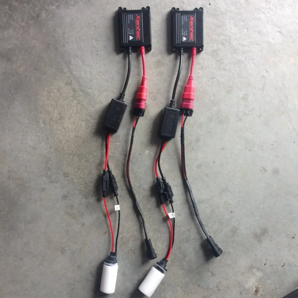

Just got the harnesses that I was waiting on to install. Here are a few pics. I wanted to be able to just connect up to the stock plug and not worry about it coming loose. I took the harness and soldered and heat shrink wrapped them all on. worked perfect and only cost $8 more. Most of the HID kits that I saw that were setup to fit were around $175 so a little work and did the same thing for $48.

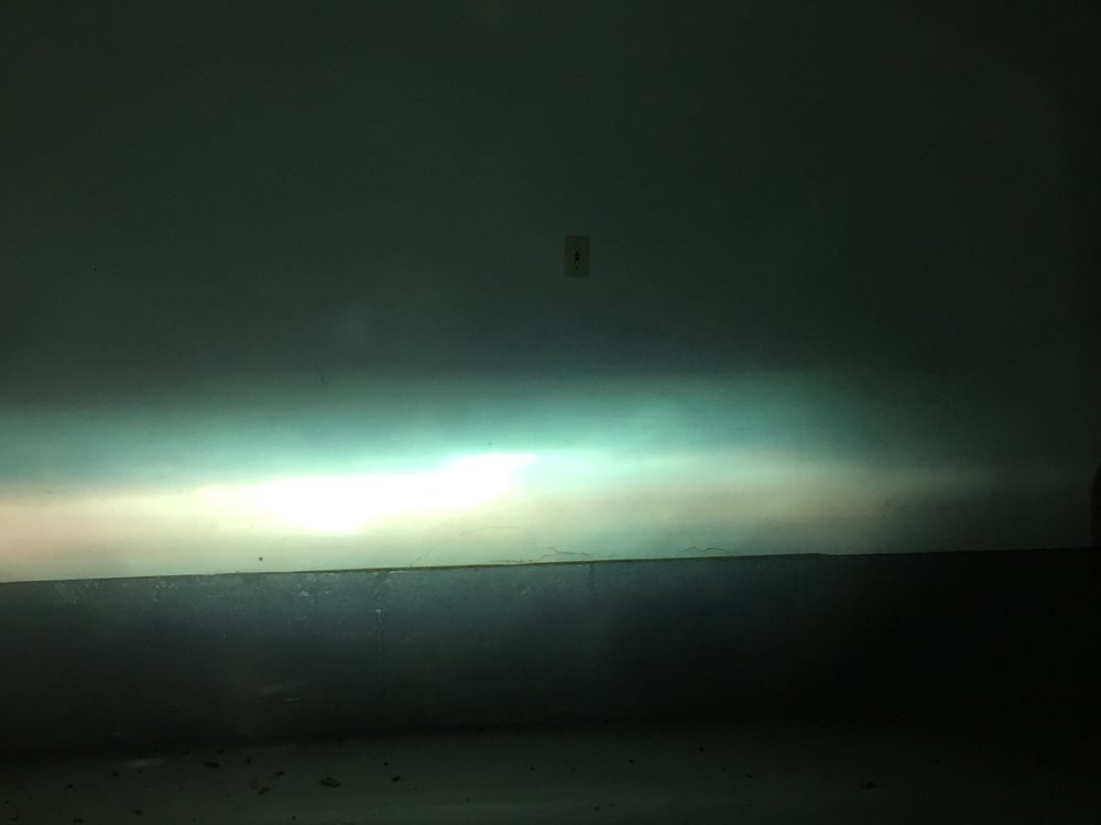

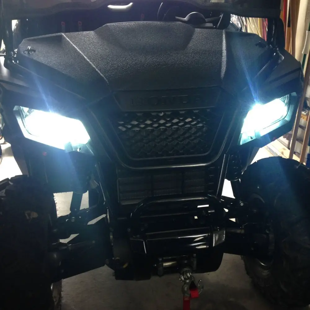

Here's a close up in the garage.. 10ft
IMG 0756
Reactions: Martin

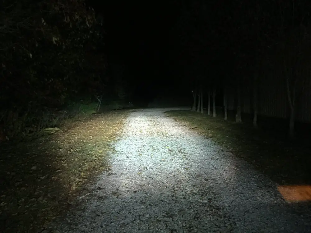

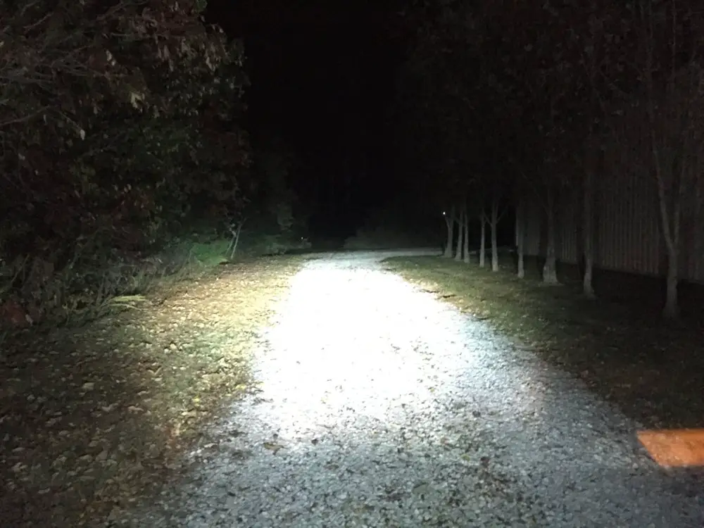

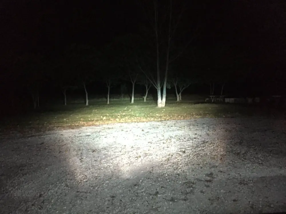

Here are a few more.. the first two are the same picture but different focus points on the iPhone.
IMG 0772 IMG 0771 IMG 0759
Reactions: Chooglin
No.. I don't have a light bar.. yet. That's just the HID headlights.
Where did you get the harness from and what is it called so I order the proper thing?
